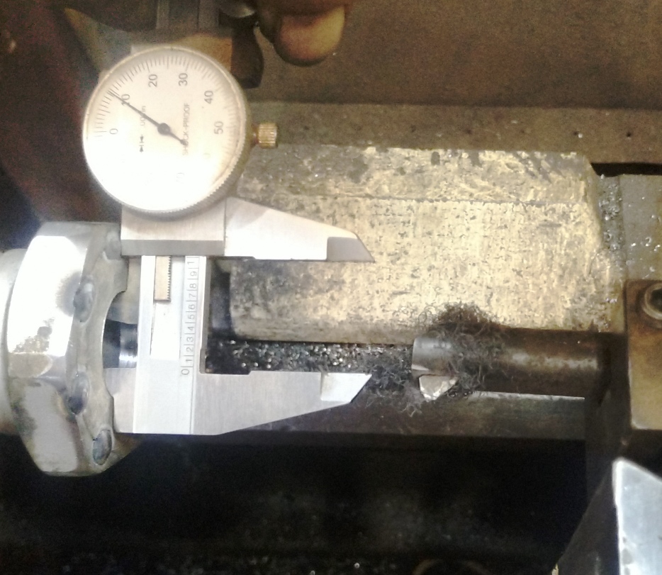

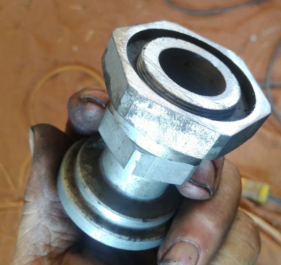

    I may have ordered the wrong wear sleeves as I needed some for a 1" diameter rod the ones that came in had a 0.970" ID by 3/32" thick and 1/2" tall. Which actually would have otherwise been correct had I needed bushings for a 1 3/16"+/- 0.003" diameter cylinder bore fitted in a 0.985" diameter piston grove. However the rod I have is 1.003" and I needed these sleeve bearing to slide freely on it As I had not already made the bore where the sleeve would be installed there was only 1 problem the bore. To solve this I made another lantern chuck one with a good snug fit for the OD to allow me to relax the bore diameter slightly
    So a new old stock reusable hose end seemed the logical choice to make the holder out of there is what I did
    I selected the size fitting I would use

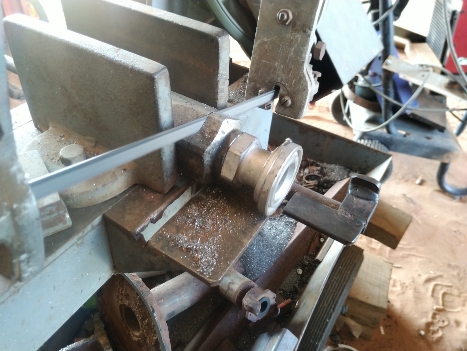

    then in the band saw I cut away much of the excess
    leaving this

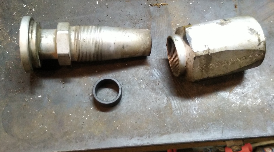

    After cleaning up the ends boring to size and tack welding a washer in the end of the nut this is what I had
    After boring the washer to 1.010"

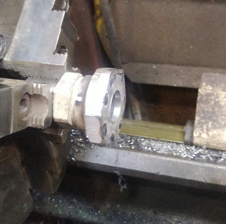

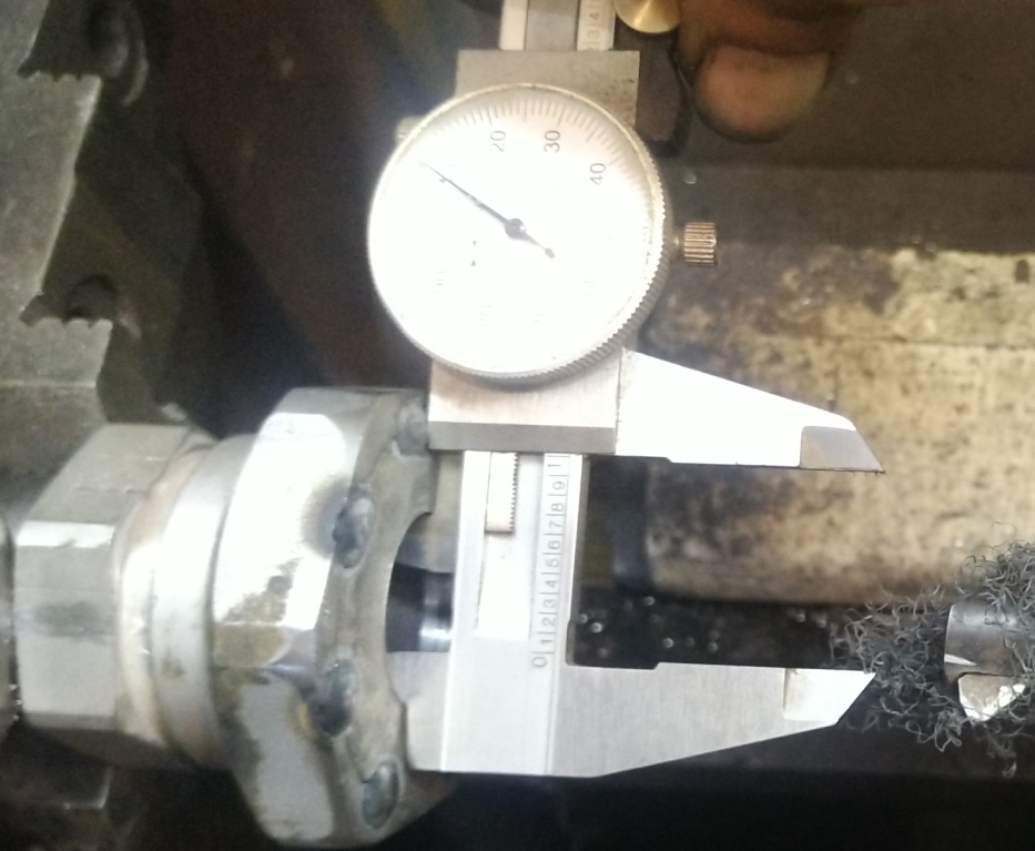

    I clamped the sleeve bearing inside and bored that to 1.0095 or close enough for checking with a dial caliper

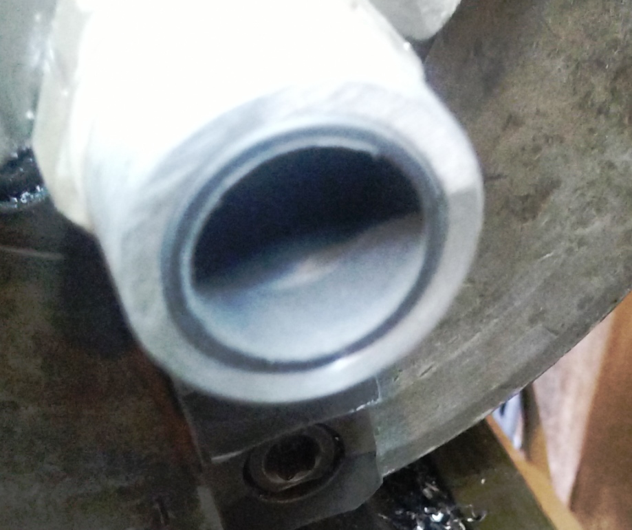

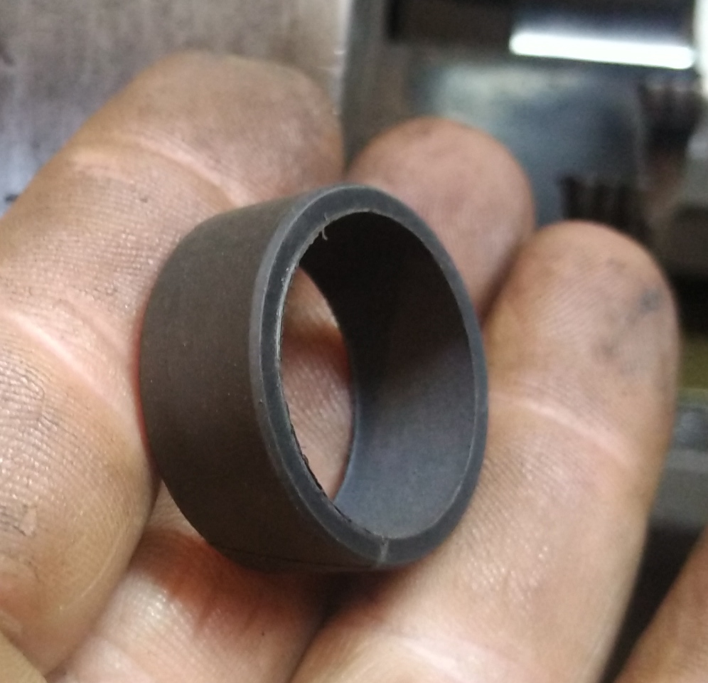

    Just a little debur needed now
