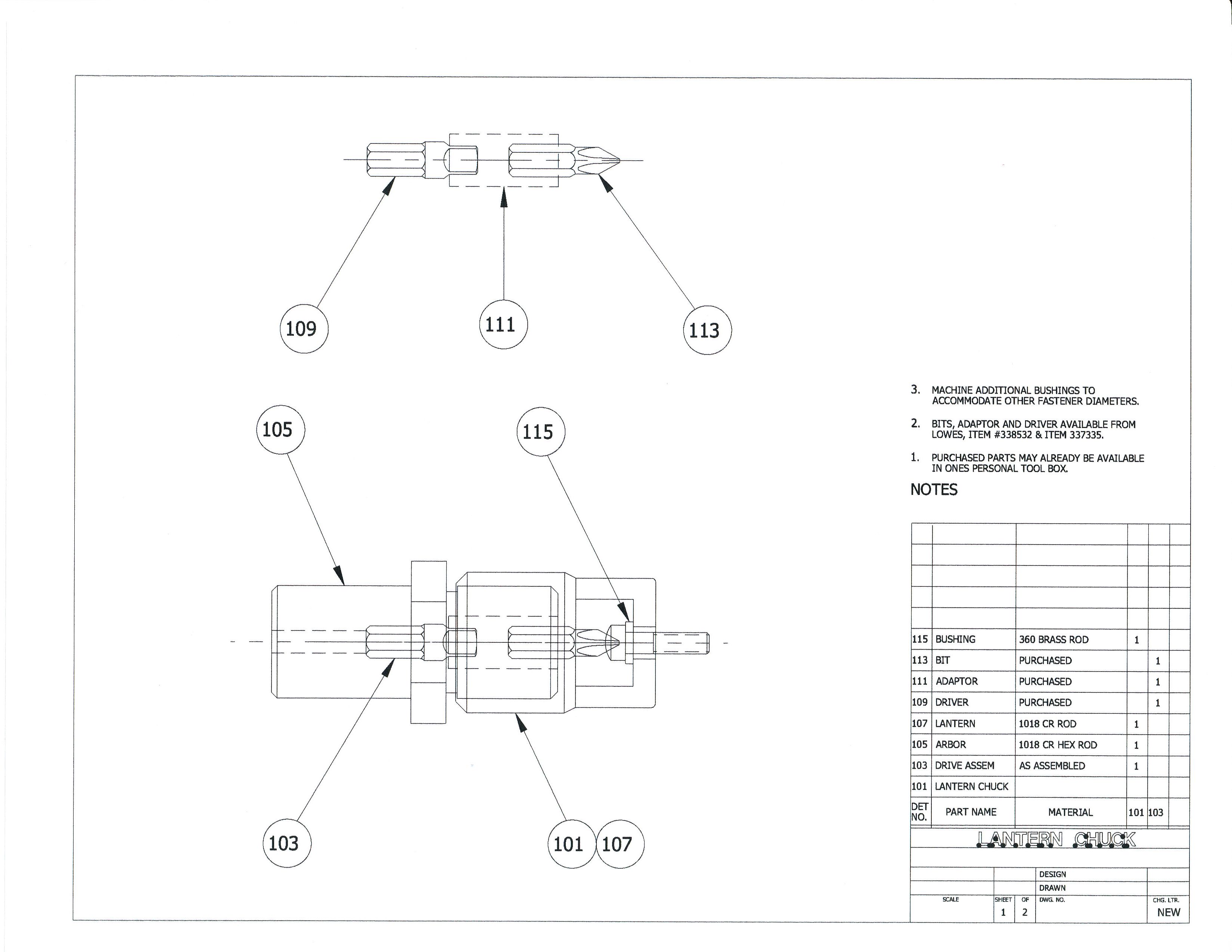

    Christophe,
    Your proposal sounds great and it would appear that you work in both metal and wood-working disciplines. Based on what I believe you are proposing it would only require machine/fabricating an arbor with the proper wood screw thread profile to hold the wooden stock.
    The Lantern Chuck is probably most useful in the model and clock making environment where the fasteners can be exposed and impact the general appearance of the project.
    This device for general hobby use provides the ability to modify fastener length as well as the point, flat, dog, cup, cone, etc. Much nicer finish that the crude method I’m sure we have all employed in the past with the added benefit of getting exactly what you need for your project.

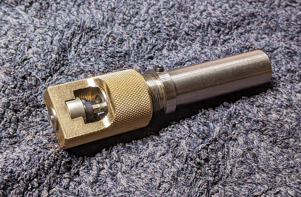

    What holds the 1/4 socket in the main body is it a set screw or you could silver solder it in. The tool looks top notch you can always have the length you need.

    I have attached a PDF that should give you a better perspective on how this tool was laid-out. If I can be of additional help, please don't hesitate to ask.Lantern Chuck-lantern-chuck-crop.jpg

    nextofkin,
    Sorry about the poor quality of the attachment. Exported as PDF but the forum doesn't accept PDF for upload. Scanned PDF to jpeg and then attached it to my post. Didn't come out very good.

    Thanks for the print, I plan to make one (don't know when) but I will change it some and just use a 1/4" socket, Thanks Again.

    Quote Originally Posted by nextofkin View Post
    A 1/4 inch socket press fit into the main shank sounds like a good idea. Would there be (were there?) any issues with the chrome on the socket affecting the fit?

    Hello Karl,
    So far I have had no problems with the chrome on affecting the fit of the socket. Didn't experience any flaking or peeling during or after installation. I used a 3 ton arbor press for installation. It should be a tight fit. If I can be of any further help, just ask.

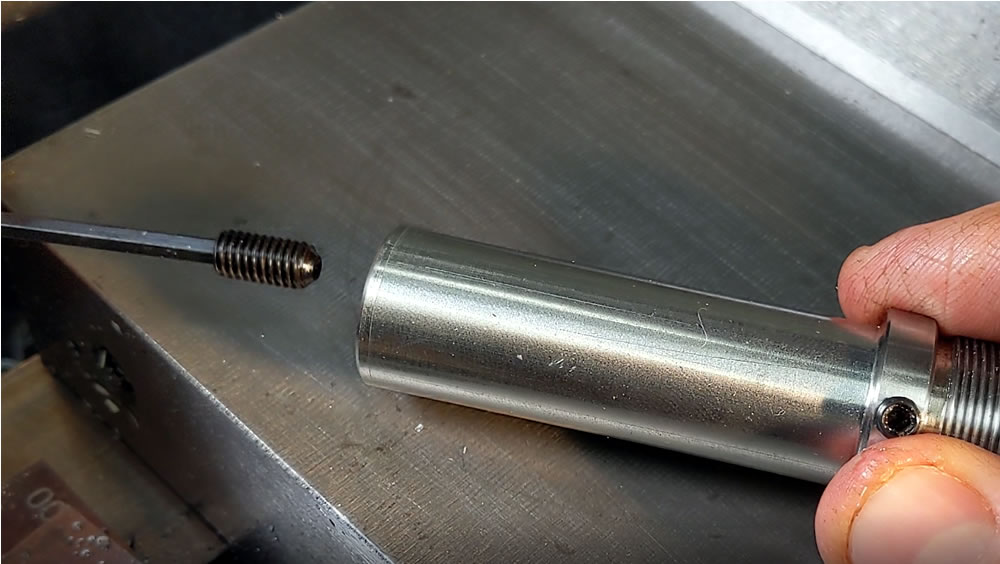

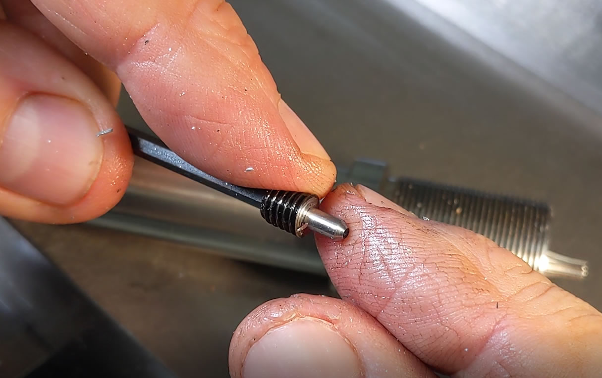

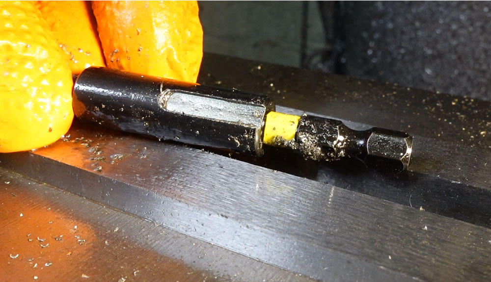

    Thanks very much for the inspiration, I needed a tool to machine some domed and polished ends on 5 to 8 mm stainless capscrews and the solution with the hex holder was perfect. I used a black-finished hex socket and milled a groove in the side, locking it with a dog-point setscrew against rotation and another setscrew and lockscrew in the rear of the shank so the position of the socket can be adjusted and locked. The lockscrew is a standard setscrew with the end turned into a cylinder so it fits into the hex socket of the main setscrew.
    Lantern Chuck-lantern_chuck.jpg Lantern Chuck-lantern_chuck_socket.jpg Lantern Chuck-lantern_chuck_setscrew.jpg Lantern Chuck-lantern_chuck_lockscrew2.jpg
    I posted a video of the build on my YT channel MachiningandMicrowaves:
    Neil
