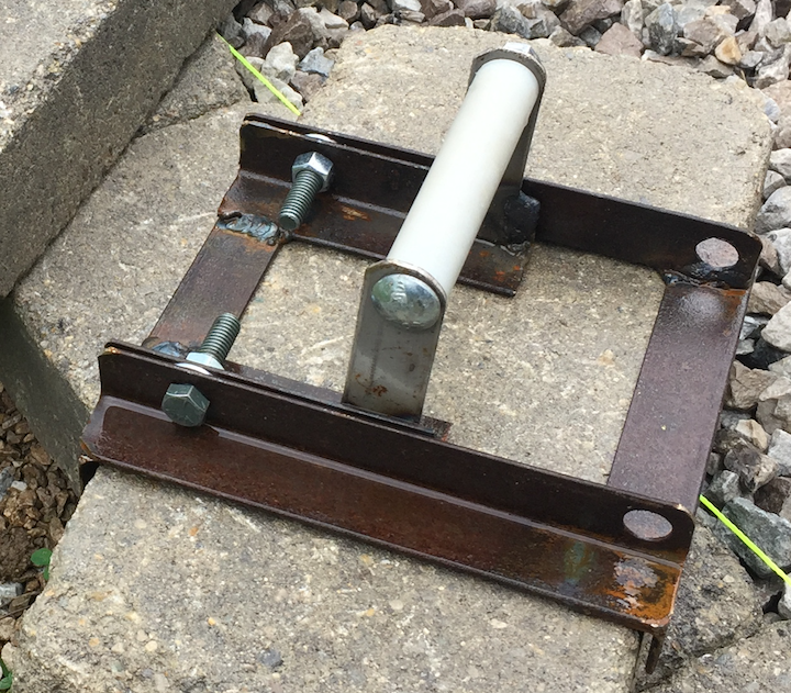

    I find myself building a patio with 3 1/2 x 7 x 14" concrete "stones" for an edge. They weight about 28 lb with no good way for my old hands to grip them . I have regular brick tongs that can carry them, but they grip on the ends. I need to grip them on the sides to set them.

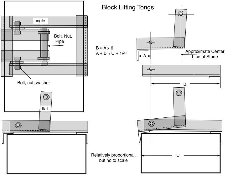

    Using materials from my "may be useful someday" bin, I was able made a simple tool to grip the sides of the blocks. Now I can pick them up and set them with one hand. I have no dimensions for it. Yours would be different anyway since I put mine together with what I had around.
    Below is a photo and simple drawings for your imagination.
    Photo Landscape Block Tongs-block-tong.png Drawing Landscape Block Tongs-block-tong-sketch.png

    Perfecto!
    None of that 'Incredible invention you have to see and duplicate' nonsense.
    Just here's why I did what I did.
    "...simple drawings for your imagination." Along with the YMMV statement, phrased like a true mentor.
