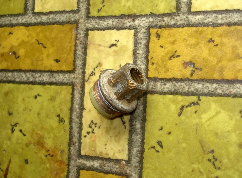

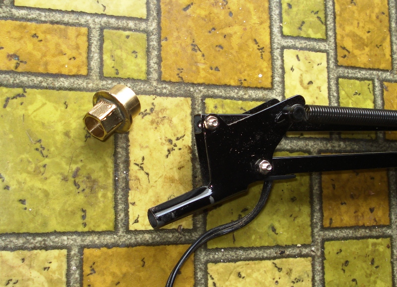

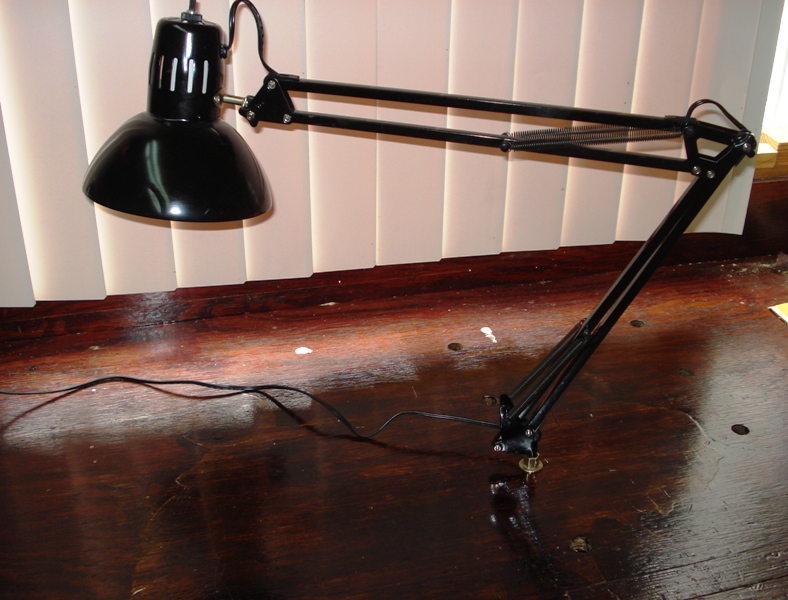

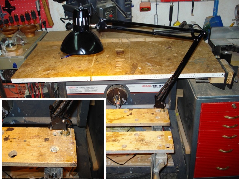

    Sometimes, besides the usual lighting in the shop, you need an extra light near the working area. Two links found in Pinterest (AW Extra 7/5/12 - Bench Dog Light - Popular Woodworking Magazine, Lamp Bushing - Lee Valley Tools) gave me the thought to make some bushings, in order to place an additional lamp in the holes for bench dogs of the workbench. They are made with discarded plumbing nuts.
    With this bushing, the lamp can easily be mounted and dismounted. Besides, since the lamp is fixed in the middle of the workbench, it won't interfere with working, as when the lamp is clamped at the edge.

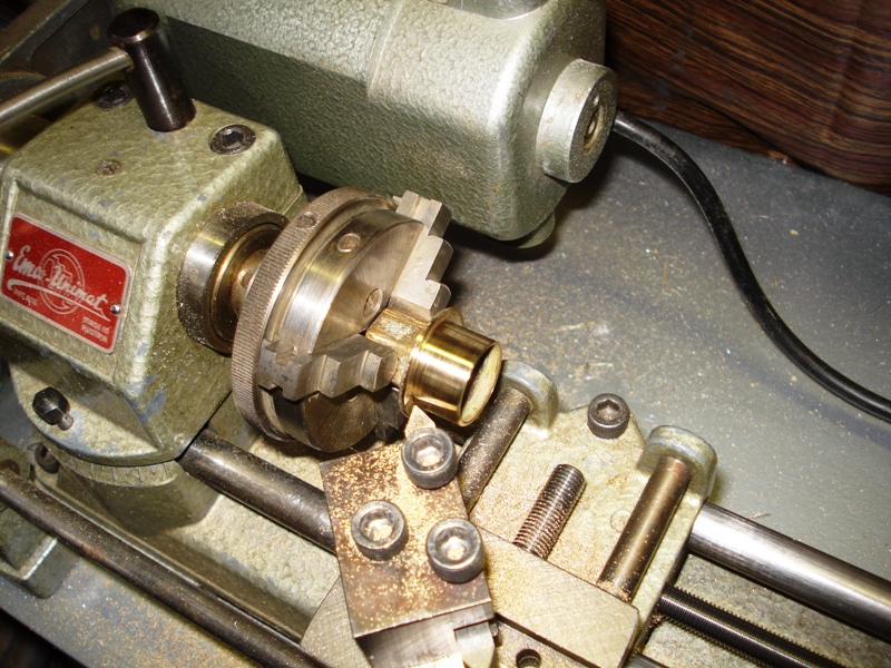

    My first thought was to make this bushings out of one of the round materials that I had in the shop: aluminum, brass, or polyethylene, but in the end I decided to reuse this discarded nuts, with the advantage that more than half of the work was already done.
    I must say, my knowledge and ability to work with the Unimat lathe are rudimentary, as compared to yours.

    Thank you about my Unimat work. The Unimat is not very good at hogging cuts so whatever you can do to reduce the machining work is the best approach. You just have to have patience and using the U100 continuous duty motors eliminates cool-down periods. Sometimes I rough-out the machining on one of my larger lathes and use the Unimat to do the fine finish work. The book "The Shop Wisdom of Rudy Kouhoupt" (the first in a series), edited by Joe D. Rice from Village Press is an excellent reference for making tool accessories for the Unimat and example projects (several cool stationary steam engines).

    Thanks for the advice, Paul. I only have this lathe for metalworking, and a wood lathe.
    I reviewed the index of the book in Scribid; it looks interesting, but I’m not sure if I could get to use all that information, since, unlike woodworking, I don't have training in metalworking.

    Thanks for posting this morsa. It's truly one of those "well yeah!" type things. I have a double bulb mechanical drawing light like that, that I use for all my assembly work. And the major drawback is the silly edge clamp. I have no idea why I'd never thought about drilling a hole in each of my bench tops and put some kind of bushing in it to position the lamp better.
