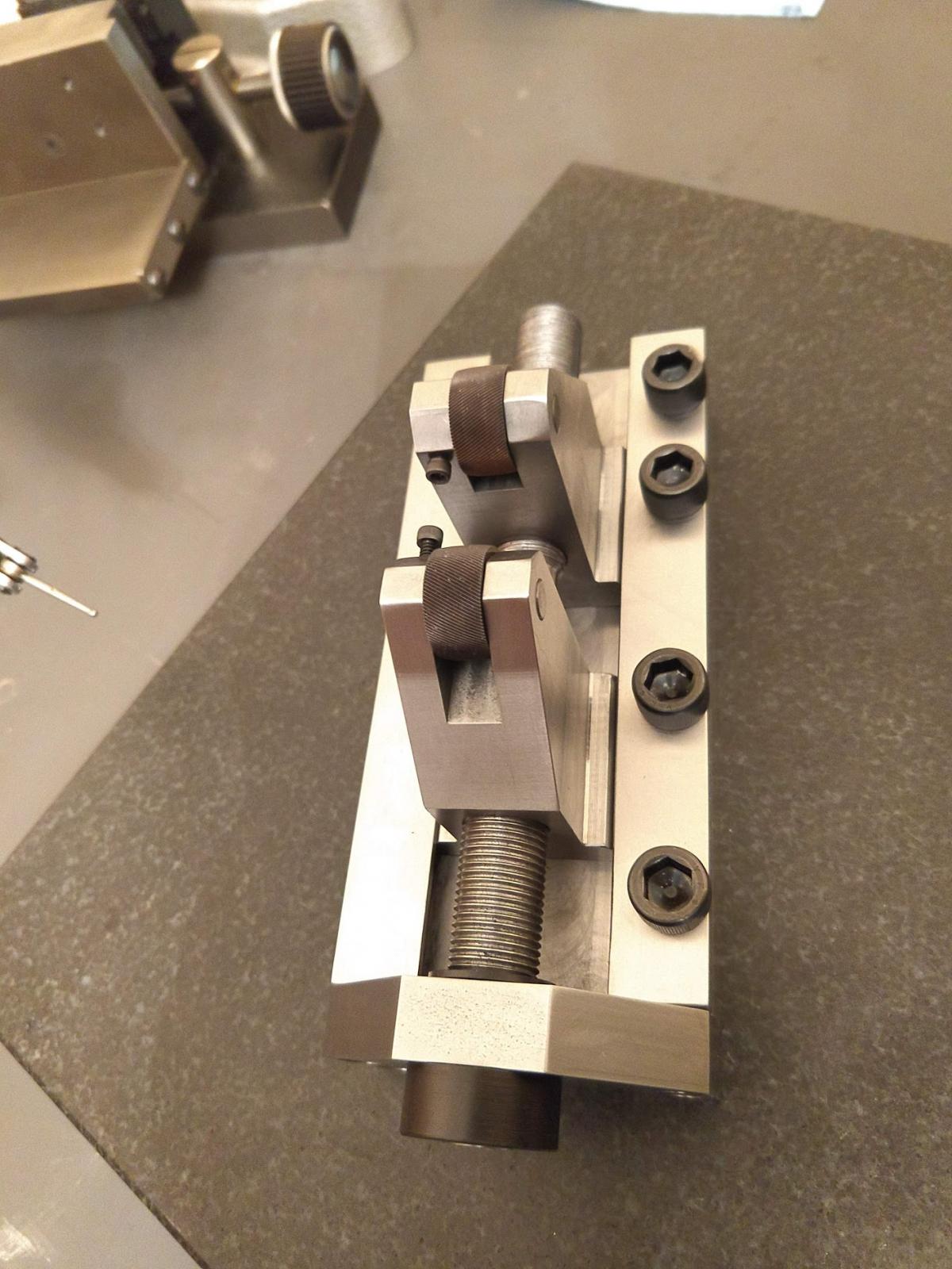

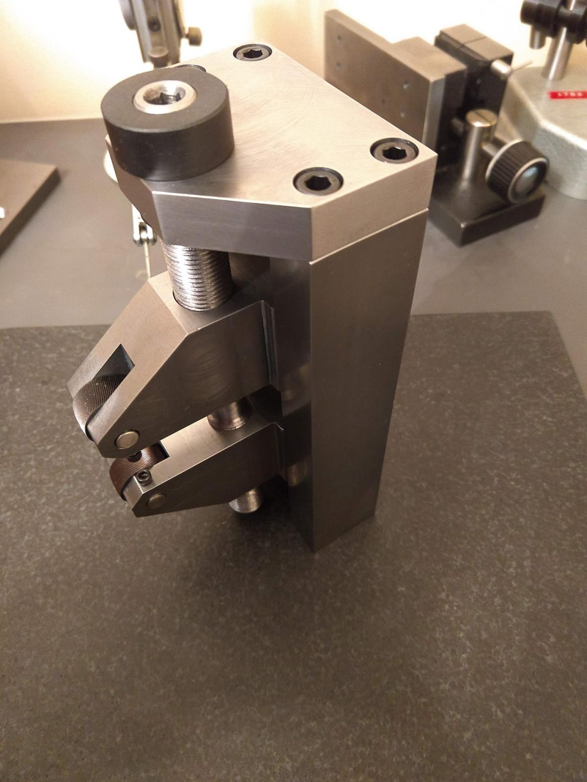

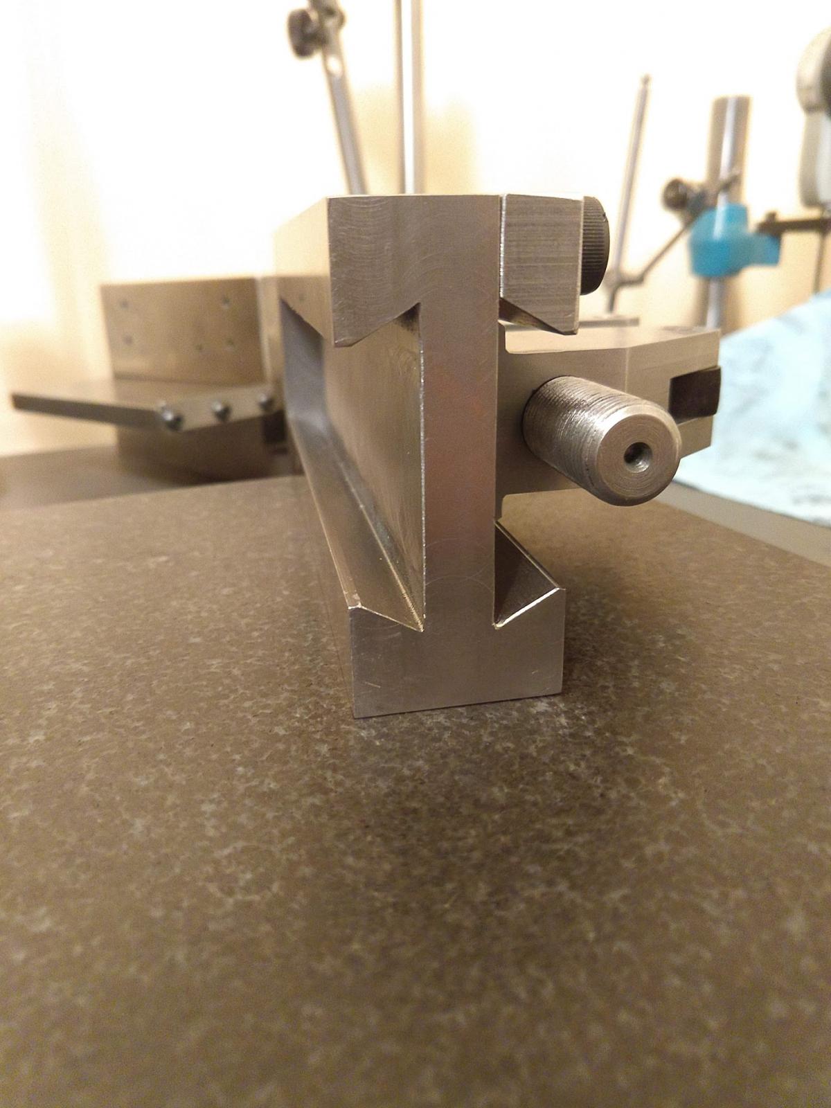

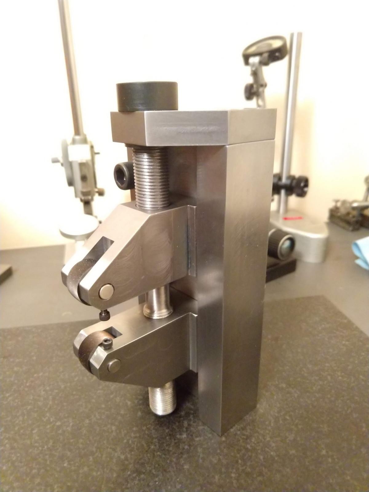

    I bought the plans and got the knurler done yesterday. It was a really fun project to do. I'm not sure you need all 4140HT but that is what I used. I made a few mistakes but nothing that ruined a part. I broke a tap on the dovetail slide and also drilled the first hole incorrectly by mistake hence the big ugly 3/8-16 cap screws. There was no room to countersink them. The other was that I made a larger relief on the center of the feedscrew than what the plans called for. I haven't made the height adjustment screw yet. I used two pieces of Delrin on the feed screw to help keep marks off the top plate when making adjustments. I was not able to use my surface grinder as it is too small for 6" length pieces. It's only accurate to within the chuck size, 3"x5". I spent some using wet or dry on the surface plate to get very flat surfaces. Knurling wheels are Accu-Trak 128DP convex. Also I didn't have any 4-40 grub screws so those cap head 4-40 screws are temporary. I ground a very small flat on the hardened dowel pins for the grub screws to bear on.
