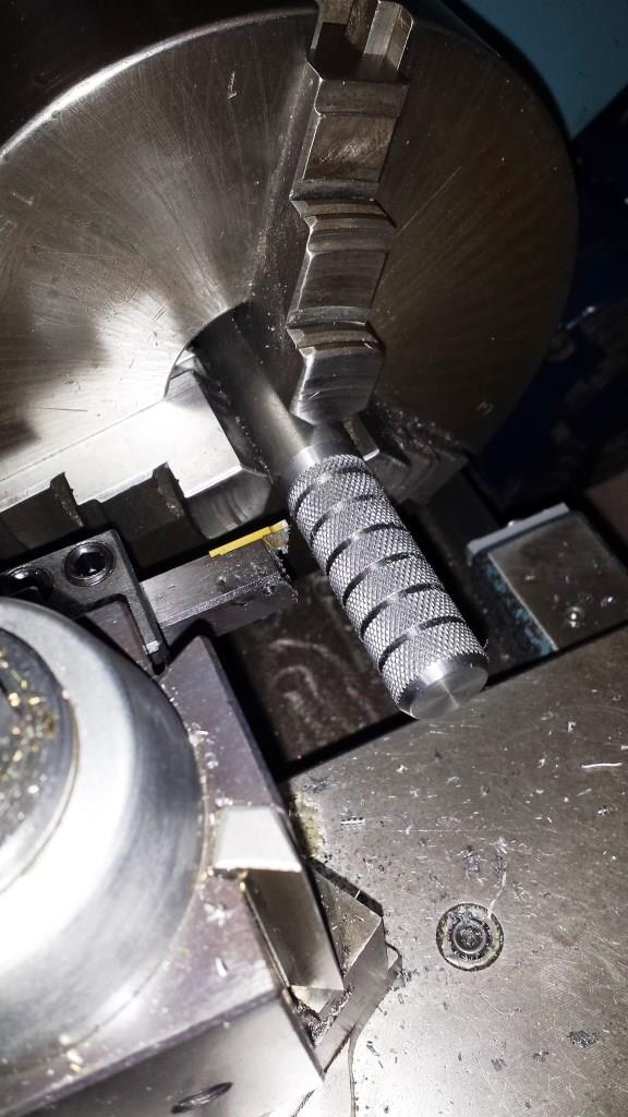

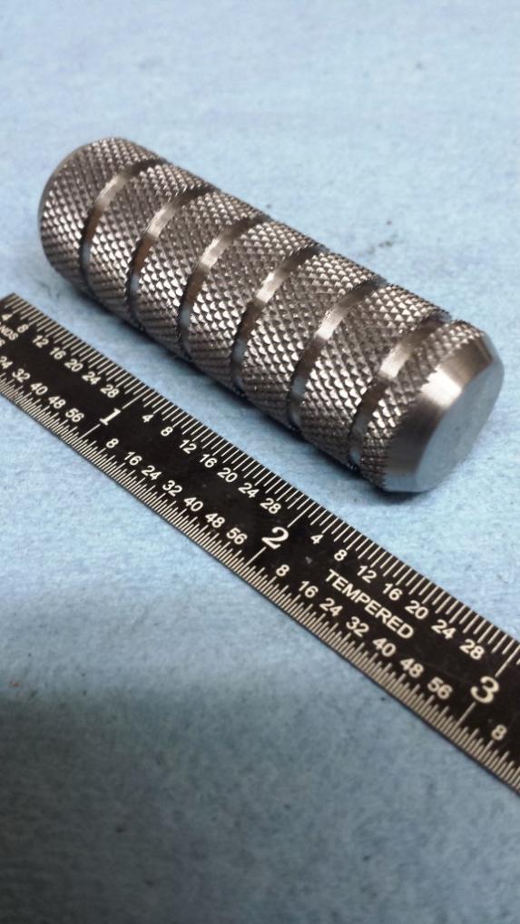

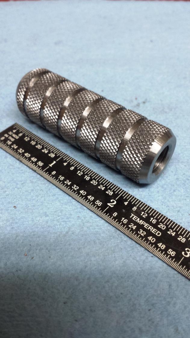

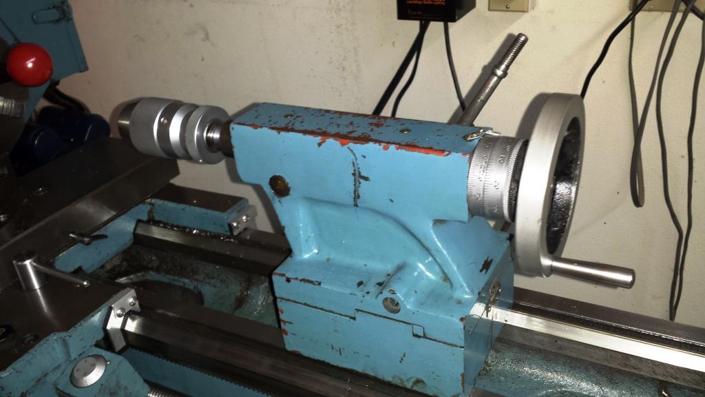

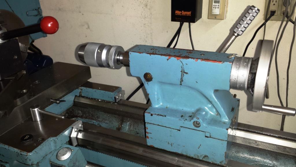

    The knob for the lathe tailstock clamping lever was missing on my used 12”x37” geared-head lathe when it arrived. I designed my own version that is comfortable to use and pleasing to the eye. It is made from 12L14 steel and internally threaded with 3/8-16 thread (and not M10x1.5 considering this lathe was built in Taiwan in 1987). The knob is approximately 0.75” dia. by 2.25” long and made from 12L14 steel. I used a clamp-type knurling tool for the 21 pitch diamond medium pattern knurls. The OD for the knurl diameter can be any diameter that is a multiple of the spacing of the knurl teeth divided by PI (3.14159). In this case it was approximately 49X(0.0476”/3.14159)=0.743” to ensure the knurling pattern tracks well and stays in sync.

    Thank you very much for the recognition. I appreciate the feedback. I am always interested in seeing the variety of tools published in HomemadeTools.net. Lately, I have been publishing a series of tool improvements for my old 12"X37" geared-head lathe. I like to incorporate knurling in some of my tool designs and a crisp knurled surface can be made every time by following a few dependable steps.

    Thank you for the comments. The correct OD for the knurl diameter can be easily calculated by hand with the formulas or using the previous methods provided by Marv or PJs.
    However, as they say there is an "App for that". During the last few years I have been using the Smart Phone app designed for Android phones entitled "Knurling Calculator" but it can only calculate for Imperial knurling and not metric. Nonetheless the initial knurl diameter calculation using the phone app "Knurling Calculator" is close to perfect but I usually add about 0.002" to the outer diameters for making stainless steel parts. I don't using cutting oil but rather plain-old lathe way lubricating oil to make the knurl imprint. The final knurling results are always perfect.
