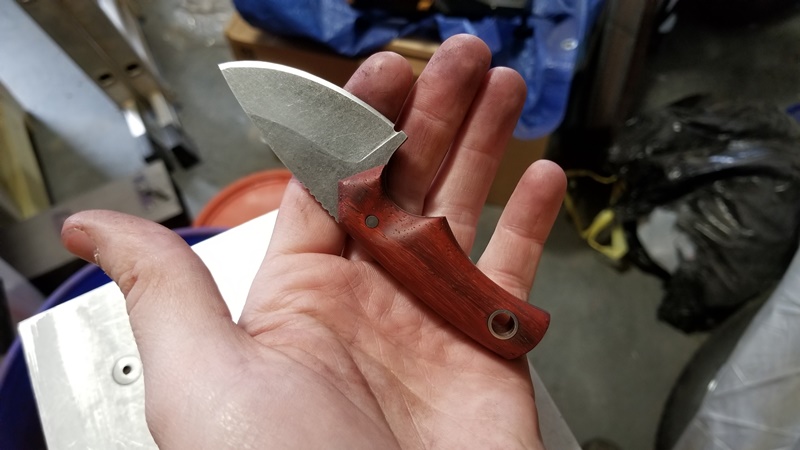

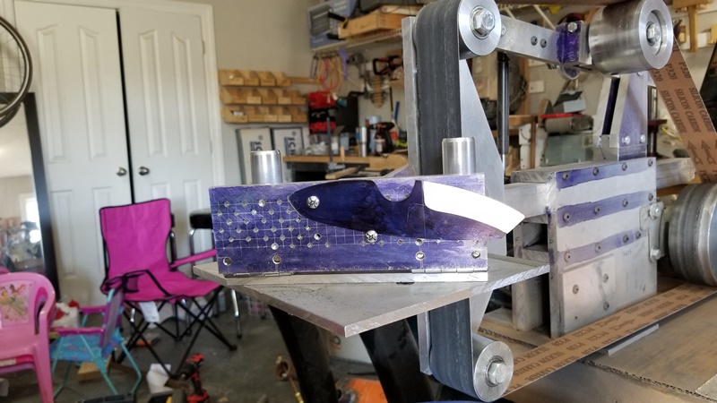

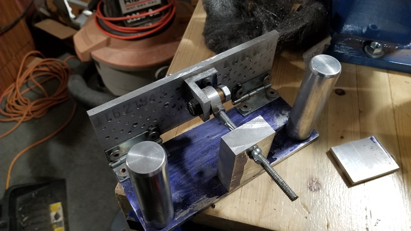

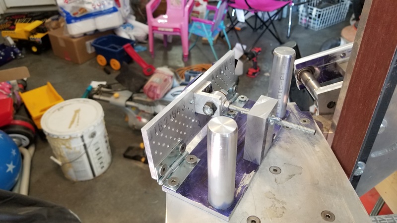

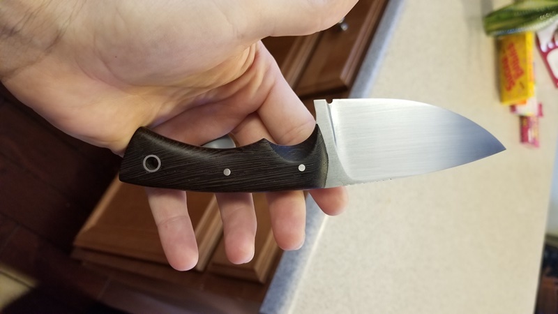

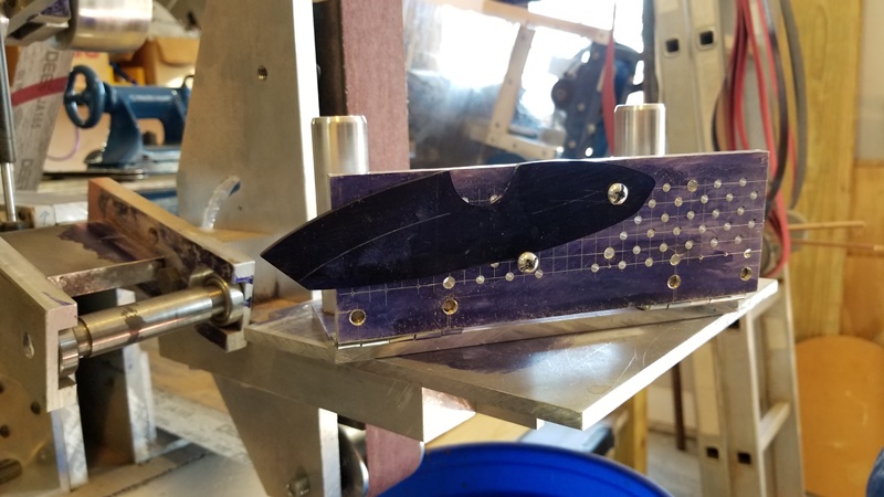

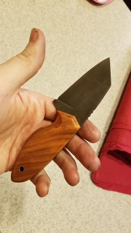

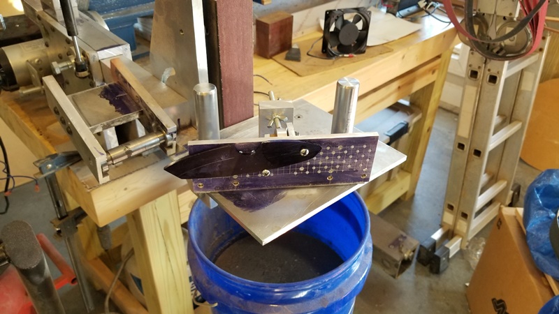

    This is a knife bevel grinding jig that I made for my 2x72 belt grinder. It is adjustable. It is made from (2) 1/4" sheets of aluminum. The front plate is drilled and tapped to hold knifes in different orientations. The angle is set with 2 wing nuts that jam against the rear vertical.

    Nice build mr95gst! The vertical pallet gives you plenty of places to lock your work down. Really nice Plunge line and relief! Thanks for sharing.
