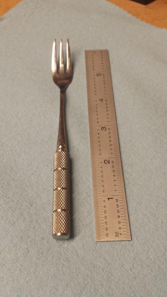

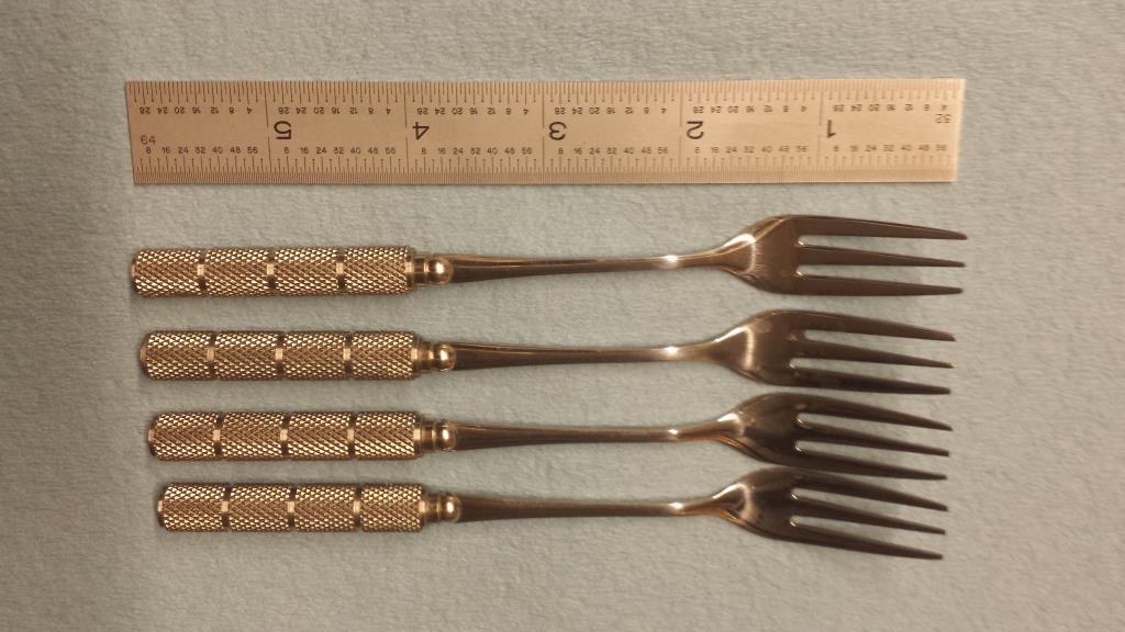

    This is part of my "Kitchen Tool" series for stainless steel tools I made for my wife and friends.

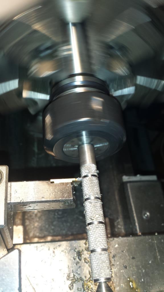

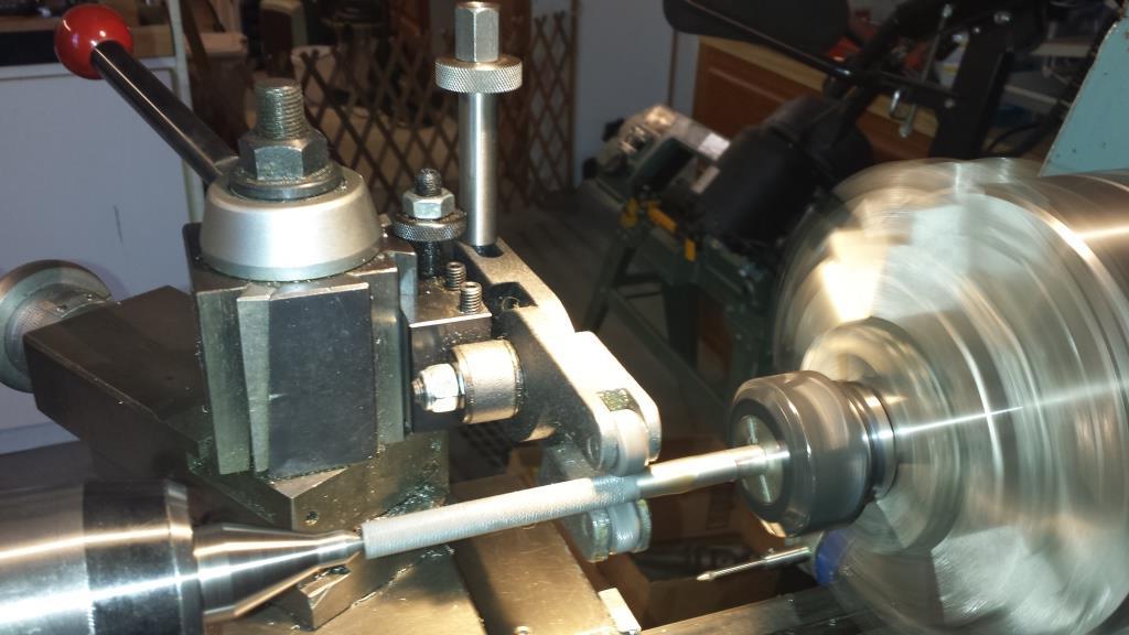

    The following photos include all new stainless handles for small pastry forks. I made a series of 16 handles for the forks using 3/8" diameter 303 stainless steel rod. The 3/8" diameter stainless steel rods were reduced to 0.364 diameter before knurling the 21 pitch knurl (by the way I used the Android app Kurling Calculator to calculate the pre-knurling diameter). The 0.052" grooves were machined with a right-hand Nikcole Mini-systems tool holder and carbide inserts. Also, AR Warner makes T15 inserts for this tool holder and I have used these with success.
    Pastry Forks

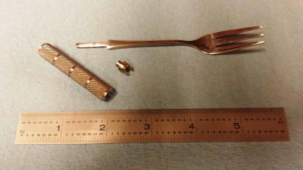

    Parts to Pastry Forks

    Kurling the 21 pitch into the 0.364 diameter 303 stainless steel rods

    Machining 0.052" wide grooves into the stainless steel handles

    Thanks Paul! Beautiful work and that little ferrule looks complicated. Care to share how you made it? Looking forward to your future kitchen tools shares!

    I can't take credit for the well-made little stainless steel ferrules. These were part of the original forks and I just removed the ceramic handle and replaced the ceramic handles with my 303 knurled stainless steel handles. The handles and ferrules are attached with the hi-temp 450 degree F "dishwasher-proof" Loctite 620.
    Thank you for noticing the special construction details. I could not improve on the ferrule design and left it as-is.
