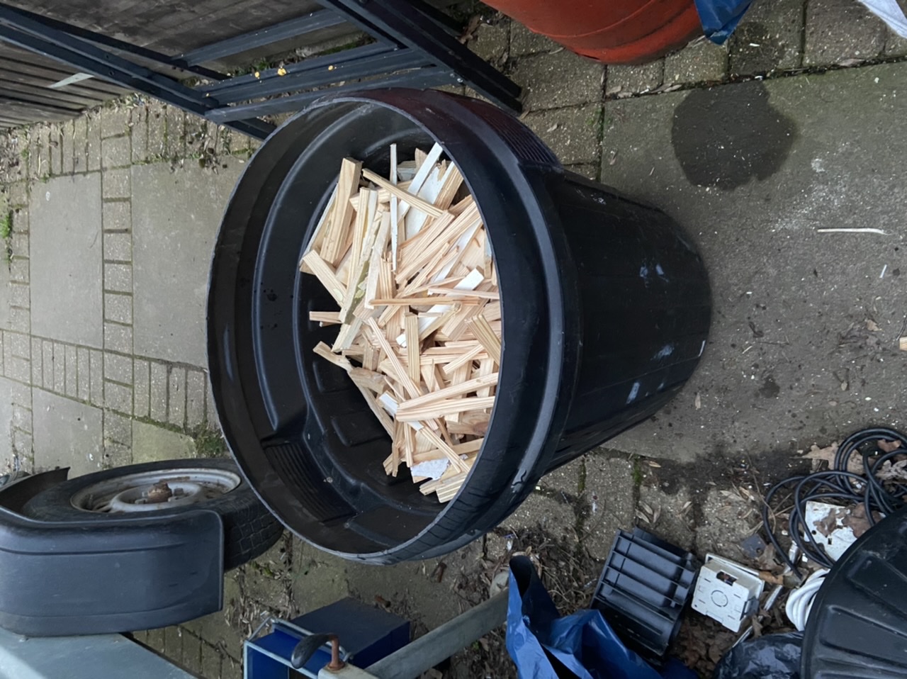

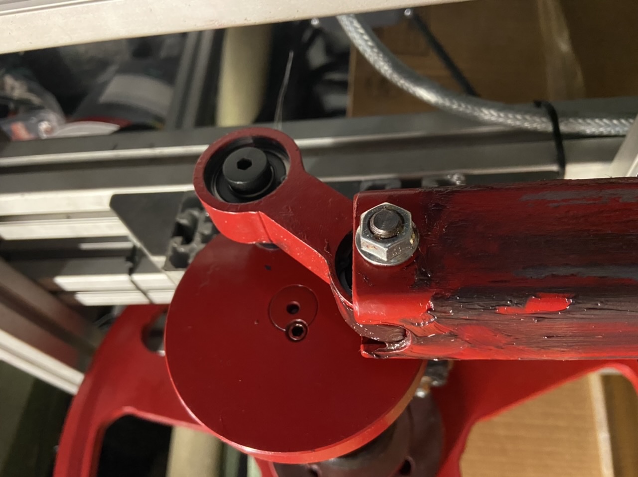

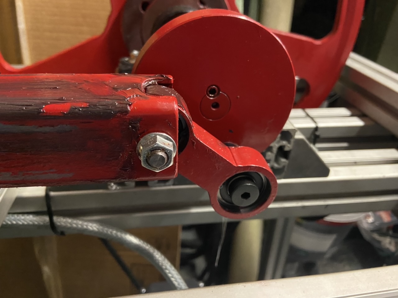

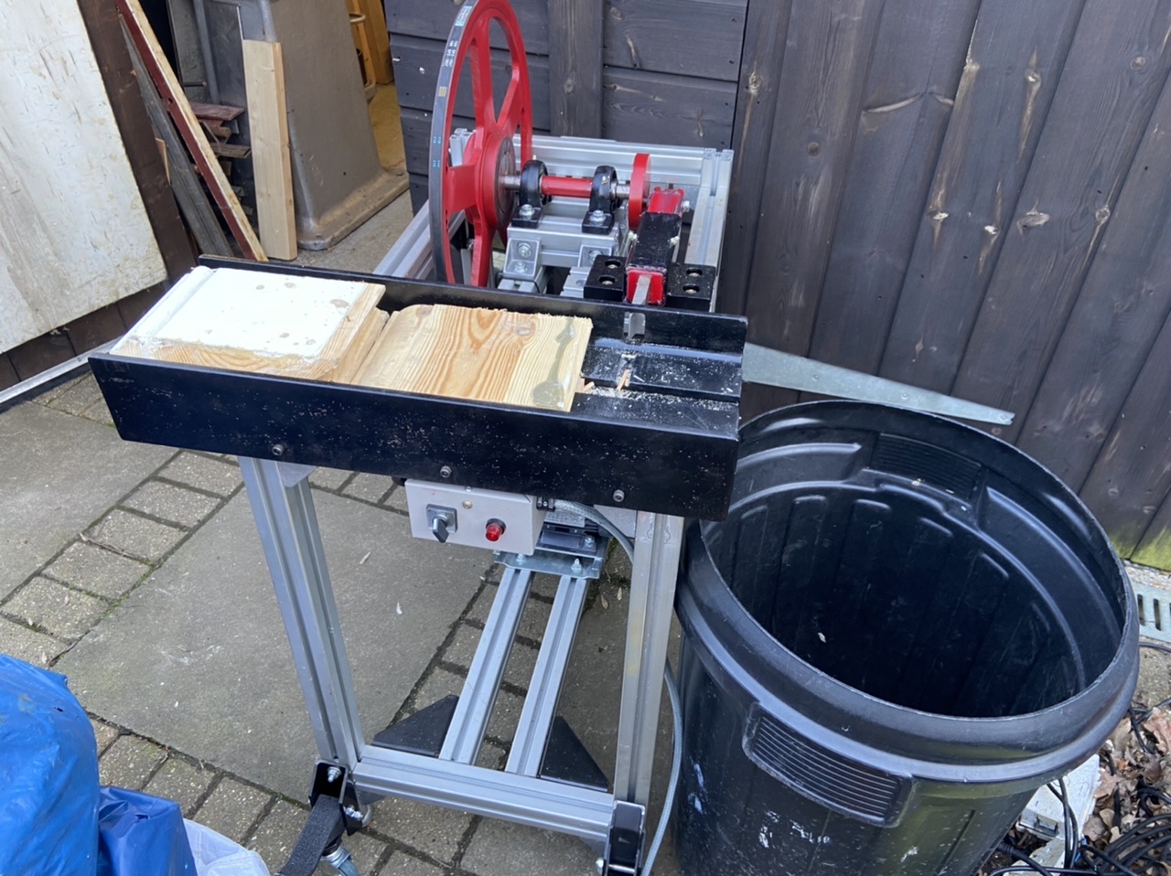

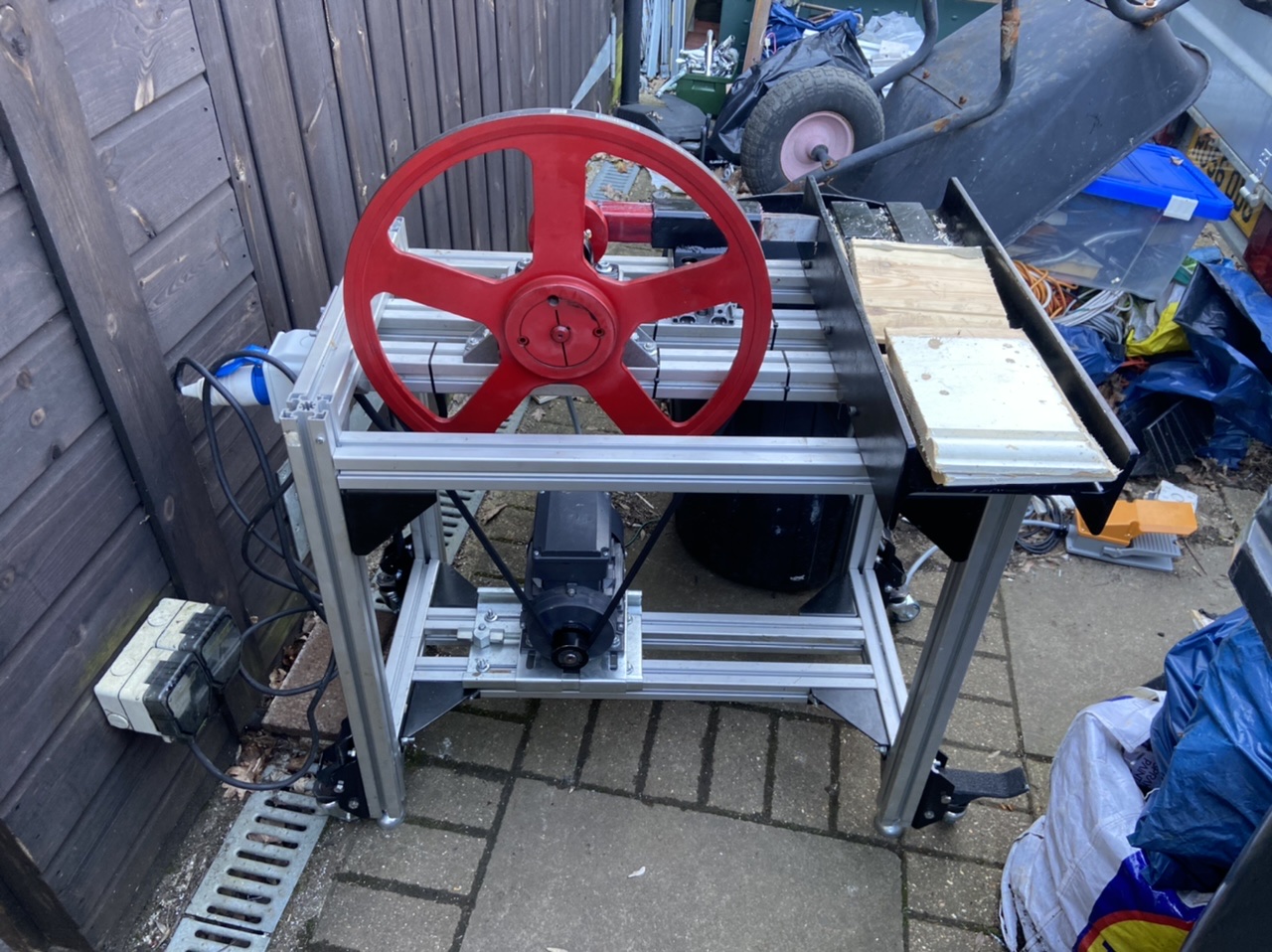

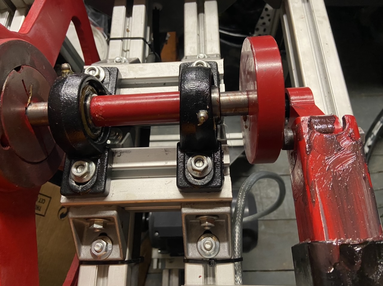

    Recently I finished building a kindle cutting machine.
    The main frame is made of Bosch extrusion salvaged from two frames rescued from a skip and ♻️.
    The motor is single phase 1HP eBay purchase which came with the motor frame and taper lock pulley. The large pulley taper lock pulley, vee-belt and crank bearings are also eBay purchases. There is a foot operated switch from Amazon and the rest of the machine is made from materials lying around the workshop.
    The retractable castors are also homemade which I have posted on HMT
    This has made chopping kindling so quick and easy, after 20 minutes a bin full ready to use.
    Thank you for viewing
