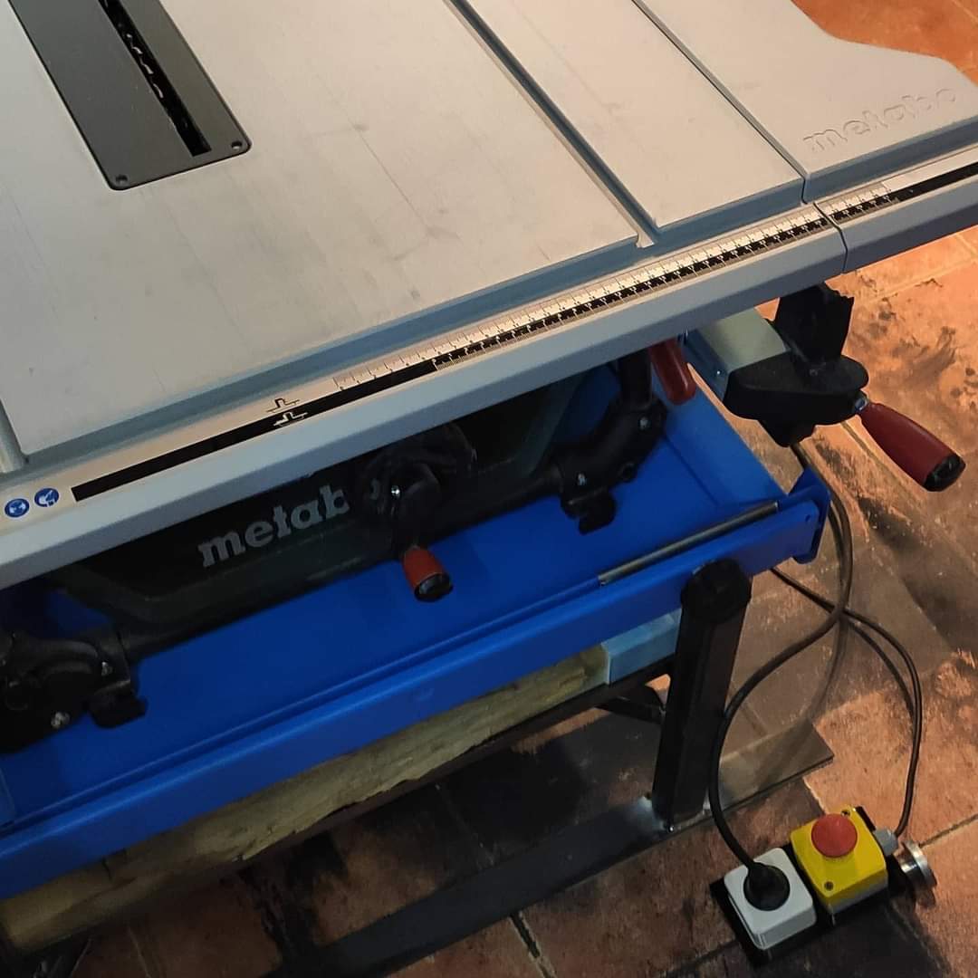

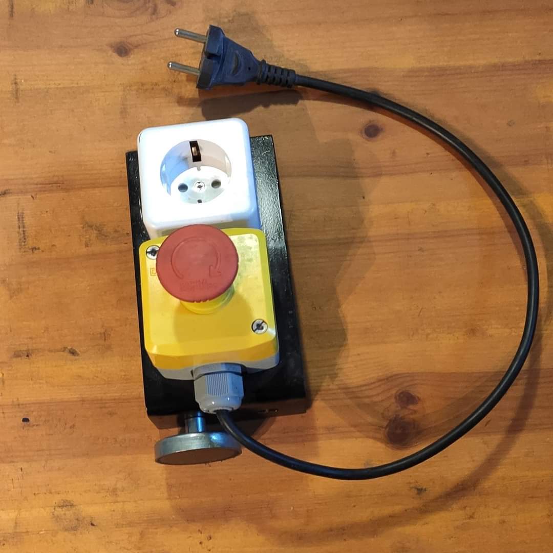

    As a title says.
    This is my kill switch extension cord.
    Its a plate that's been bend to 90 degree angle.
    To the longest side, i mounted a kill switch and electric outlet.
    In the shortest side is a magnet. ( 15 kg lifting magnet )

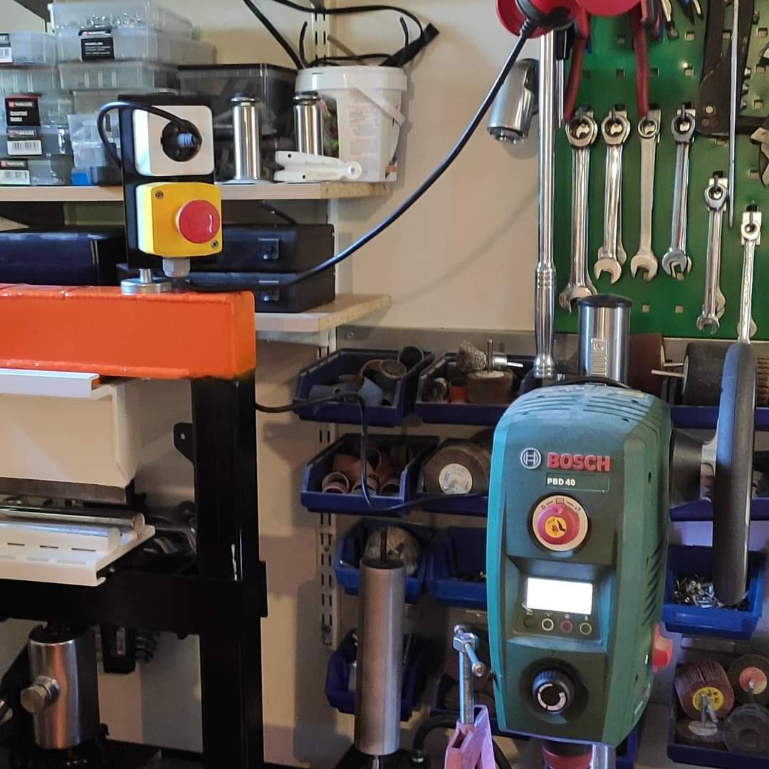

    Easy to change to what ever electric tool i use.
    Specially with tablesaw, this is usefull.
    When put to the floor its much easier to reach it with your feet.
    Than power switch that's placed to the side of the saw, with your hand.
    Usually you can see, hear, or feel when workpiece that you are cutting, doesn't go straight. Then risk of "kickback" gets higher.
    One can try to pull workpiece back, lift it off or something.. but, its sometimes tricky. Specially with wide boards, both hands on it.
    Then just stamp to the killswitch.

    Yep. I was thinking the same, that in actual emergency, this kind of button doesn't always work, you need to hit it.
    So, because i seem to be more mechanical, than digital guy.
    Started to plan new version, that works somewhat same way than mousetrap.
    One that works when you kick it or something like that, without need to hit the actual button ( its somewhat small target )
    Electrical version would be better.
    I will ready your text about the relay with attention.
