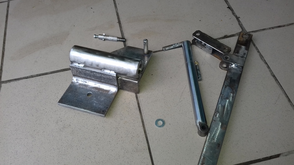

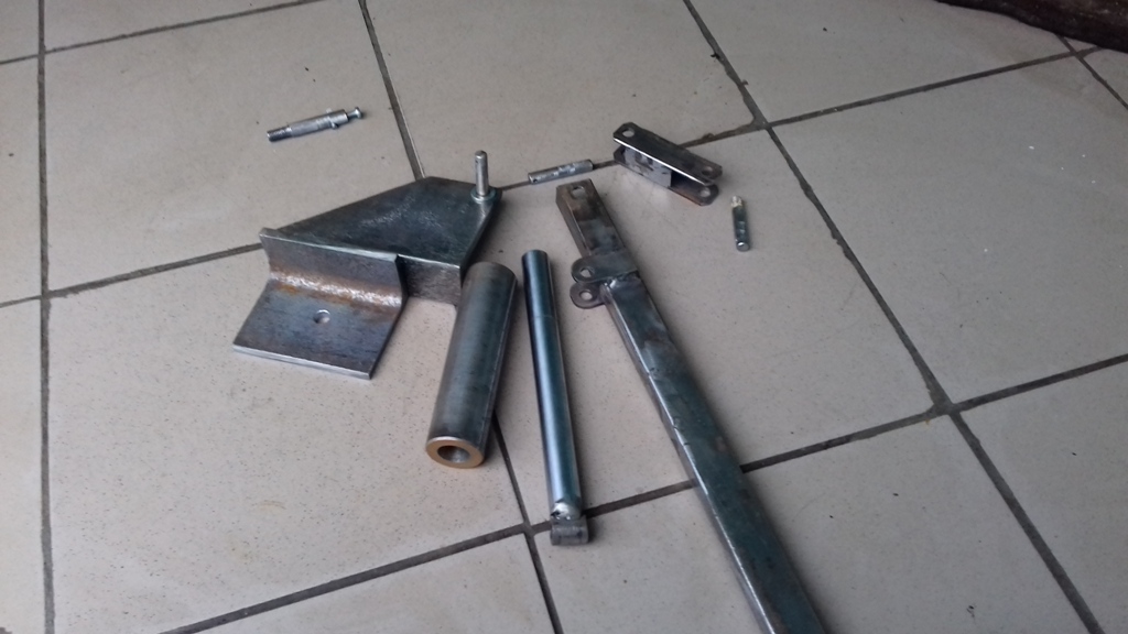

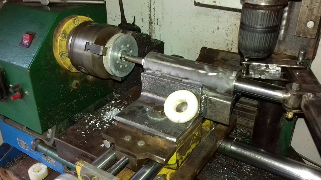

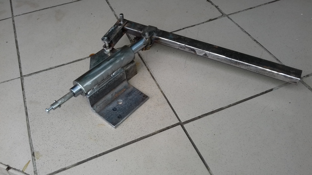

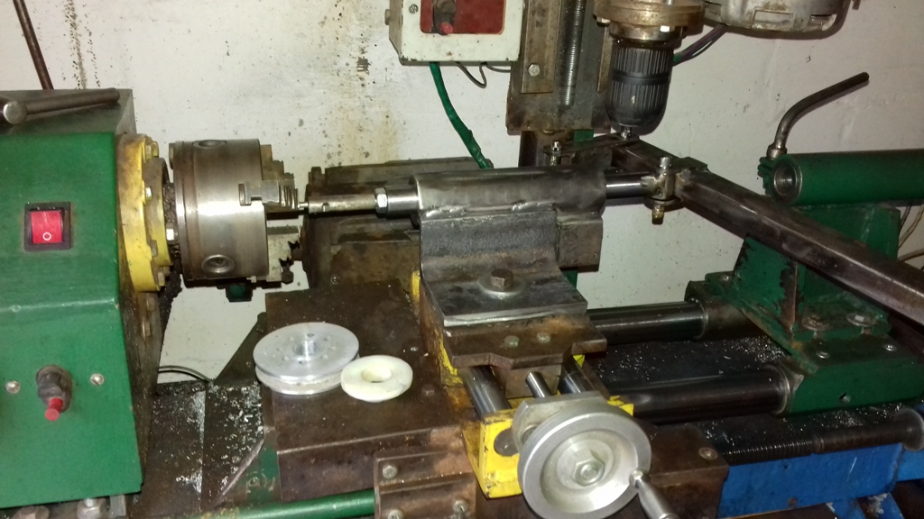

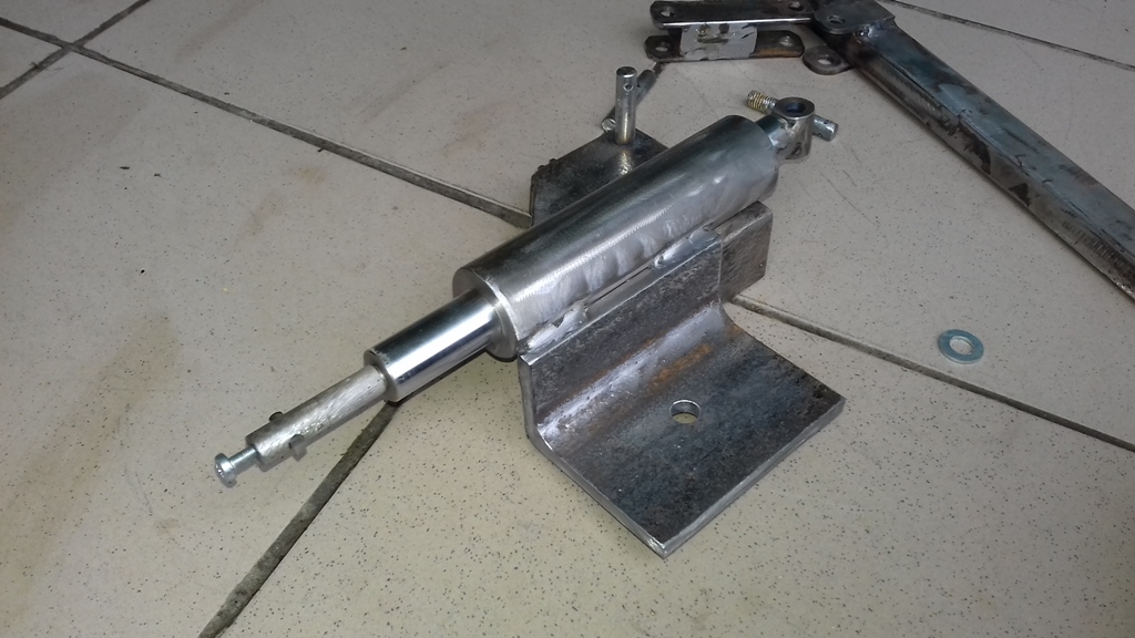

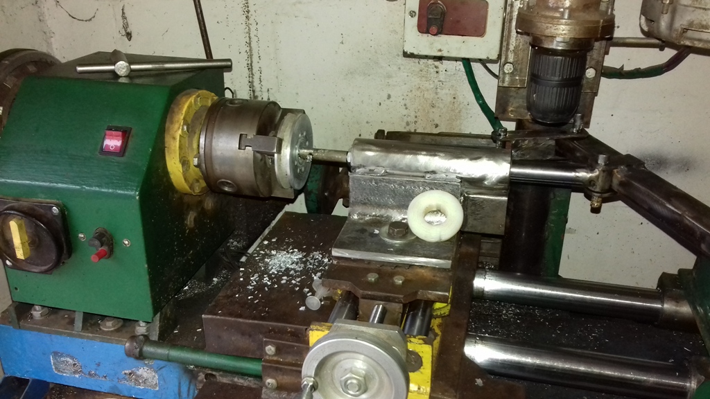

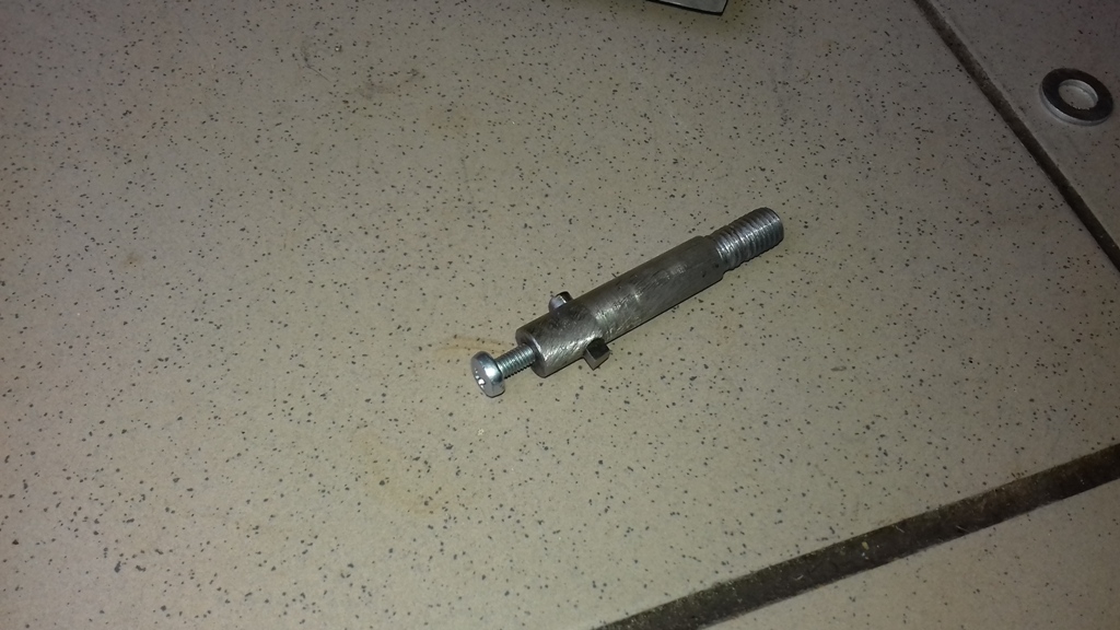

    Hi. My Keyway Cutting Tool For Lathe
    Keyway Cutting Tool For Lathe-20191226_094324.jpg Keyway Cutting Tool For Lathe-20191226_101428.jpg Keyway Cutting Tool For Lathe-20191226_101618.jpg Keyway Cutting Tool For Lathe-20191226_101651.jpg Keyway Cutting Tool For Lathe-20191226_102905.jpg Keyway Cutting Tool For Lathe-20191226_121219.jpg Keyway Cutting Tool For Lathe-20191226_123158.jpg Keyway Cutting Tool For Lathe-20191226_123209.jpg

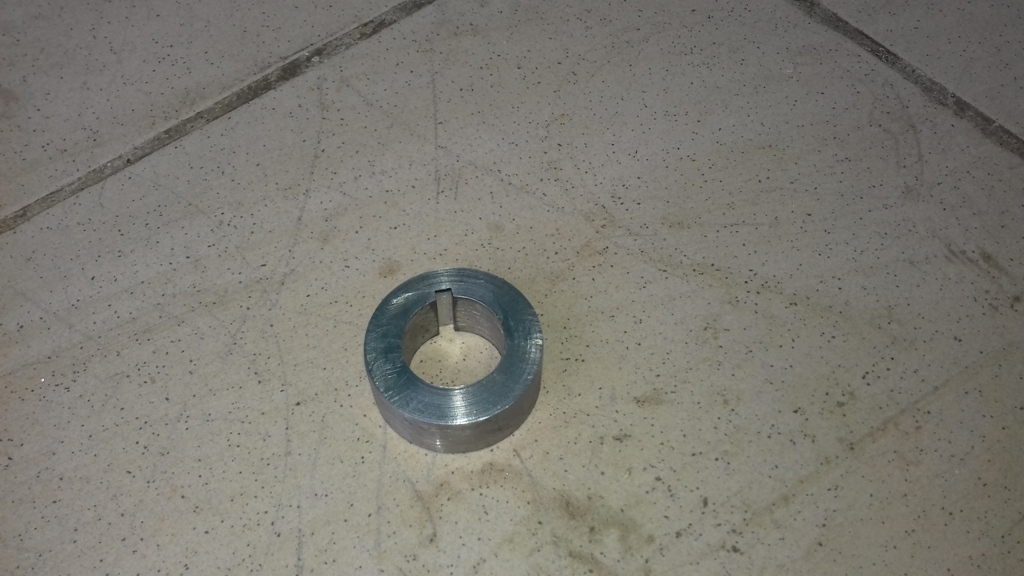

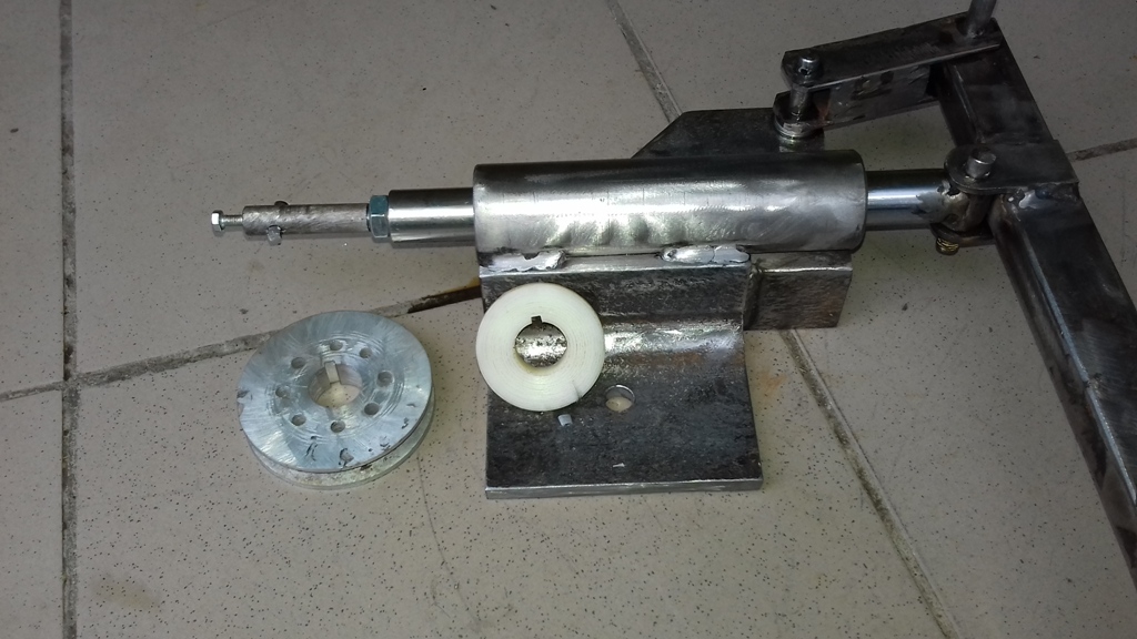

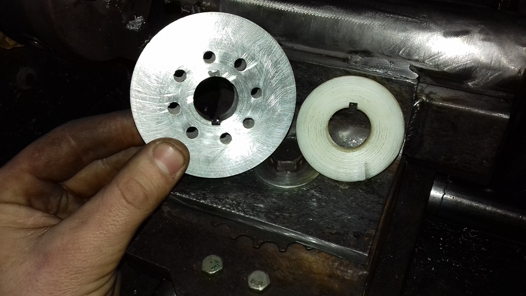

    Result. It looks good
    Keyway Cutting Tool For Lathe-20191226_123423.jpg Keyway Cutting Tool For Lathe-20191226_123750.jpg

    Can you reverse the cutter and cut a shaft keyway? I know there are other ways of cutting a keyway but thought I'd ask.

    Quote Originally Posted by Ralphxyz View Post
    No, this tool for cutting keyway in the hole.
    At 00:55m the cutting keyway on the shaft

    I am often told that Keyway Cutting Tool For Lathe is only suitable for cutting soft metals and plastics. So I decided to showcase his work on solid steel. Works very well, solid metals are no barrier.
