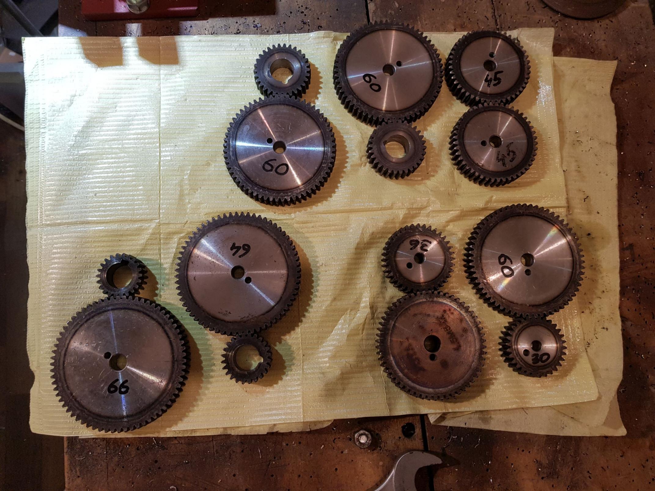

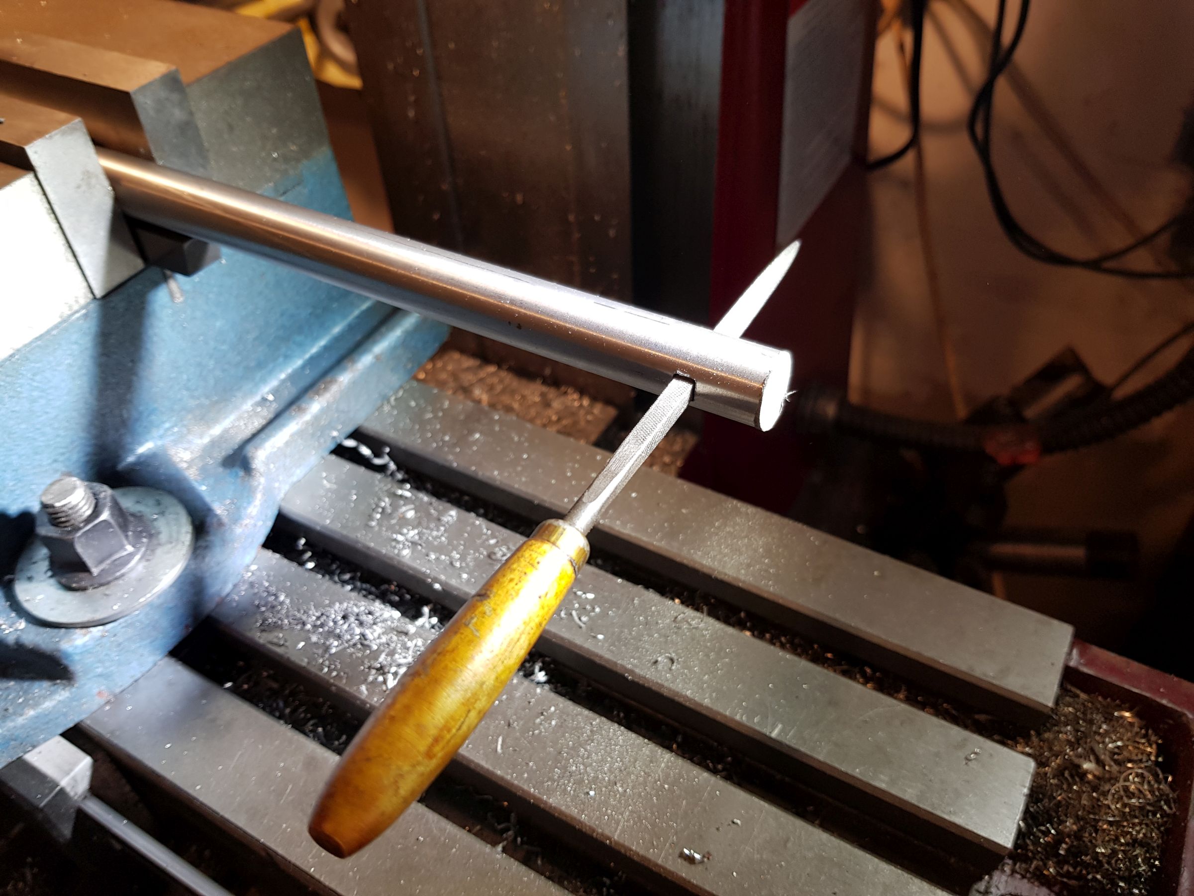

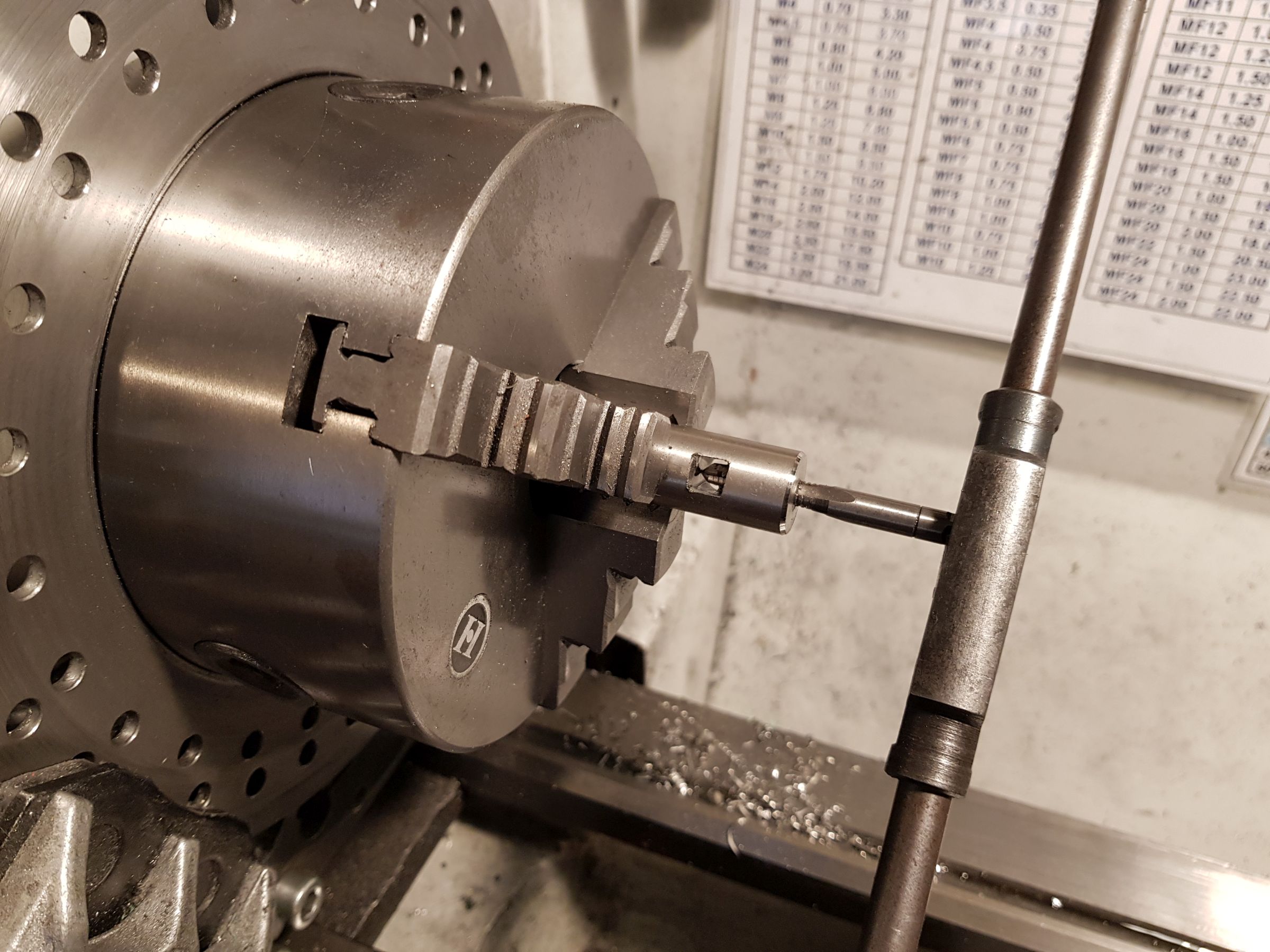

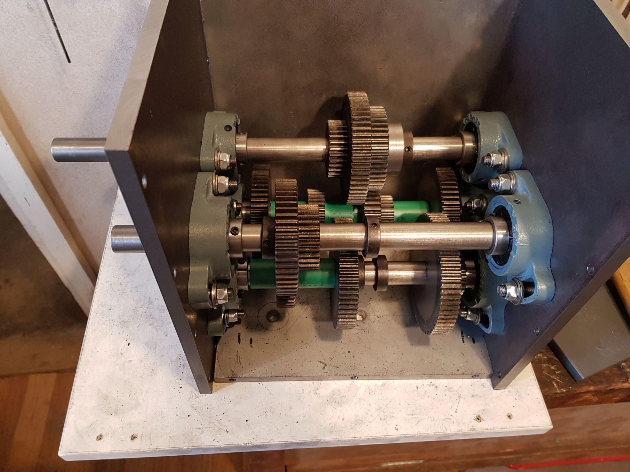

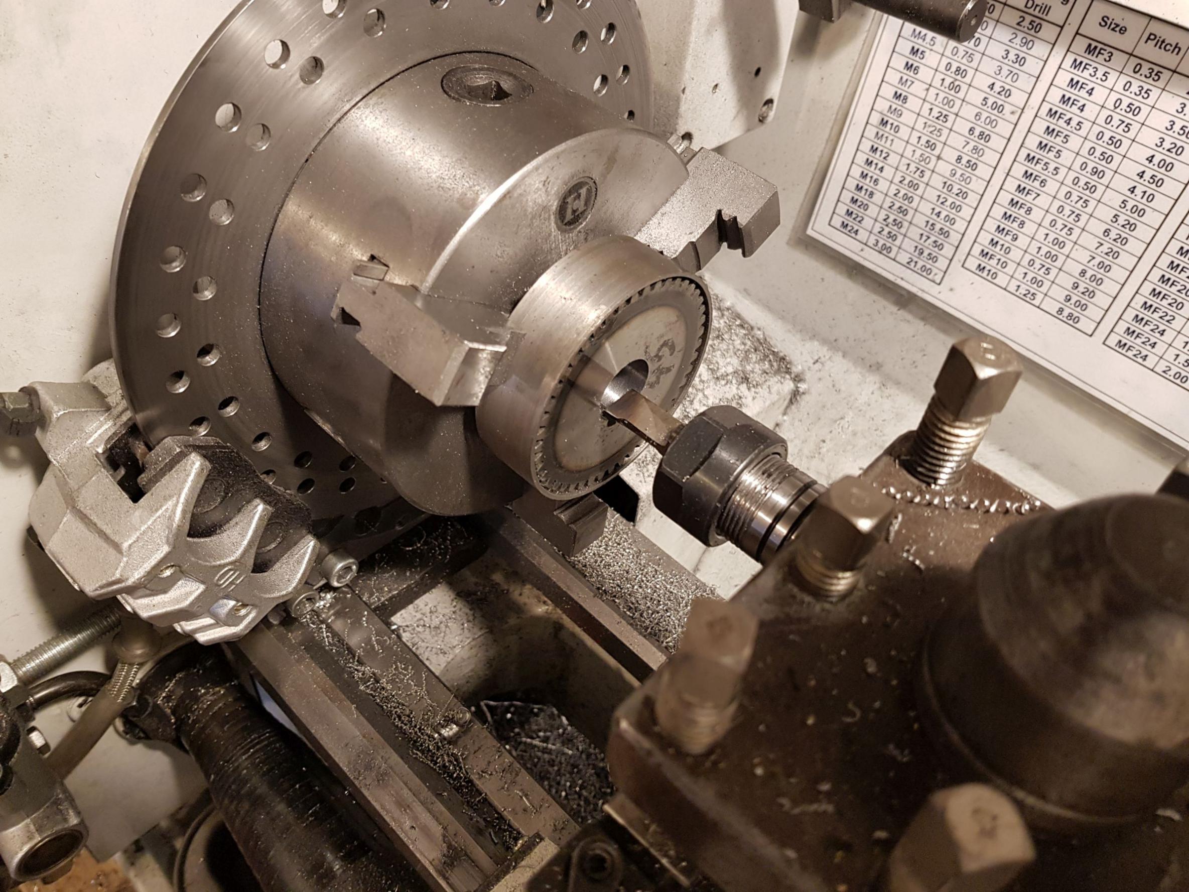

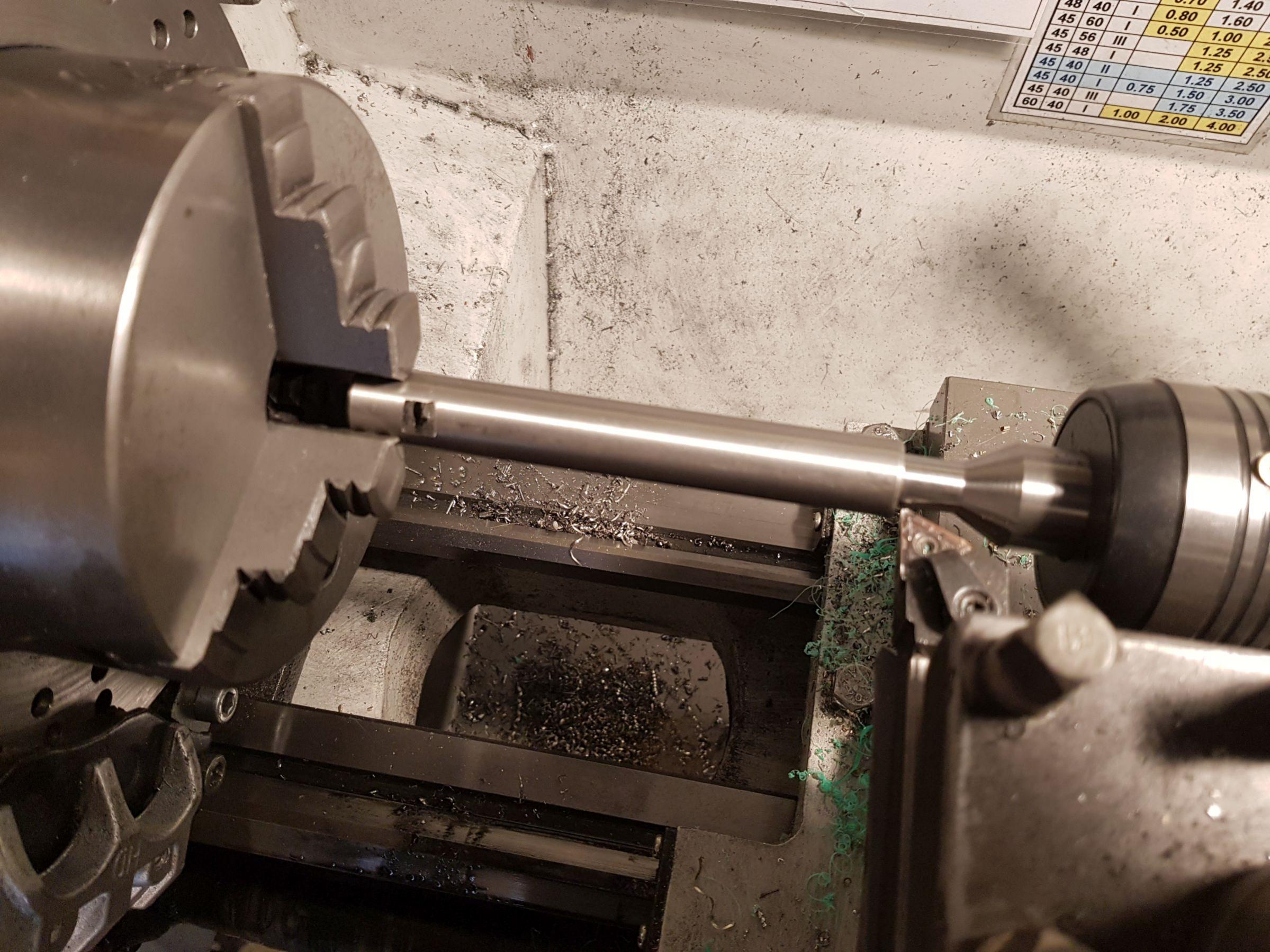

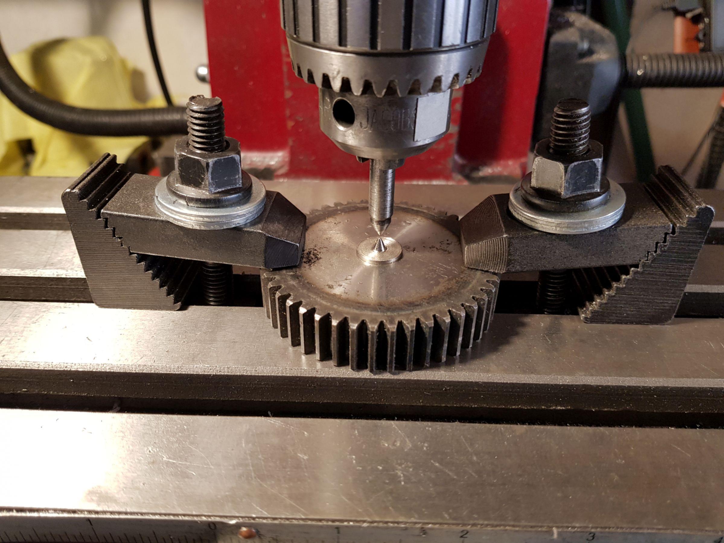

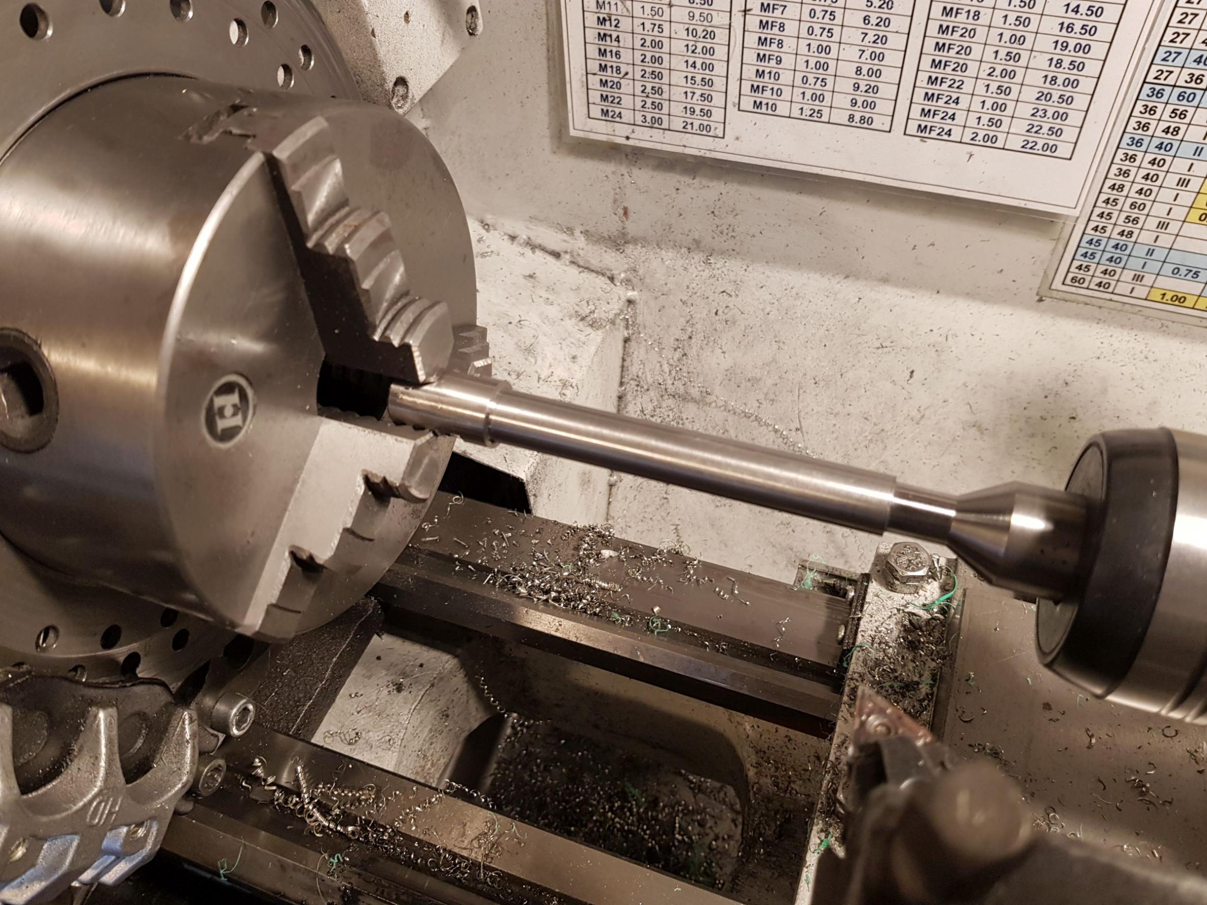

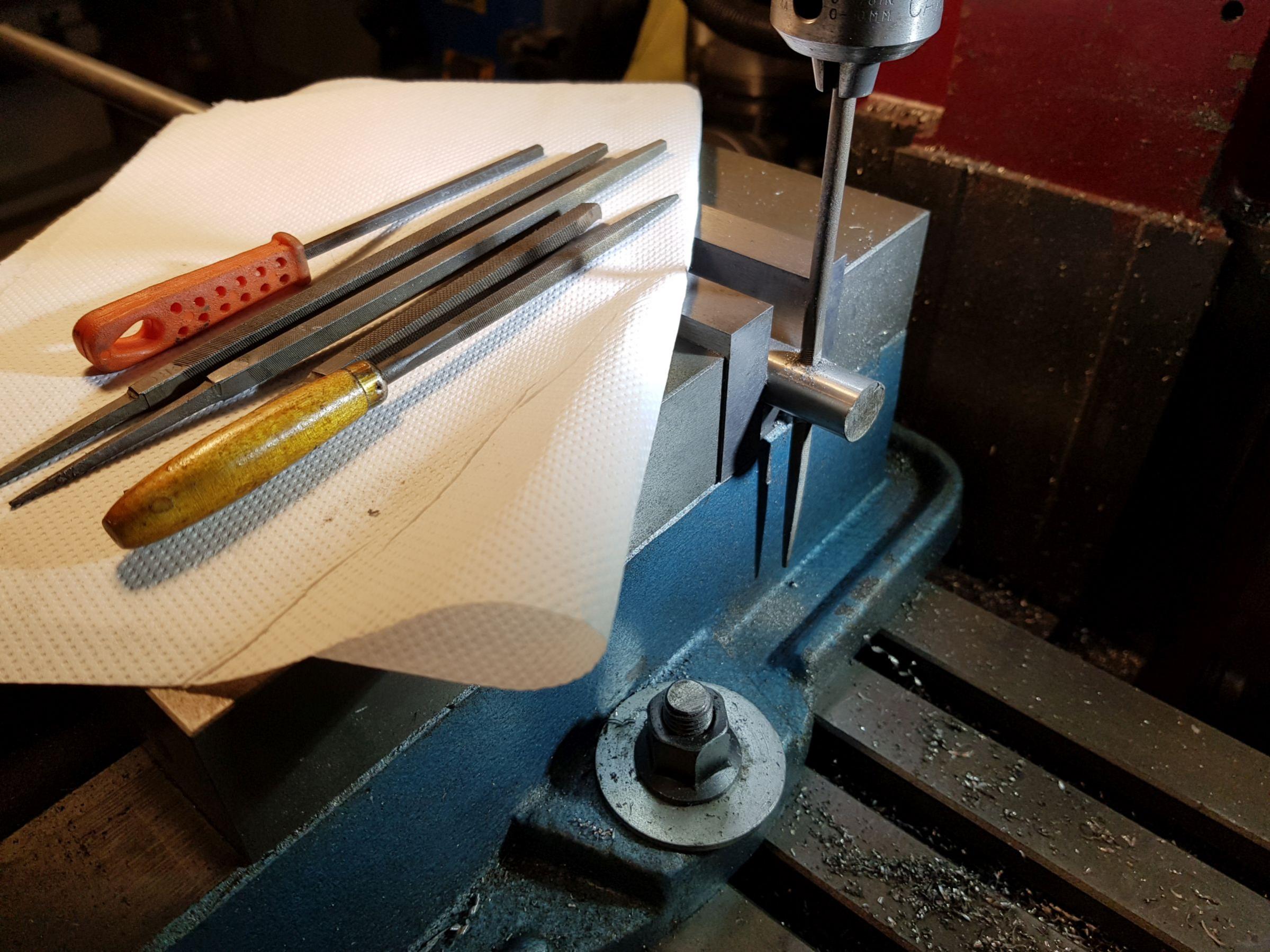

    Made keyway cutter which I needed to cut keyways in 14 gears and 2 pulleys for my present project (external lathe headstock gearbox - still in progress, but I can see the end).
    Made from 16 mm dia stainless steel round bar. Very simple to make but some elbow grease was used when filling the square hole for 6 x 6 mm square HSS bit. It can be used in lathe and drill.
    Cheers
    LMMasterMariner

    LM Master Mariner,
    That is lot of special work steps and the finished broaches look very precise. I like the way you created the special rings for protecting the gear teeth during the boring and broaching operation.
    Looking forward to seeing the lathe headstock gearbox when it is finished.

    So in the lathe environment, do you set the tool, traverse across the keyway shaving a bit off, retract the tool using cross slide, rinse & repeat until final depth? If so, about how much per slice?

    Thanks for that- lots to observe there with good pictures too.. I like your brake caliper on the lathe!

    Quote Originally Posted by petertha View Post
    I was broaching keyways by moving the carriage (elbow grease again) back and forth and for the first cuts where I already had the hole, I could increase 0.06 mm for each pass and near the end I was able to increase 0.01 mm per pass. Also from time to time made several passes without increments due to elasticity of gear material. It took me about 5 minutes to make keyway in a gear (#45 steel, thickness 15 mm, hole I.D. 20mm, key 6 x 6 mm; little bit more than 3 mm in gear keyway)
    Cheers
