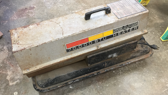

    I got this kerosene space heater about 40 years ago. Paid $10.00 for it, brand new but damaged, at Sears. (remember them) It had been returned. It appeared someone had dropped a concrete block on it.
    I just pounded out the dents, and have since heated a lot of job sites with it. You can still see some of the original dents on the discharge end.

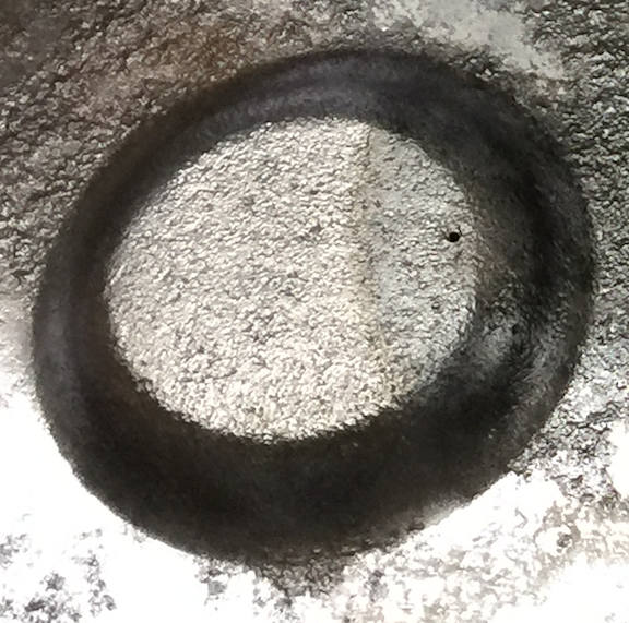

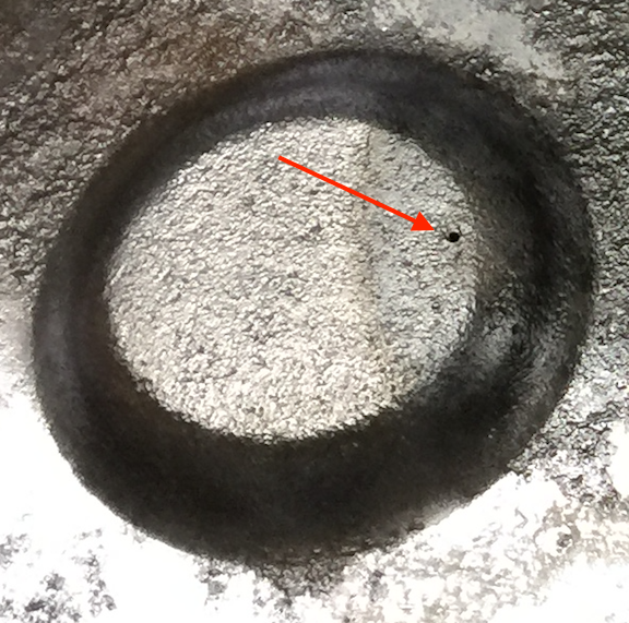

    I got it out last week and discovered a hole in one of the "feet" on the fuel tank.

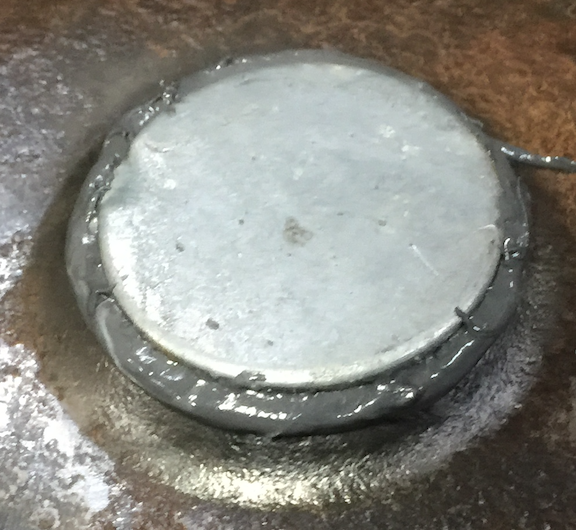

    After wire brushing it clean, I used JB Weld to seal the hole. Adding a 3/4" knockout from an electrical box for reinforcement.

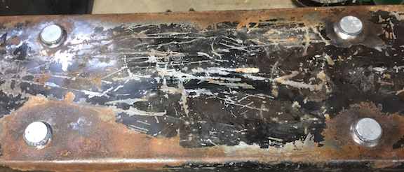

    Then did the other feet. If one was bad I figure the others must be close since they have all been sliding around on the floor for 40 years

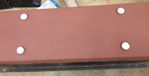

    Added some Rust-Oleum. Back in business.
