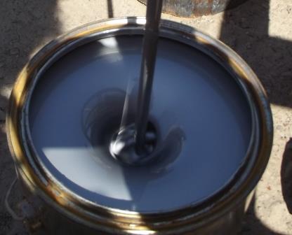

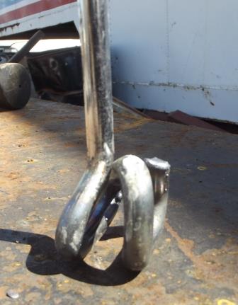

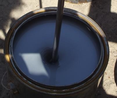

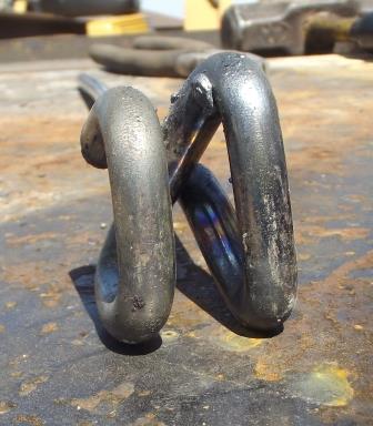

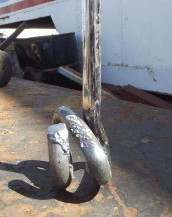

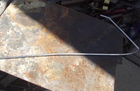

    Well this one I mingt keep a while
    It is made from a scrap piece of 5/16" chrome rod with a double paddle bend on the bottom
    when plunged all the way to the bottom of a 1 gallon can of paint and spun in my 1/2" 675RPM drill it will create a vortex cavity nearly all the way to the bottom. then when held just under the surface instead of slinging paint all over the place it still created a downward vortex Absolutely the best paint stir attachment I have ever owned.
