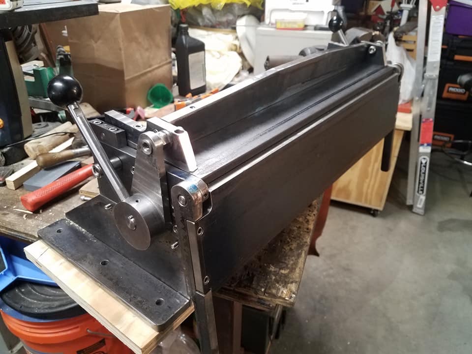

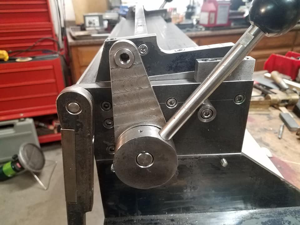

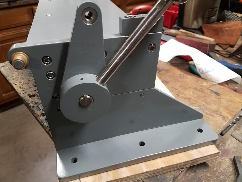

    I’ve been working on this JRW Sheet Metal Brake for a couple years now.
    Finally decided to bring it to a close and get er done.
    Plans are at:
    http://www.homemetalshopclub.org/pro...etal_brake.pdf

    Plans call for 24" width. If you scale it for wider material, I'd go 3/4" on parts #3 and #7, if you plan on going over 30" width.
