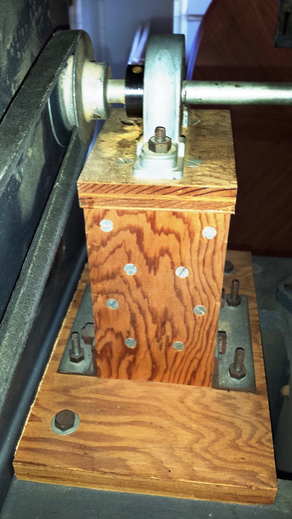

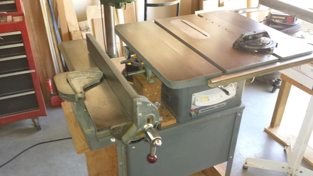

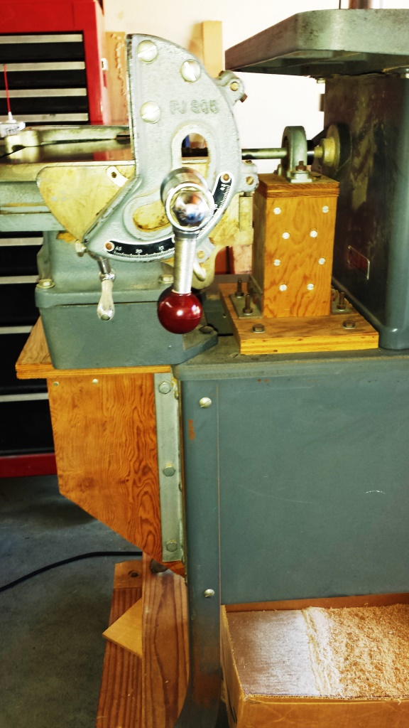

    In 1968 I bought a Rockwell-Delta combination 9” table saw and 4” jointer that can use the same motor (but not at the same time). It was a clever tool design in one convenient unit but the table saw lacked the wider side table extensions. I added the two side extensions but had to move the jointer farther away from the table saw and provide a pulley shaft extension.

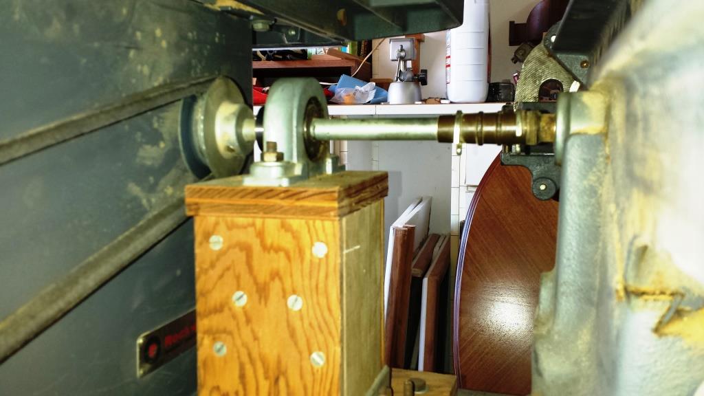

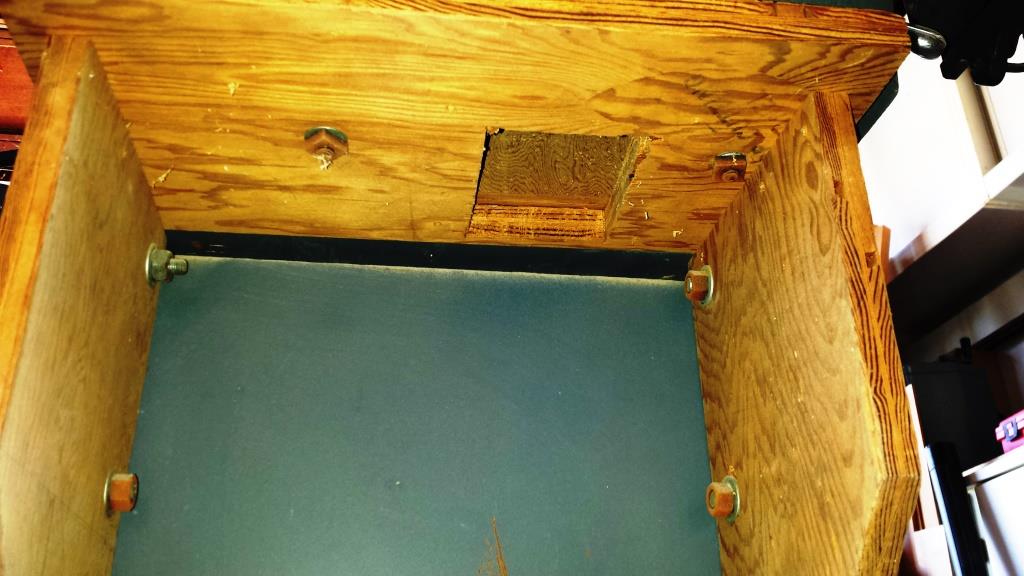

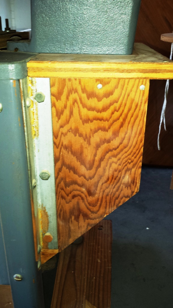

    Adding a side support table onto the side of the table saw base provided a way to hold the jointer and still have access to the drive motor. In addition, a post supports the bearing block for the ½” dia. drive shaft pulley extension. The parts are made from ¾” plywood and 1” right angle cold rolled steel. Everything is glued together and then held with flathead screws and hex head bolts. I improvised a universal coupling by drilling a ½” hole through a section of discarded brass garden hose nozzle and fastened with cotter pins to the jointer and pulley shafts. The improvised universal coupling has worked well over the years but there are better ways to do this with flexible couplings.

    Only one V-belt is used depending on whether the table saw or jointer will be used. The motor shaft extends from the front and rear of the electric motor. There are separate motor pulleys mounted at the front and rear of the motor shaft and separate drive belts to fit the different pulley distances to the table saw and the jointer. The table saw drive belt uses the PowerTwist Plus V-belt (I highly recommend this for ultra smooth cutting) and the jointer belt is the conventional V-belt type.
    The blade tilts in an arc using a worm drive driven with a handle on right side of the cabinet and the blade up-down position is adjusted from the front (this moves in a wide slot in the front as the blade is tilted). The motor tilts with the blade and the angle can exceed 45 degrees.
    The motor is attached at the back on a mounting plate the pivots and allows very easy placement and removal of the pulleys. The weight of the motor is sufficient to keep the pulleys from slipping even when the table saw blade is jammed (extremely rare but it does happen). I found the Freud LU87R009 9-Inch 22 Tooth ATB Thin Kerf Ripping Saw Blade with PermaShield Coating the best all-purpose blade for cabinetmaking work for Rockwell-Delta 9” table saw. The blade does cross cutting as smoothly as it does ripping and hardwood cutting does not even slow down the table saw and absolutely no burning in the saw cuts. I know I publish a lot of articles about machining at this website but I love finish carpentry, cabinetmaking and custom mill work built with this saw and jointer ( e.g., http://www.homemadetools.net/forum/b...0954#post42712).
