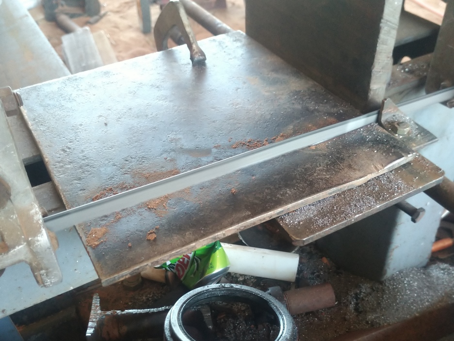

    My mechanic neighbor called me up this afternoon, said he is working on a John Deere grader and needed a way to install the axle bearing and seal. It actually takes 2 special tools to accomplish this 1 is simply a 4" OD tube with a 3 3/4" ID with the ends machined true to each other and 9 1/2" long the other is a plate 3/16 to 1/4" thick split diagonally with a center hole large enough to clear the micro sleeve on the spindle.
    Here is what I made for him

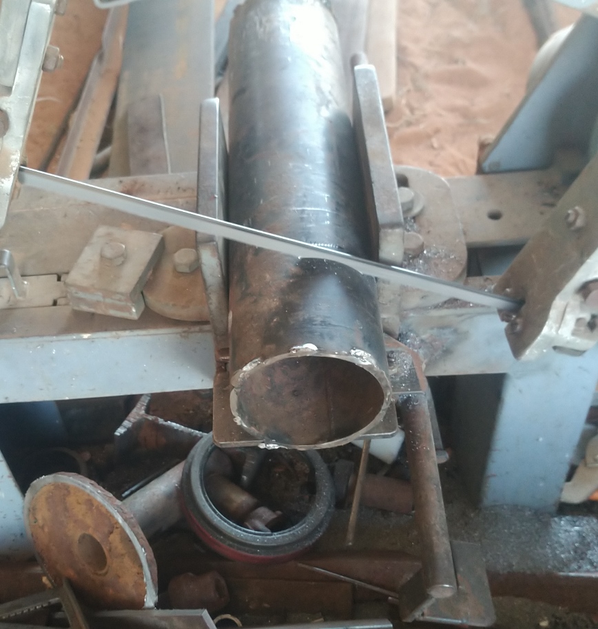

    First I lucked out and found a piece of round tubing the correct OD

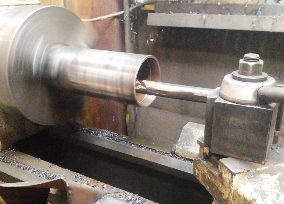

    cut it squared the ends and did a slight cleanup to the bore

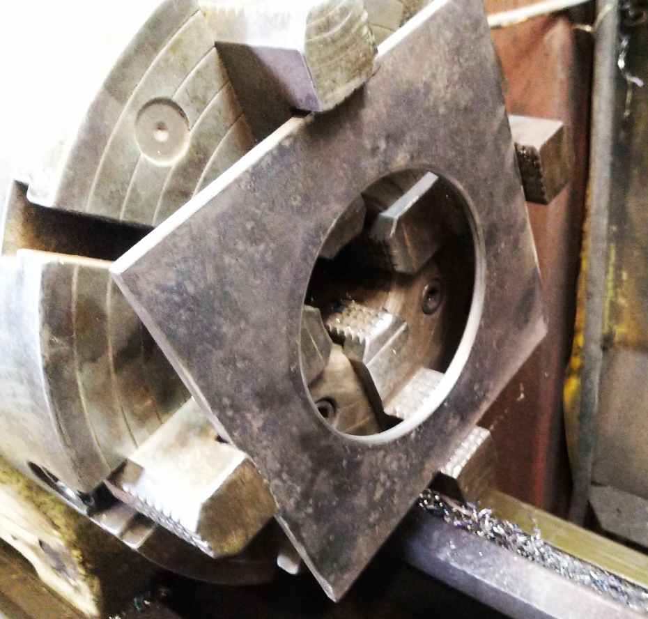

    Next I squared a 1/4" Plate to 8x8"
    John Deere grader axle bearing and seal installation tool-img_20220625_131643jdd.jpg
    Chucked it in the 4 jaw and made the center hole

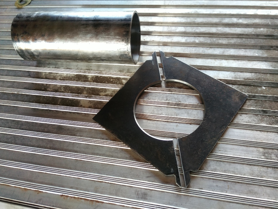

    the finished tool
    John Deere grader axle bearing and seal installation tool-img_20220625_162323jdd.jpg

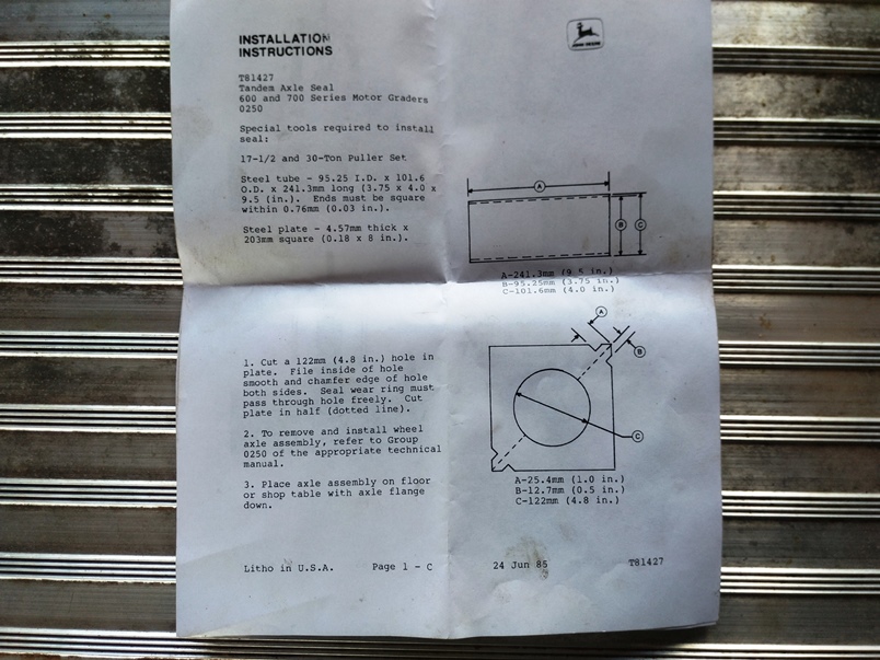

    What the manual says
    John Deere grader axle bearing and seal installation tool-img_20220625_162428jdr.jpg
