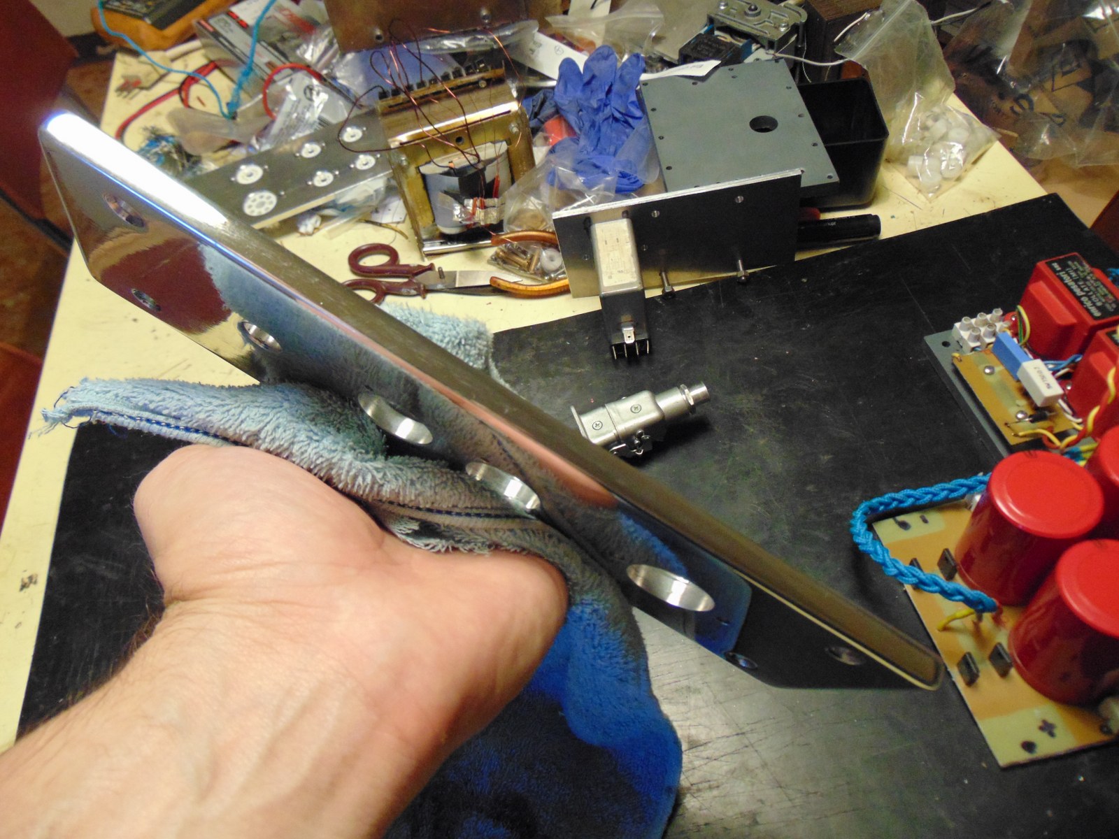

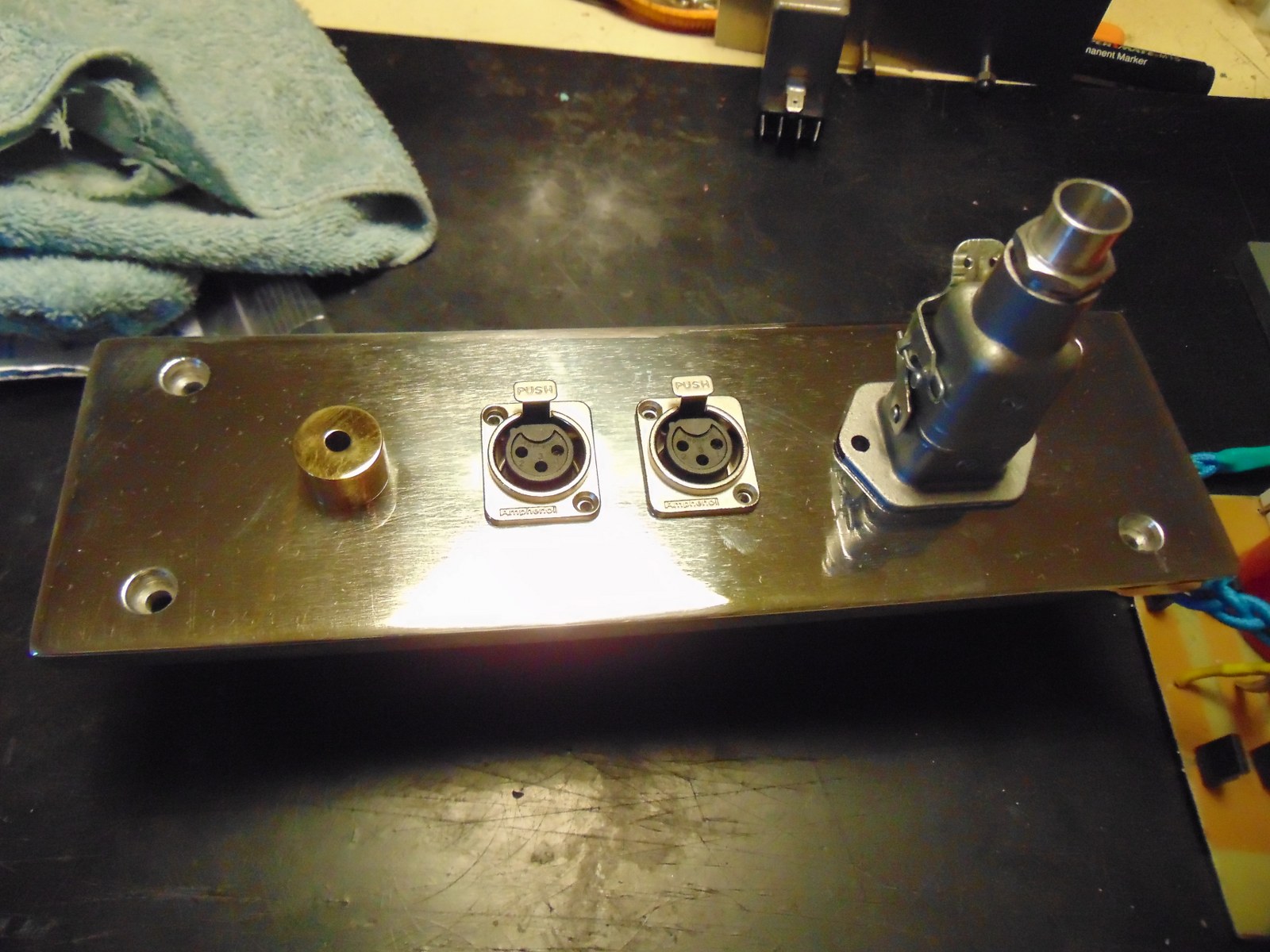

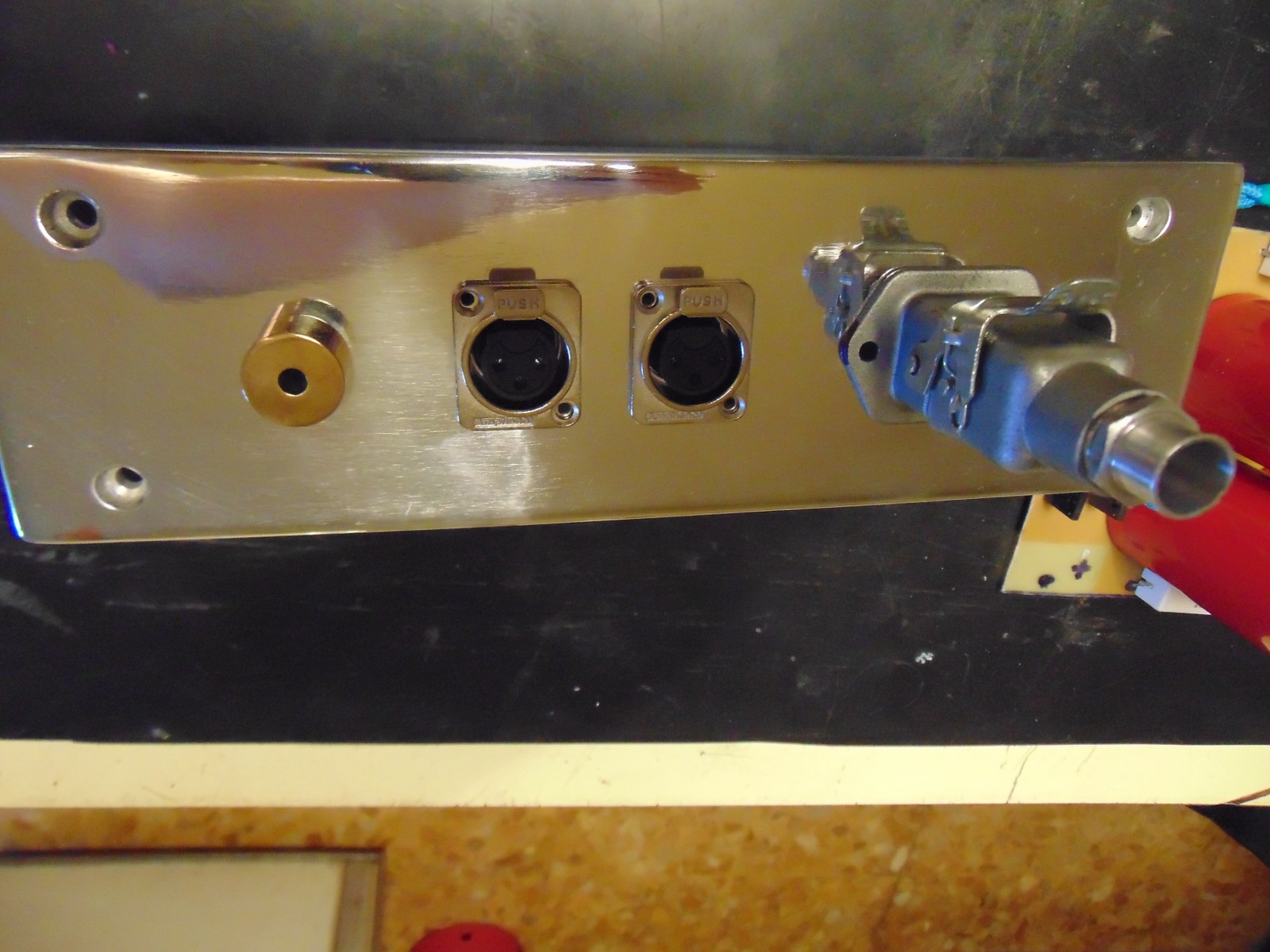

    Hi all!
    I just finished to polish the front panel. This aluminum is very difficult to polish, it's easy to leave marks on the surface.
    It should be shiny enough, I hope, for the jeweling process.
    I will cut round disc of sand paper, different grit, in order to see what's the best grade. I have to prepare a test alu panel (same metal)

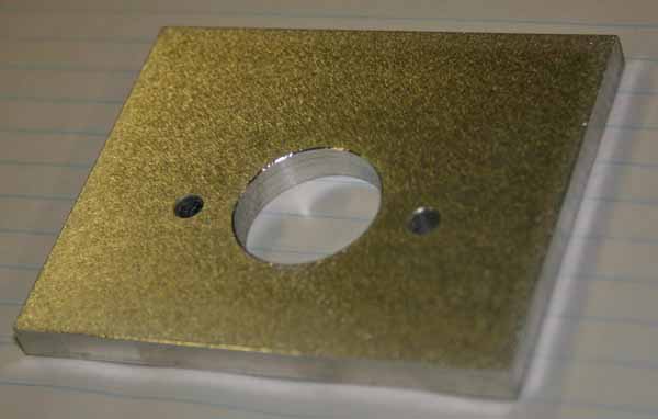

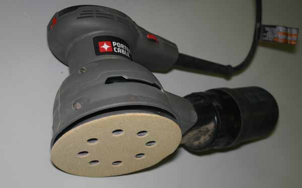

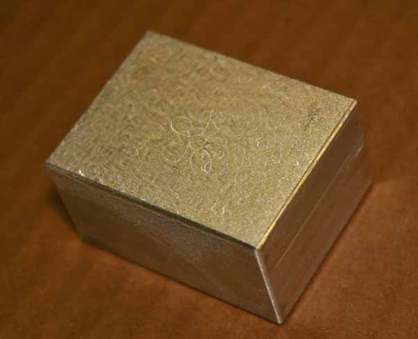

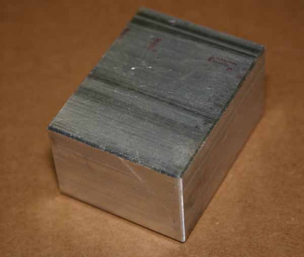

    Something you might want to try if the classic swirl is not a prerequisite. I had some dead easy results on aluminum using a random orbital sander & coarse grit sandpaper (100 grit I think). Photography of metal never seems to look like real life but to describe - its kind of a sugary looking textured pattern like coarse sand blast but not deep & not quite as matt. It easily hides scratches & blemishes. This shows before & after of off-the-mill stock & another scrap part was machined but with scratches. Harder to describe than actually do, but here are some samples.

    Peter that is quite an attractive decorative finish, could be useful for panels etc, I like the hint of a flower in the middle.

    .. I like the hint of a flower in the middle.
    HaHa. That's actually kind of a fluky photographic highlight aberration of the random orbital motion. The surface looks quite equally textured at eye level
