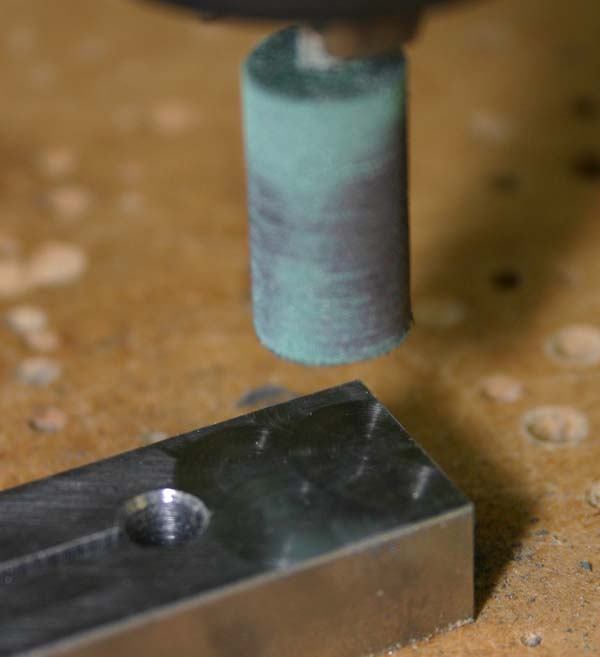

    I bought this set & use it quite often for metal finishing. Very inexpensive compared to Cratex. I'm wondering if the largest cylindrical shape could just be used directly, meaning chucked in a drill press or mill & impart the swirl. I'll try & see if it works & take a picture for you. If you want lager diameters of course you would have to make a mandrel like you were thinking.
    https://www.richontools.com/index.ph...79f0bff49eec1c

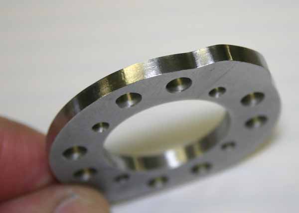

    This is a cam plate for my model radial engine made from A2 tool steel. After grinding a slight radius on the lobe corners, I used the green wheels (in link) to blend the surfaces. It leaves a semi shiny matt finish. Thereafter I use polish with a felt wheel. Both were done with a Dremel tool.
    Also you can get diamond lapping paste very inexpensively from Ebay or Aliexpress. Lapping compound can be aluminum oxide or other abrasives but in your application you don't really have to worry about diamond embedding. They also come in petroleum or water based if that's important. I find the petroleum comes off quit eeasily with alcohol or similar solvent.

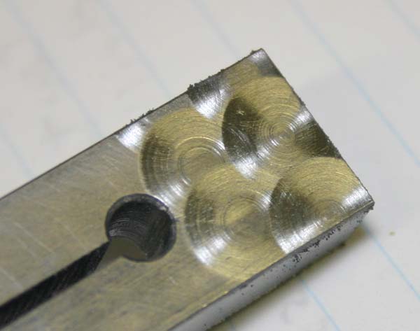

    Here's the green 'rubberized abrasive wheel' results in mild steel spun in a drill press. These are not Cratex, they are offshore brand & I just ran it without dressing the end which is probably why inconsistent rings. Results are so-so. I think the grit is too fine for the look you are after. Somehow I think something like sandpaper on the end of a hard dowel material might be the most controlled way of obtaining whatever degree of micro-scratches in your particular material. If its too faint then coarsen up the paper & visa-versa. I've done this with a Dremel before just free handing over an array of felt pen dots (because the surface was slightly curved). Lapping compound would probably work too, but me thinks rather messy. Good luck & show us what you ultimately decided.
