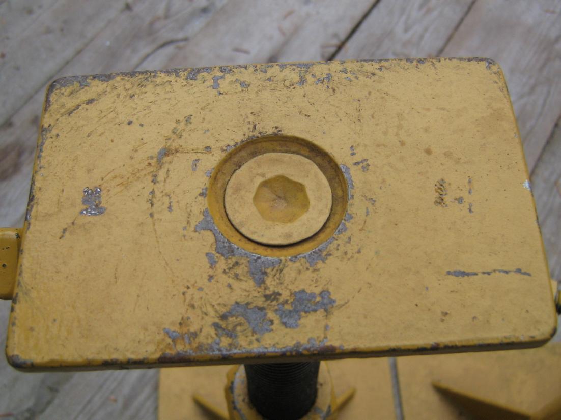

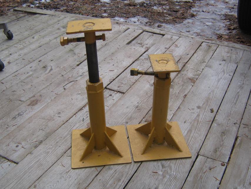

    These jackstands extend from 12" to 17" the base is ⅛" plate measuring 7½" x 7½"
    3/16" gussets support a ¼" wall 2" x 9" pipe, a 1-3/16" x 6" bolt is threaded into a
    1-13/16" nut welded to the pipe, the top plate is ¼" x 3" x 4½" and swivels.
