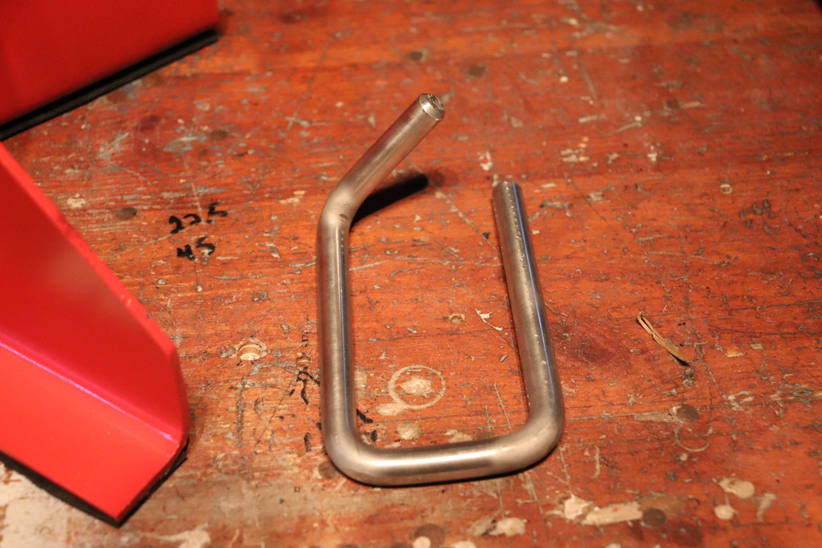

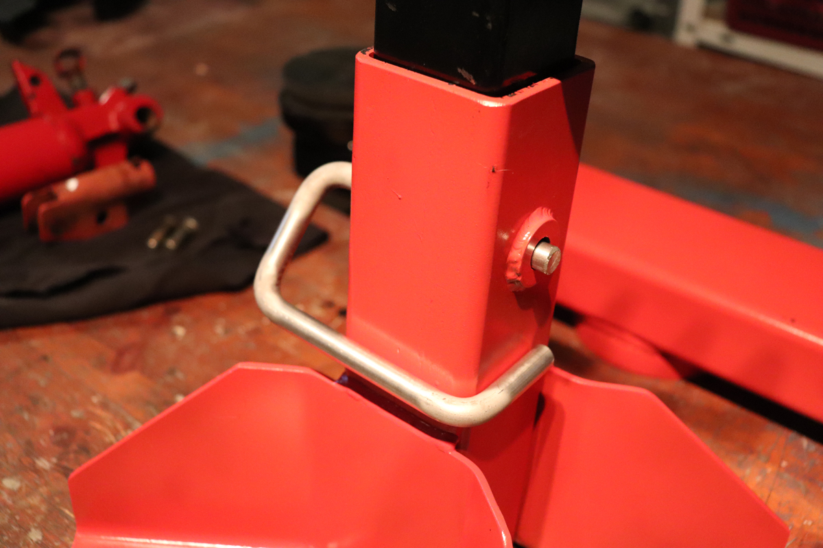

    Safety pins.
    Even that its really difficult to remove pin, when there is weight on it. Personally i think, nearly impossible.
    But, because there is always that small possibility, i made new safety pins to stands.
    Now, its really difficult to even imagine that pins could be removed accidentally when there is weight on the stands.
    You really need to work for it to make it happen.

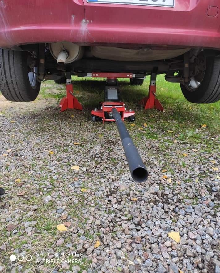

    As mentioned. Support can be used for lifting car from the rear, or front too.
    Easy to adjust widht suitable, lift up and place jack stands under the lifting support, or axle.
