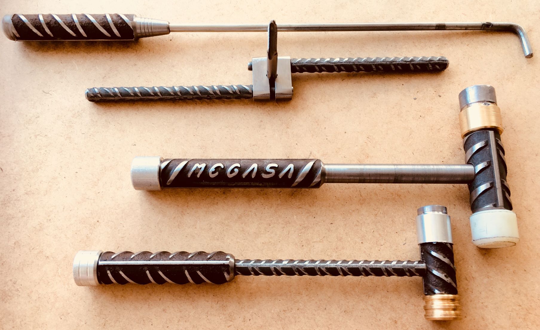

    The Rugged, Resilient and Resourceful brand NEW iSore™ tool series from DIYSwede's Walk-in Closet Machine Shop!
    Timeless design with hot-rolled ergonomical handles for that ultimate FIRM grip,
    all machined to the tightest tolerances from the very best tool steel* to satisfy the high demands for the PRO Hobby Male Machinist!
    iSore™ Tool Series from DIYSwede: The BEST tools your money can't buy!-isore%99-tool-series.jpg
    TOP: "iSore™ The RidNik": "The Rolls Royce" of chip hooks: Tapered handle, hardened tip.
    2nd: "iSore™ The Good Skrew": The "Swiss Army Knife" of Tap Wrenches, that can be dismantled in seconds for storing in your pocket for immediate use.
    With its hardened handles it'll take Metric 1,5 thru 12, as well as ANY Imperial/ Unified and SAE taps under 1/2"!
    3rd:"iSore™ 8" Velvet Clobber": 6 oz mallet with interchangable lead/ brass/ aluminum or Delrin faces.
    Spare face at the handle end, also for that crucial Oomph! into those deep holes, Morse tapers/ spindles.
    Bottom: "iSore™ The Wee Whacker": a 4 oz version of the above, for hammering those tiny pieces in tight spots.
    Materials Fact Sheet:*K500C-Toughened: <0,22% carbon steel, minimum 500MPa upper yield limit at <5% elongation,
    hardened and annealed martensite shell with a pearlite/ ferrite tough core (called Tempcore, Thermex etc).
    Disclaimer: Being a Swedish Cheapskate, I'm in NO way affiliated with the Spanish steel company Megasa,
    nor any other excellent rebar manufacturer of any nationality whatsoever
    - I just happen to collect any foot-long pieces of rebar tossed away anywhere, anytime and of any dimension. So there.
    Inspiration and courage to undertake this endeavor is entirely from Xynudu's groundbreaking achievements within this new field of cheapness machining.

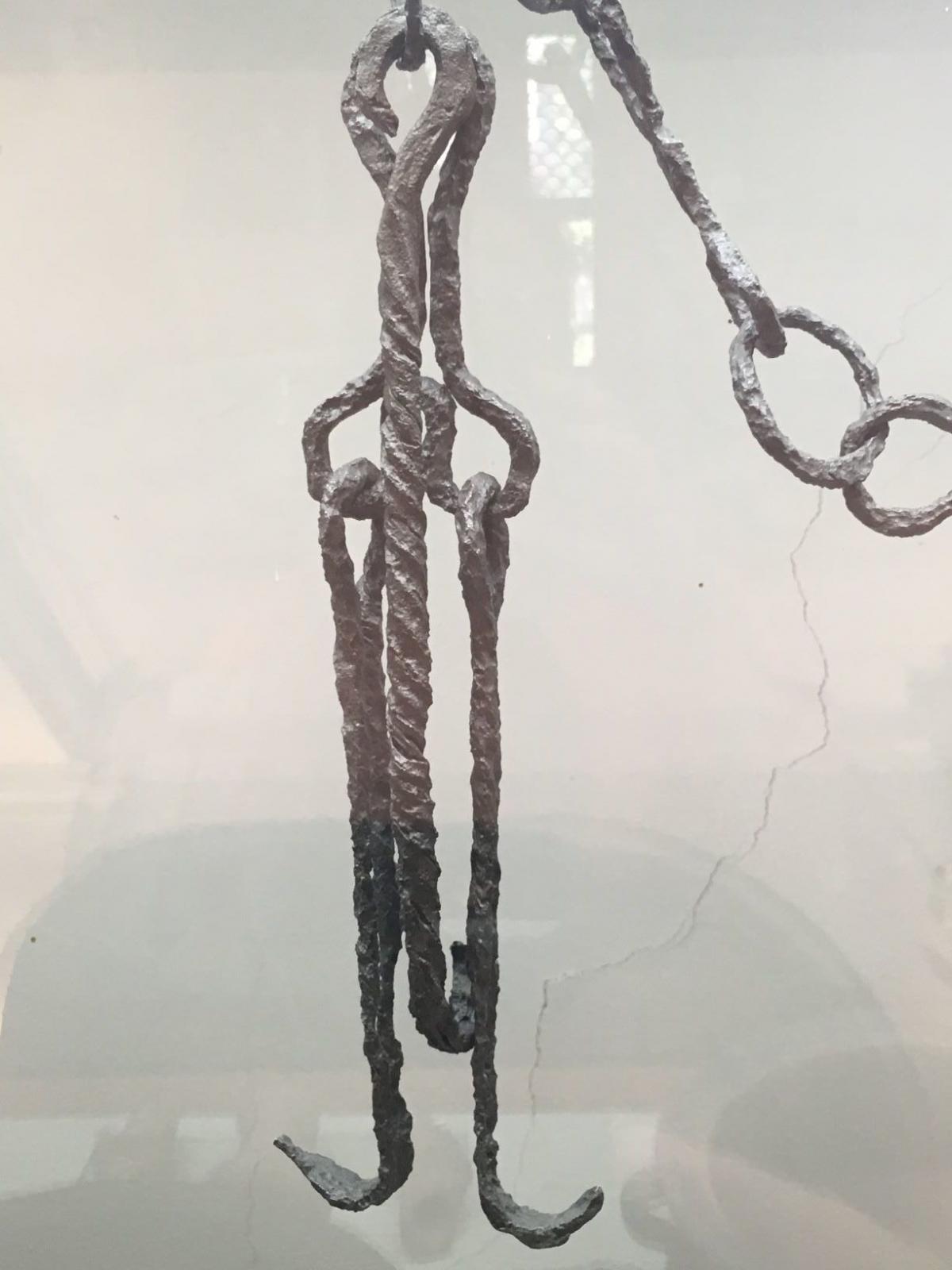

    Making tools from rebar isn't really anything new,
    as could be proved from this exhibit 6, in the Archaeological Museum, in Split, Croatia,
    iSore™ Tool Series from DIYSwede: The BEST tools your money can't buy!-roman.jpg iSore™ Tool Series from DIYSwede: The BEST tools your money can't buy!-roman-2.jpg
    that even the Romans repurposed old rebar, some 22 centuries ago.

    Nice job DIYSwede, thanks for sharing. How did you get the rebar to look so good ? Clean and blue the steel bar then lightly belt sand the outer surface ?
  10. #7
    May 2019
    Stockholm, Sweden...
    634
    417
    Thanked 807 Times in 319 Posts
    DIYSwede's Tools
    Thanks, Bony!
    A: Just centered and turned down the ridges, then belt sanded it for a smooth yet firm grip.
    Only snag is that its cross section is oval rather than round. - never even bothered to blue it -
    I guess the hot roll just assumes a "natural stain" itself over time.
