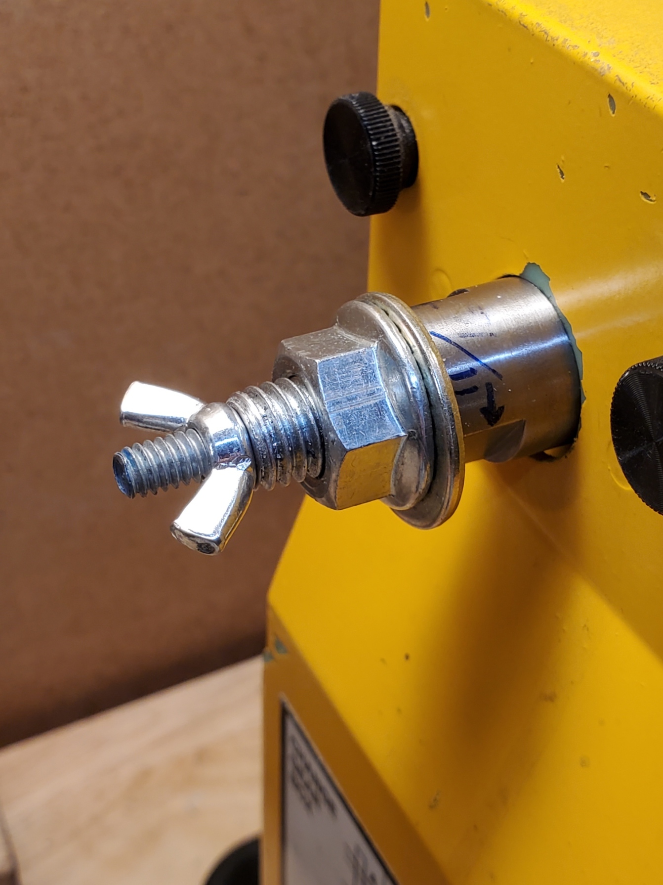

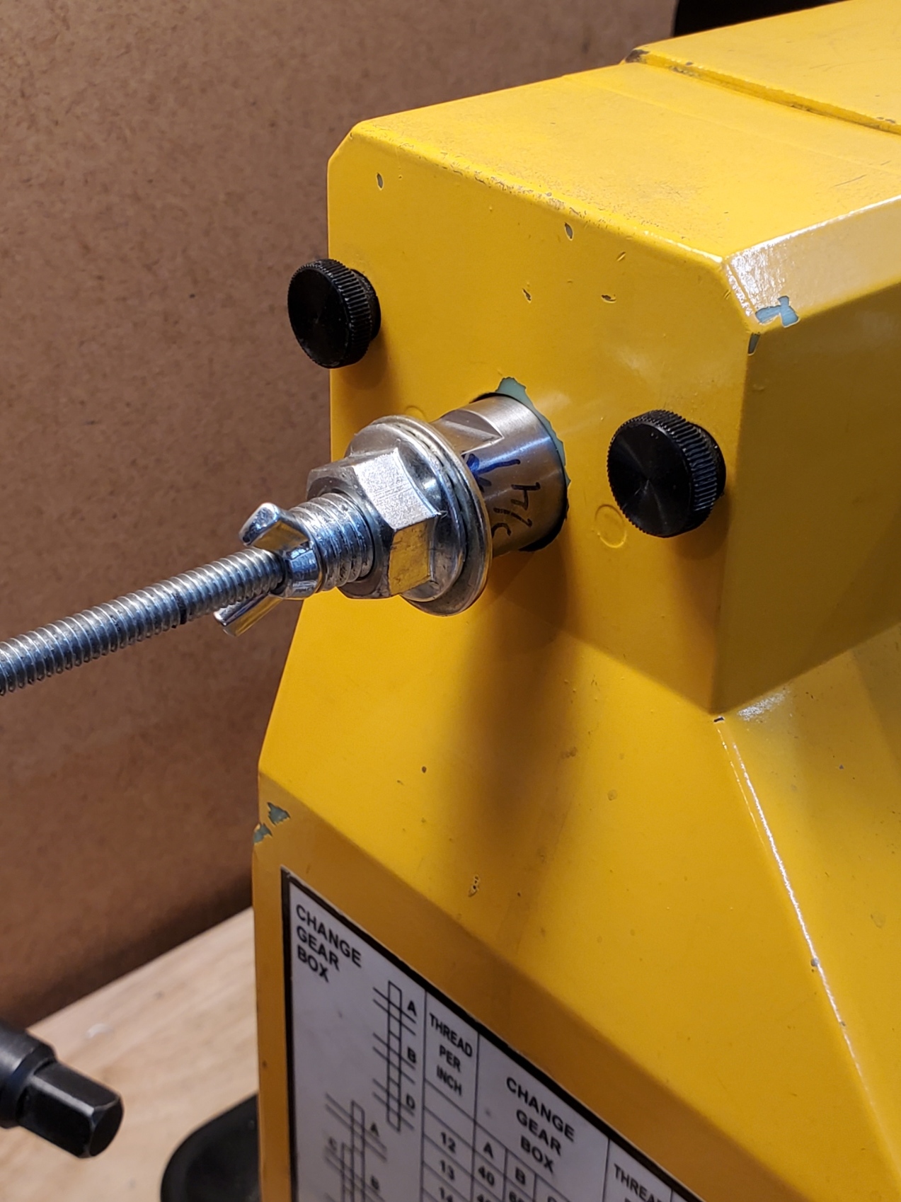

    To install into the lathe... First the draw bar is inserted into the sleeve and held loosely by the washer and flanged nut. The sleeve is inserted into the spindle with the shoulder seated on the end of the spindle, and the nut is tightened to expand and secure the sleeve. Finally, a suitable length of threaded rod is threaded into the draw bar to set the depth, and a wing nut is used as a jam nut to secure the threaded rod position.
    Internal Stock Stop for the Mini Lathe-installed-1.jpg Internal Stock Stop for the Mini Lathe-installed-2.jpg
    Internal Stock Stop for the Mini Lathe-installed-3.jpg Internal Stock Stop for the Mini Lathe-installed-4.jpg

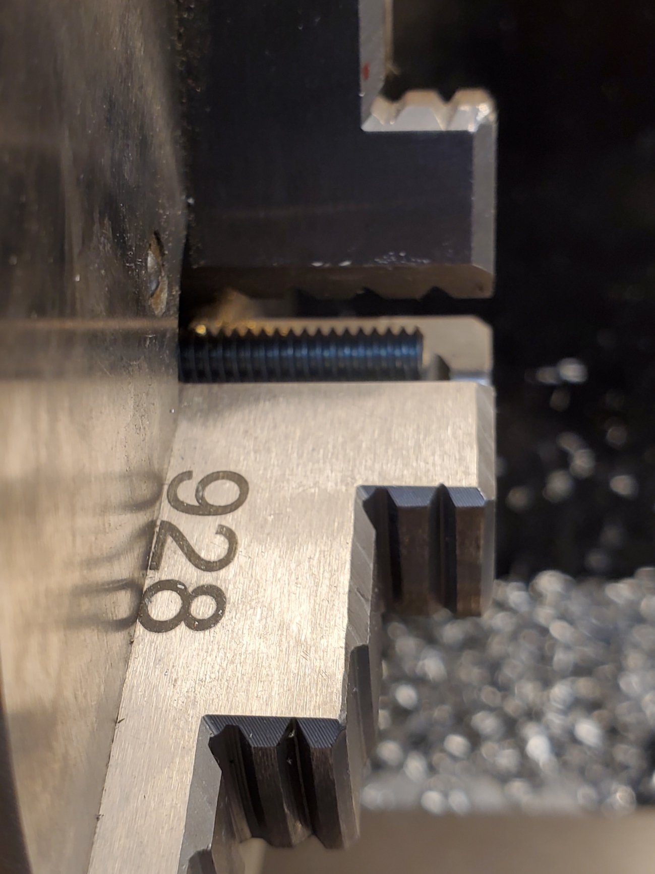

    The stop is balanced well enough that it can be left in place while operating the lathe.
    If a longer piece is being machined, a shorter length of threaded rod can be used so that the exposed portion doesn't whip around as the lathe runs.
    Once set, the stop can be removed and reinstalled later using the shoulder to re-index the stop location. (This assumes that the nut torque is somewhat consistent between the repeated installations, and that the threaded rod is not disturbed, of course.)
