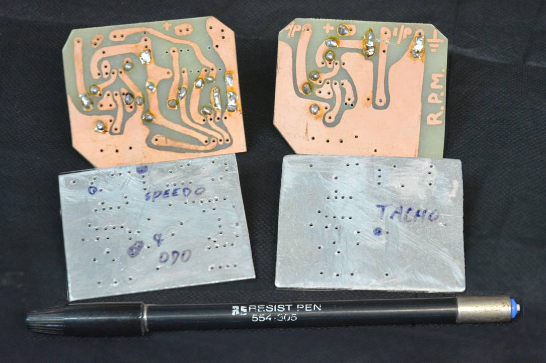

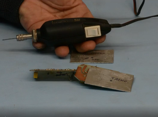

    I used to use pre-perforated board as a guide to drill needed holes into metal drilling jigs which in turn were used to drill unetched PCB. I would then use the holes as a guide to draw the tracks prior to etching.
    An Index System for Hand Drilling Circuit Boards-80s_pcbs.jpg Click for full size.
    Two examples of the drilling jigs and the finished boards.
    I had a tiny high speed drill (much smaller than a Dremel) and the whole operation was manual.
