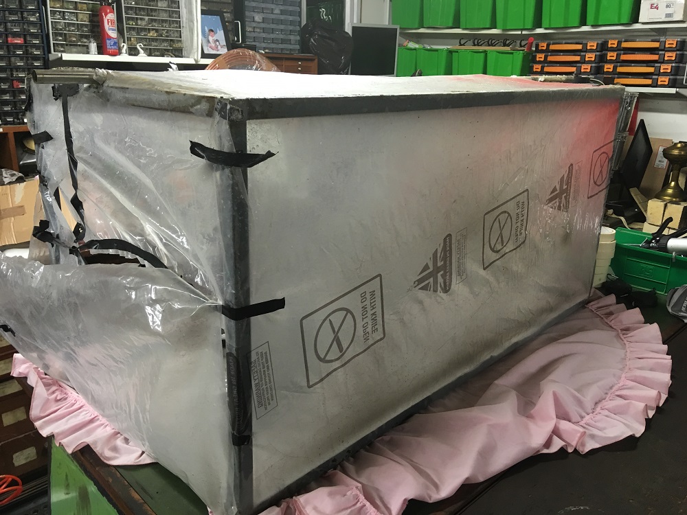

    I have used this spray booth for many years (I use the term spray booth loosely)
    Basically a speedy frame cover in plastic. I did plan on cladding in thin aluminium and putting an extract fan and possibly a integral light. But 10 years later it keeps getting recovered in plastic and kept outside in all weathers when not required in the workshop. The booth is a good size and it does stop over spray covering the workshop.

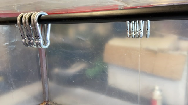

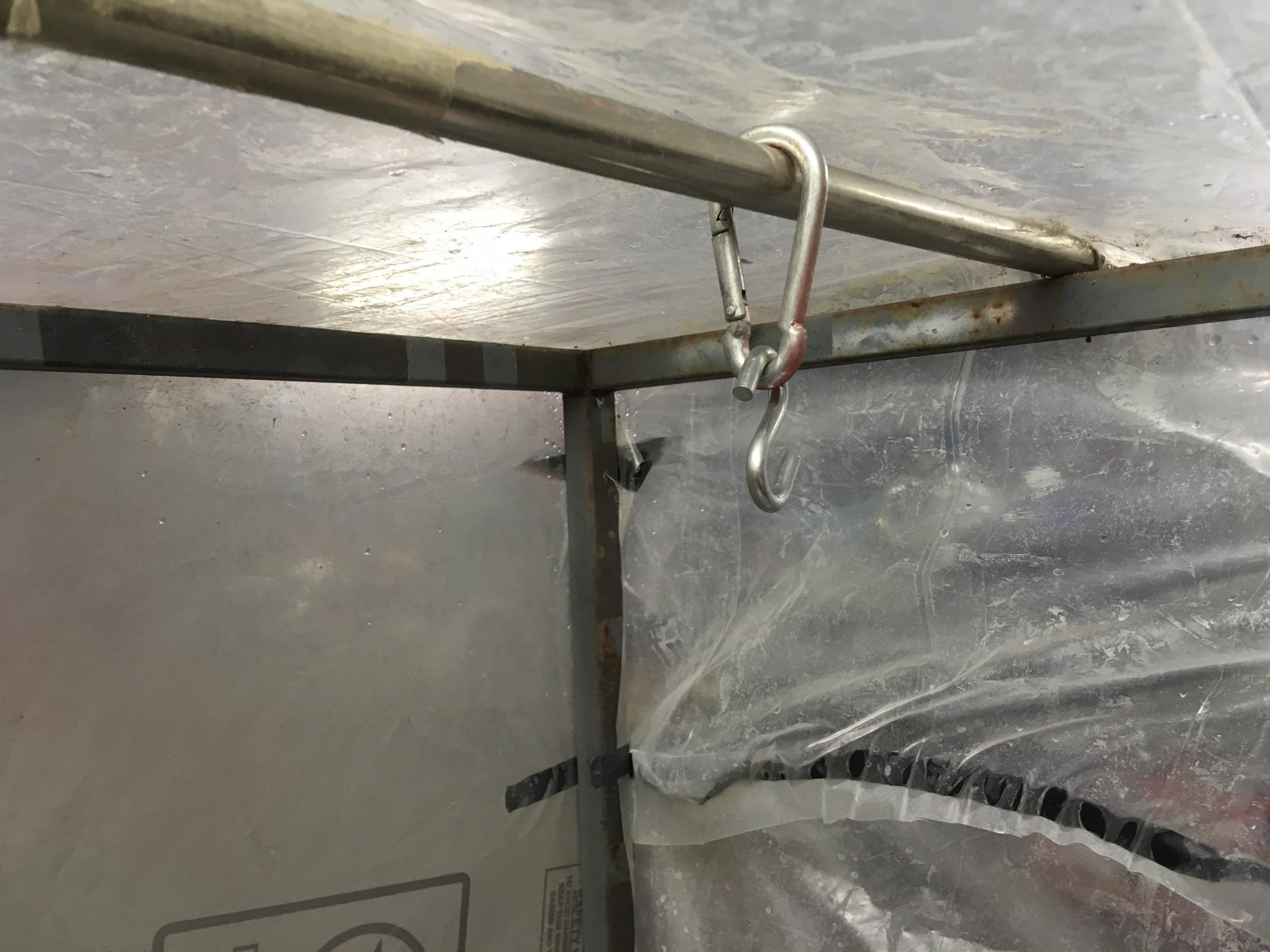

    I also place a tube across the top to hang components which is very convenient from carabiner snap hooks and "S" hooks.

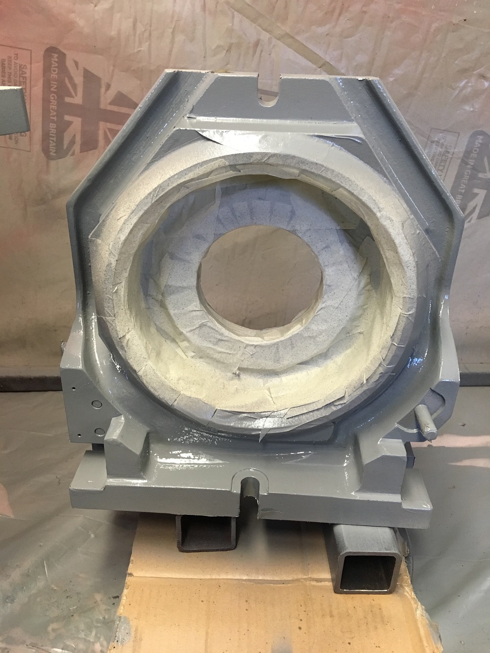

    When painting large heavy items which are to heavy to hang up I use a rotary positioning table in the booth. This enables me to rotate components 360 degrees. The positioning table is positioned under the cardboard to protect it from over spray.

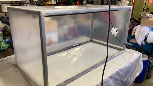

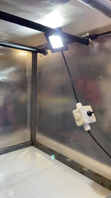

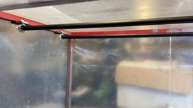

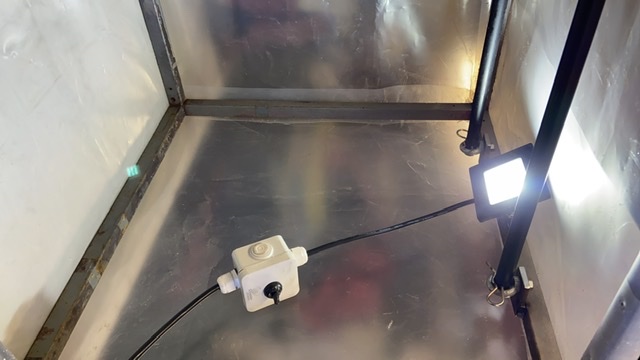

    Slight improvements to spray booth
    Hi All

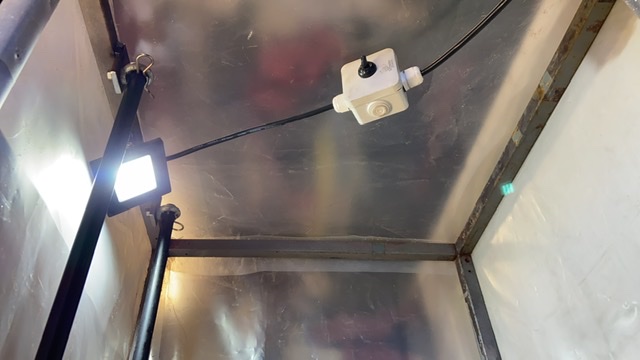

    Today spent some time sorting my poor mans spray booth. I decided to replace the plastic sheeting and pop rivet rather than use gaffer tape. I also welded 4 brackets to support to hanging rails. The portable light also makes a big difference to the booth.
    just need to find a suitable extractor fan.
    All ready to paint the traction engine
    Thank you for viewing

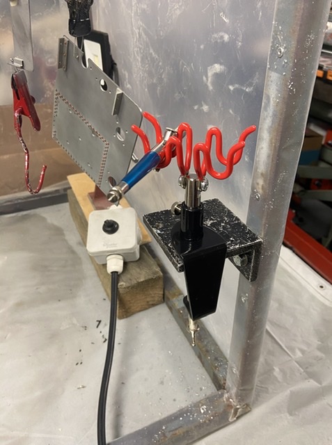

    As time goes on I add little features. This little piece of angle bolted to the side of the frame has made my life so much easier. I am no longer trying to prop up the airbrush every time I want to put it down. It is amazing how a five minute job can save you hours of frustration.
    incomplete scruffy spray booth-8b2e9d86-fed4-4e0a-b876-fcbde0a4ed16.jpeg Aluminium angle bolted to the frame of my ongoing designed spray booth for a airbrush stand
