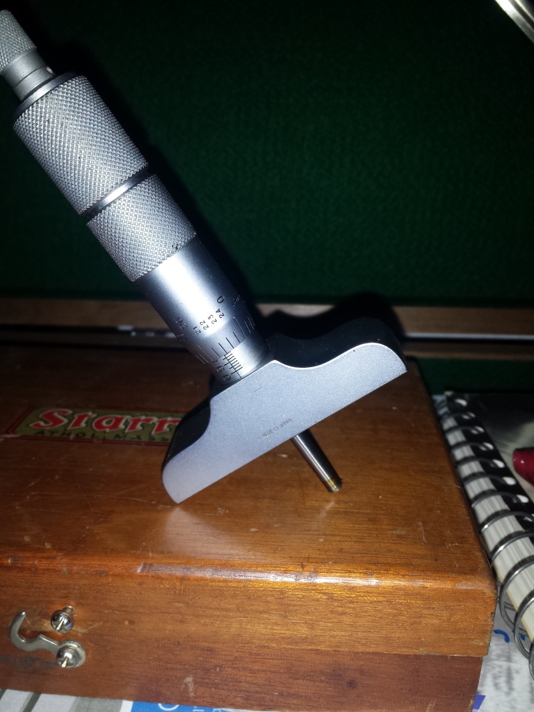

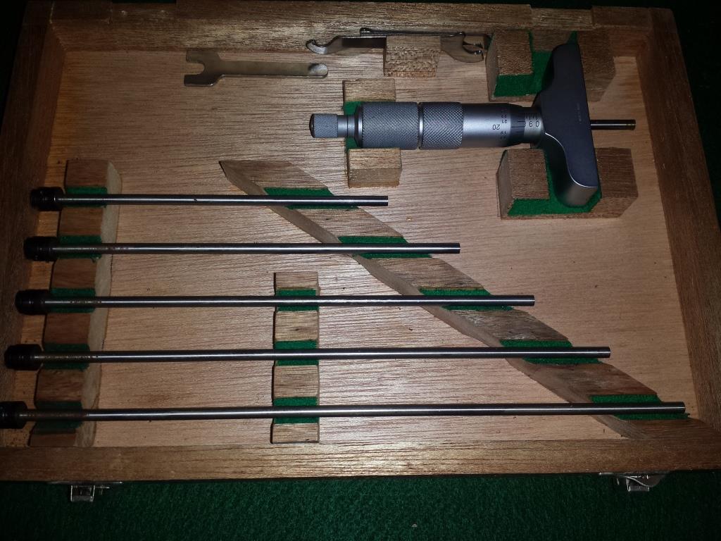

    Marv's idea using a depth mic gives a bit more precision quite easily. Many thanks, Marv

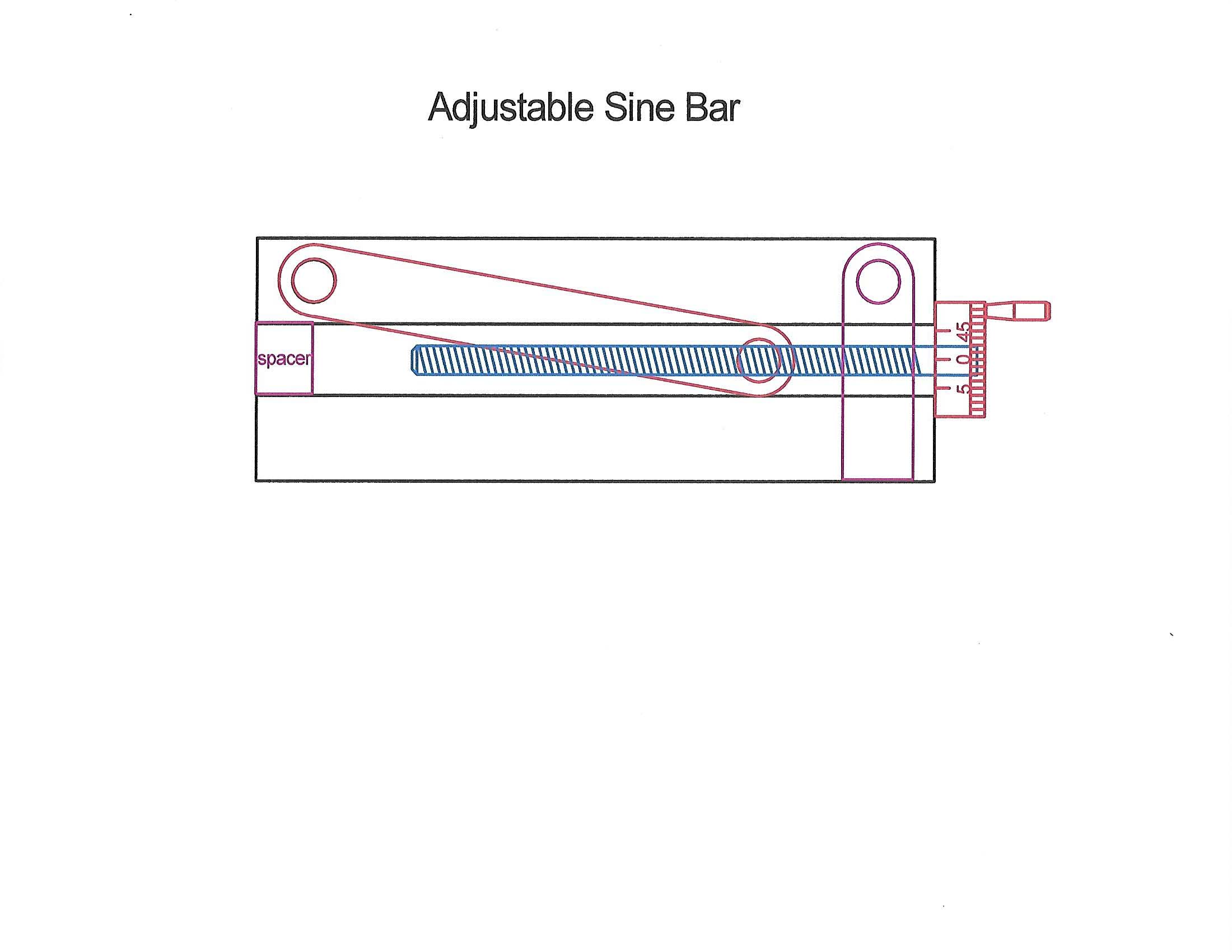

    What do you think about this ? Just a basic design, nothing scientific
    Doug

    Quote Originally Posted by rossbotics View Post
    Doug
Name:	Adjustable Sine Bar.jpg
    That will work.
    I suspect that we never see designs like that in production because the motion of the plate is non-linear relative to the handwheel calibration. That means a table would have to be used to determine the handwheel setting required for a particular angle.
    Still, it has the advantage of being self-contained, not requiring a set of gauge blocks, so easier to store and carry.
