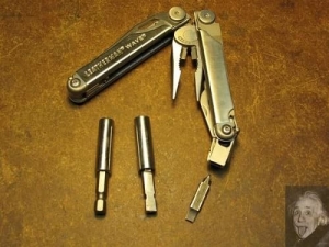

    The Leatherman series of tools are really great. I carry one daily. But, annoyingly, they use a proprietary form of screwdriver bit and the holder for them on the tool will not accept the ubiquitous 1/4" hex bits available everywhere. [I have a Smith & Wesson knockoff of the Leatherman that has a fitting to accept 1/4" hex but, sadly, it doesn't measure up to the Leatherman in other respects.]
    Determined to have my way, I took one of the 1/4" magnetic extension adapters (on the left in the first photo) and ground the tang flat on both sides until it would fit into the Leatherman receptacle. Happily, the necked down portion of the tang provides the same locking action that the proprietary tips have. In addition to accepting standard 1/4" hex bits, it's now magnetic plus it will accept the proprietary bits. The fact that it also provides a bit of standoff from the tool body can be a real bonus in some cases.
    Yes, it's one more thing to weigh down your pocket, but, for me, it's worth the effort.
    I cannot find the article where I read it, but this was done in part to save space, and as you discovered, it's still a 1/4 hex. Acknowledging this deficiency, they do sell an adapter for proper 1/4" bits:
    http://www.amazon.com/Leatherman-931...dp/B0022G72BK/
    but it's nowhere near as cool or cheap as something you make yourself.

    Yes, I'm aware of that. In fact, long after I made the one described, I received one as a gift. But, as you say, DIY not only provides a tool but also gives one a psychological boost. Plus, my version is a lot less expensive.

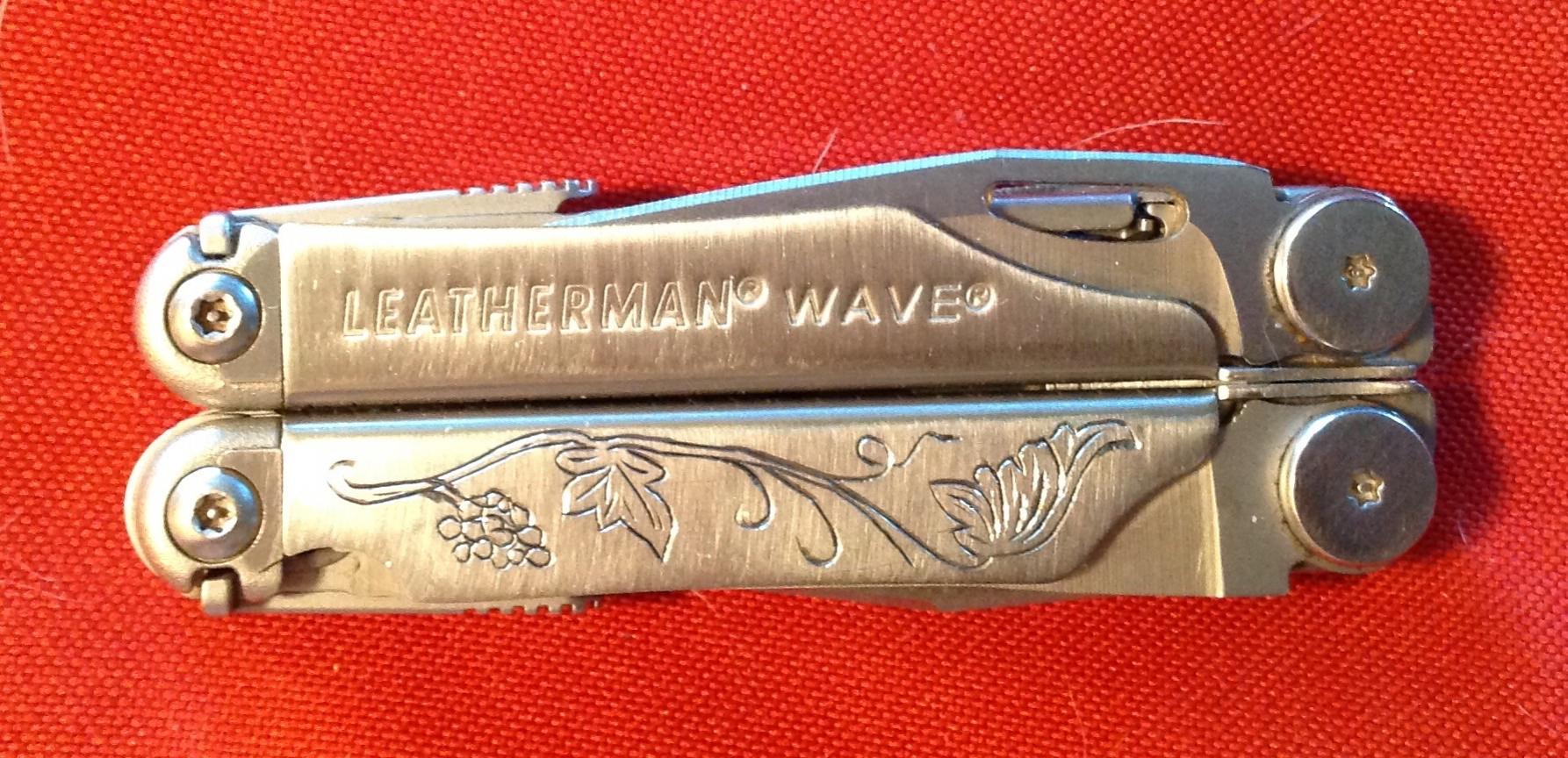

    Yes Marv, thanks for that tip. My Wave is a long time friend. I decorated it a bit... with some crude engraving. Please ignore the little bitty white hairs, I have a rat terrier and she likes to contribute to my photos.

    The engraving looks professional, not crude, to my (admittedly untrained) eye. I have a few engraving tools but they've only ever been used for practical, not esthetic, purposes.

    Thanks Marv. That engraving made me happy when I did it and still does every time I use the Wave. Several years ago I decided to learn engraving and soon confirmed that I'm not an artist. But, I did manage to make myself smile and that's what hobbies are about, IMO.
