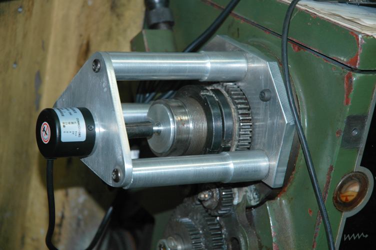

    I hope you document your CNC lathe conversion. I've thought of the same, I'm curious about methods of attaching a shaft encoder to the spindle. Keeping it out of the way for long stock though the spindle hole appears to need some sort of cog belt and timing gears. Then a quality encoder with ball bearing and such is needed, and there must be wear to worry about in all this.
    I sometimes need to fit an encoder for a cam measuring setup but that method does not allow long work pieces.
    Improving a lathe spindle head.-rotary-encoder-01.jpg Click image for full size

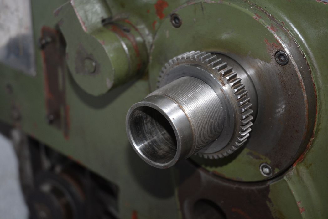

    I am not convinced that you need a small resolution encoder for most lathe operations. Screw cutting is probably the most severe test. The Mach3 CNC control software only accepts one pulse per spindle rev. That sounds too coarse to me, although when screw cutting the tool load over a revolution should be close to constant and so there should not be much speed variation over a revolution. It would be very easy to mount a pickup to get pulses from the spindle gear.
    If Mach3 gets away with a single pulse per rev then the number of pulses from the gear should be pretty good. Then the question is finding compatible software.
