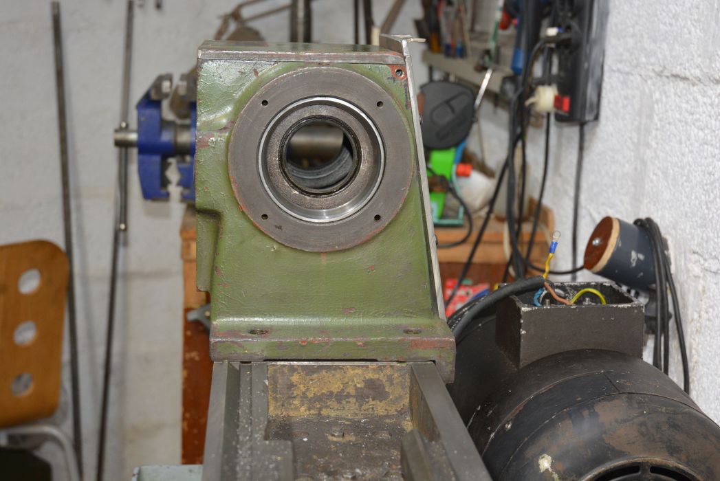

    For some time I have been planning to change the single phase, single speed motor on my lathe for a larger 3 phase motor driven by a VFD (Variable Frequency Drive). The infinitely variable motor speed would allow me to eliminate the multiple pulley speed change system, but there is a problem when running a motor at low speed with a VFD. For a given spindle speed the spindle torque from a motor running at slow speed is less than achieving the same slow speed by mechanical gearing, for a given motor. A way around this problem is to use a vastly oversize motor.
    This post is not about fitting the motor but is about some changes to the lathe head that the motor and drive system enabled me to do. My motivation was to make the head stiffer and less prone to vibration and chatter. Not that I had particular problems in that area but I find it hard to resist when I see a better way of doing something.
    Although I show how I did this on my lathe, a 1240 JET, the ideas are certainly applicable to those lathes which do not have a closed in spindle head.
    Improving a lathe spindle head.-lathegbh005.jpg Improving a lathe spindle head.-lathegbh057.jpg Click images for full size.
    I have prepared a PDF file with all the reasoning and details at Inflicting GBH on a lathe
    I plan to put together a video about this but in the meantime here is a link to a 2 minute video showing some stiffness measuring.
    https://www.dropbox.com/s/7t7ho5x1qq...Lathe.mp4?dl=0
    Warning: The pdf shows images of severe GBH to a lathe and those with extreme sensitivity to mechanical abuse are advised to look away now.

    thanks for the nice words.
    I did think about thermal expansion differences. For the range involved I don't see much of a problem between the steel and CI. The concrete is an unknown quantity and my fingers are crossed as a preventative method. The internal shape will not allow significant movement even if the bond get broken but fretting could cause dust.

    I have a 1976 Jet 10x24 lathe. Very similar head stock construction. I found when I had pulled the spindle many years ago (because of an oil leak), that the oil level sight glass, had a single hole going straight back to the area between the taper bearing cup, and the seal (annulus). If the level dropped below this hole, the sight glass indicated there was oil, but the bearing was dry. I modified my head stock by hand drilling a 1/8" hole from the bottom of the oil sight glass reservoir to the bottom of this bearing cup and seal annulus space (both front and rear bearings). I do see now when it runs that the bearing pulls oil in from the reservoir, and shows a low level, but returns when the spindle is stopped.
    I too have installed a 3phase motor on my lathe, and a VFD, but still use the belts. I did change the standard v-belts with the segmented type, which greatly reduced vibration and noise.
    This lathe was originally on a wood bench, and then a sheet metal stand. I could never do parting operations as it would go into a harmonic oscillation of the headstock and ways. I purchased a 2 inch slab of steel to bolt the lathe onto. I put that slab on my Wells-Index vertical mill, and faced the hot rolled slag off. Then drill and tapped the 6 mounting holes that mate with the mounting ears on the lathe way casting. This fixed the rigidity of the lathe to where I have no more issues with cutoff operations.
    I was preparing a post on this very topic. What a crazy design feature that was, I wonder how many other lathe models have the same problem. The degree of incompetence that exists in some design offices never ceases to amaze me.
