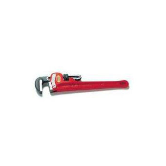

    Well I knew what nhengineer meant by "a big MF pipe wrench", but google seems to think it's a combo open end/closed end wrench https://www.jensentools.com/images/p...01_s500_p1.jpg apparently because Proto has a -MF- in the model designation....

    Most everyone knows what an "MF" is.

    The cylinder is really screwed tight into the base. This trick was shown to me by a old bottle jack rebuilder (my dad). With the jack base securely locked in you best, floor mounted vice, put the ram and ram cup back in, almost all the way down to the bottom. Get you BIGGEST pipe wrench and slide a long pipe down the handle. Grab the cylinder as close to the location of the ram & cup as you can. Grit you teeth and unscrew the cylinder - it will usually give without collapsing.

    I'm curious what GOOGLE thinks a "big MF pipe wrench" is. Around here (central NH, USA) the "F" part is an expletive and the "M" part stands for mother. It looks like this Attachment 20494 only the handle is 48" long.
    Here's the WEB page. https://www.whitecap.com/shop/wc/p/r...iABEgICk_D_BwE
