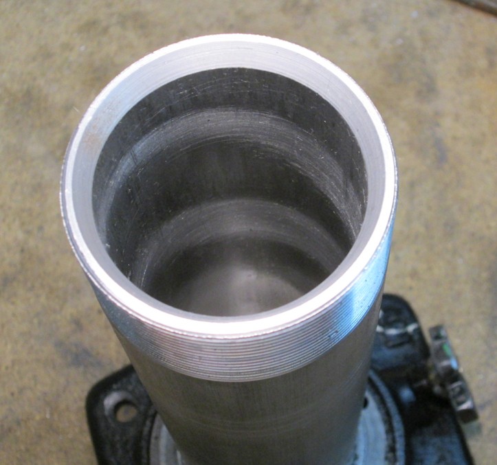

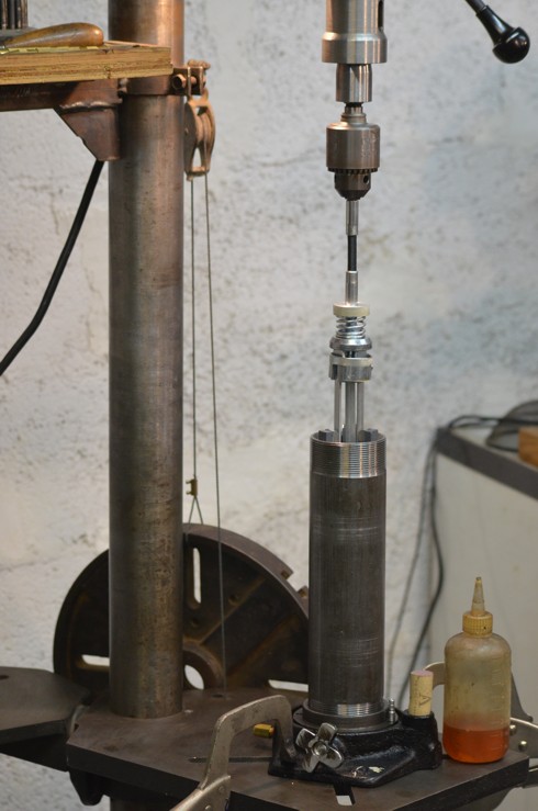

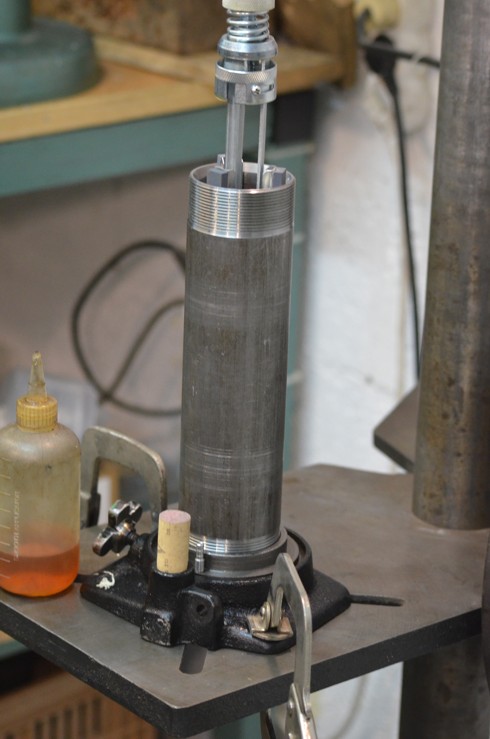

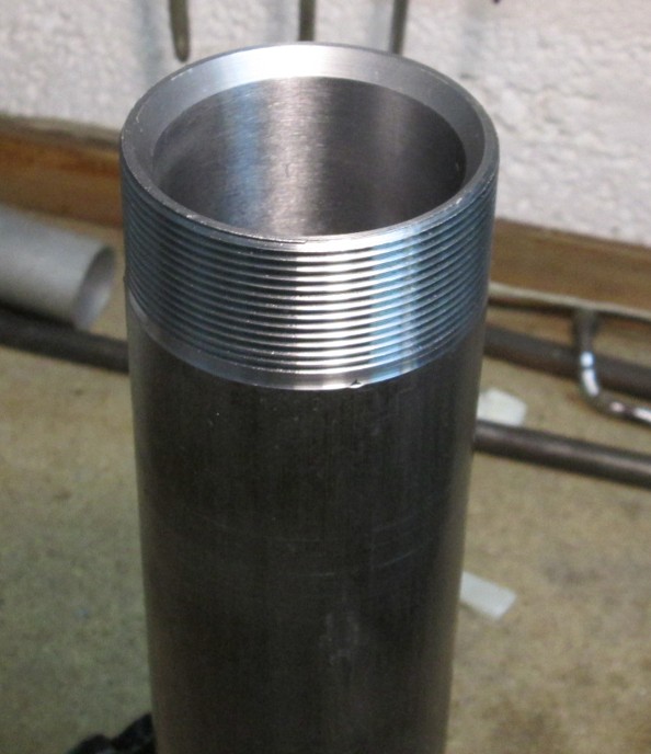

    Maybe you misunderstood my original post. I have no problem with the main piston seal nor creep. Certainly not since I honed the cylinder. There was a leak from the ram wiper O-ring seal which made a mess because the jack is mounted upside down and so the whole of the reservoir oil and the header tank was acting on it. It couldn't have happened with a right way up jack.
    Anyway I have now removed the outer cover and I feed and drain directly into a low mounted reservoir, so if anything leaks the maximum quantity is only the tiny amount in the O-ring groove above the O-ring, only a couple of ml at most. I'll make a separate post describing the current configuration.
