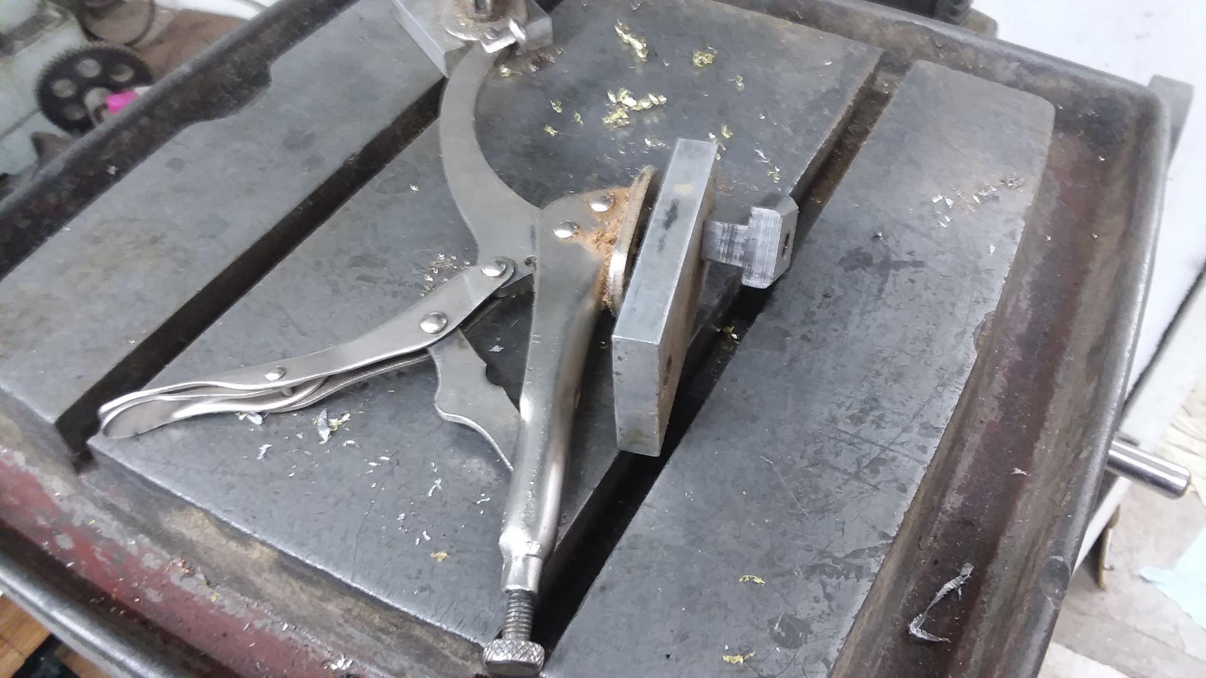

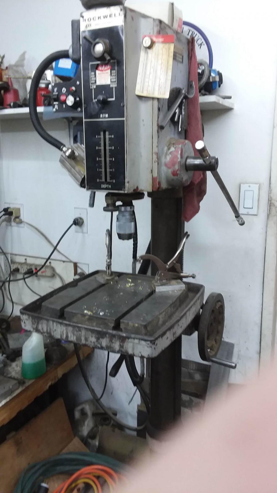

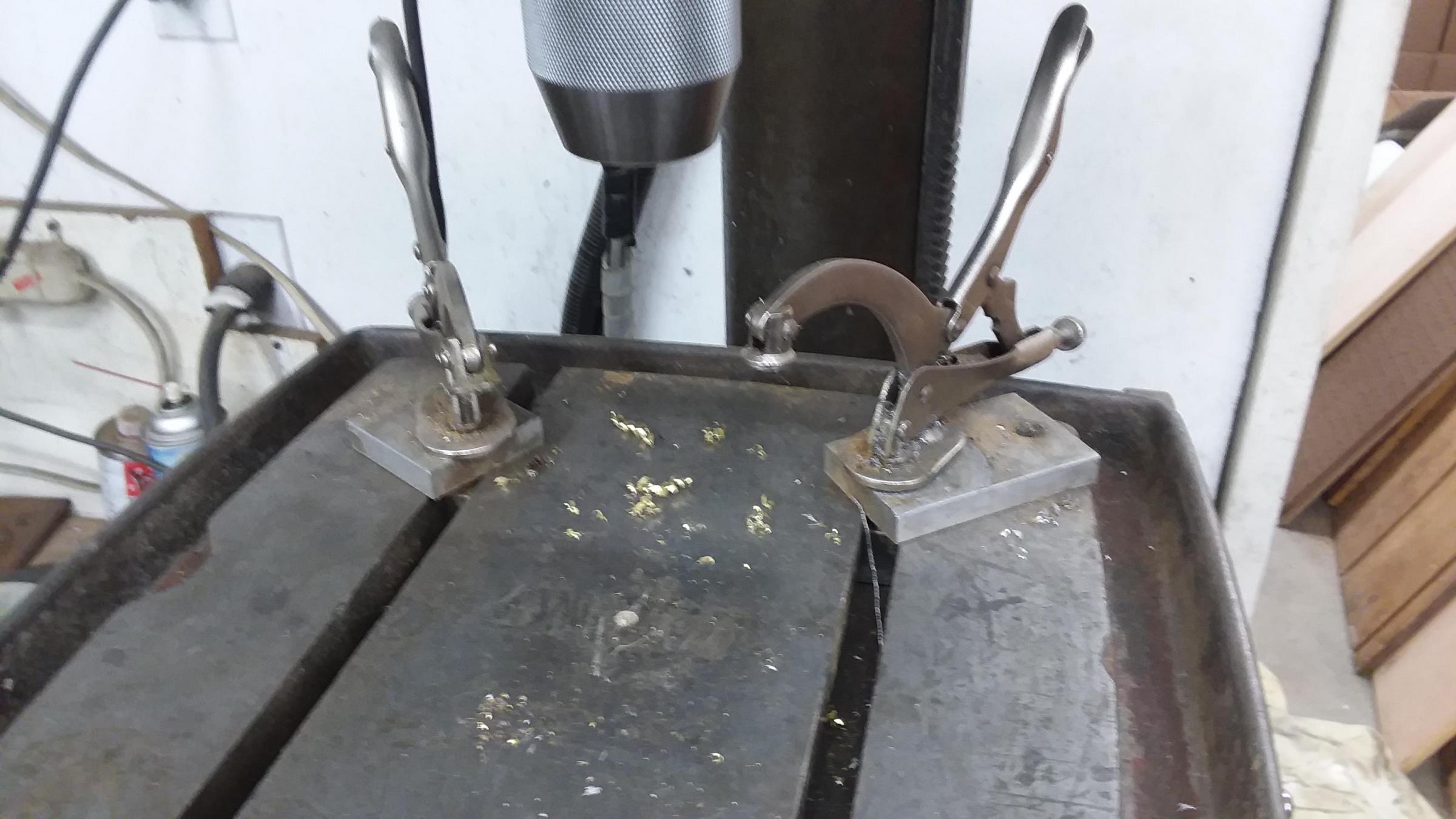

    I have T slots in my drill press so I modified the clamps to fit. Instead of cutting the threaded part down I added spacers. I use the screw adjuster for fine adjustments and just tighten or loosen the clamps in the T nut for coarse adjustment.
    Improving the Harbor Freight Drill Press Locking Clamp-20190124_112204.jpg Improving the Harbor Freight Drill Press Locking Clamp-20190124_112149.jpg Improving the Harbor Freight Drill Press Locking Clamp-20190124_112138.jpg

    I always put a bolt or clamp on the side of my work so if there is a jam, the work cannot spin. I have two of those hf clamps and they work fine. I also have other clamps. Got a dp and all that because I almost rebroke my wrist free drilling some metal. Now I don't have to worry.

    Sleykin, great idea, thanks.
