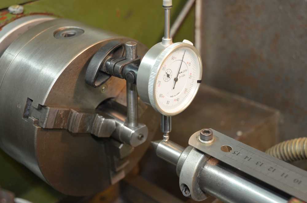

    I had a precision job coming up which needed the tailstock to be well centred. My tailstock has always been a pain in the neck to align. Tightening the cam lock would always screw up the alignment and of course I couldn't make the adjustments with the cam lock tight. On lathes that I have had in the past I modified the tailstock to help with this problem. Today I decided to do the same with my current machine.
    I made a video as I worked and the best way to get an idea is to watch the video
    It didn't take long to do and the alignment was considerably easier. I will follow up this post and video with another discussing the actual alignment.
    There are other tool making videos on my channel at
    Motochassis channel
    Last edited by tonyfoale; Apr 4, 2019 at 03:34 PM. Reason: Youtube channel playlist added.

    a lot of people dont uderstand that the center may be in the right position for center but not realy moving the right direction to keep it there through the full trevel of the tailstock quill....or what ever it's called. it may be centered at the point hear or there but go up down or sideways or both when screwed in or out. these china lathes that are wacked with a chizzell to get close and....skeery!!!at best.and some rock... I was going to set mine up in my mill and square it up and machine it...but them I found with this 9x20 lathe...it wont help all that much, as the bed has oh so much flex in it.. I wish I had a 24" long x8" wide cast iron plate that I could use for a base and flip the bed over and mill it square& flat on the pads and bolt it good and tight so the flex is...almost eliminated... do the head stock too!!!but a better lathe would be better...perhaps someday if Im still screwing with this stuff. keep up the great work tony!!! and keep those ideas coming!!!

    Locking the slide to base this way is a fine, secure method, and Tony's solution could be accomplished by most anyone. Great presentation, Tony! I understand that some have few occurrences of taper turning.
    My suggestion for those who may taper more would exchange cap screws for combination thread studs and nuts, making those fasteners endure the wear, instead of gray iron. Either way gray iron isn't suited to fine threads; proper studs will be threaded coarse on one end.
    You are quite right on this point. It is very easy to clock that and I would advise anyone to do it. A way around that problem when you want it for turning between centres is simply to check and set your alignment with the quill close to the planned 'in-use' position and locate the tailstock at the planned 'in-use' position also. of course this does not fix that sort of problem when drilling but in most cases that is less critical.
    My lathe has hardened ways and there is imperceptible wear on those but the base of the tailstock is worn thus lowering the centre, and I have shimmed that.
