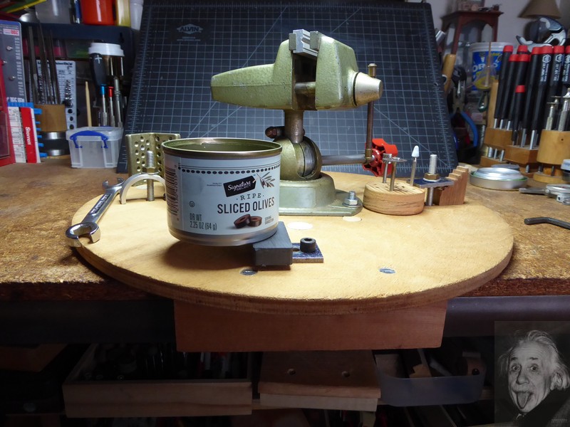

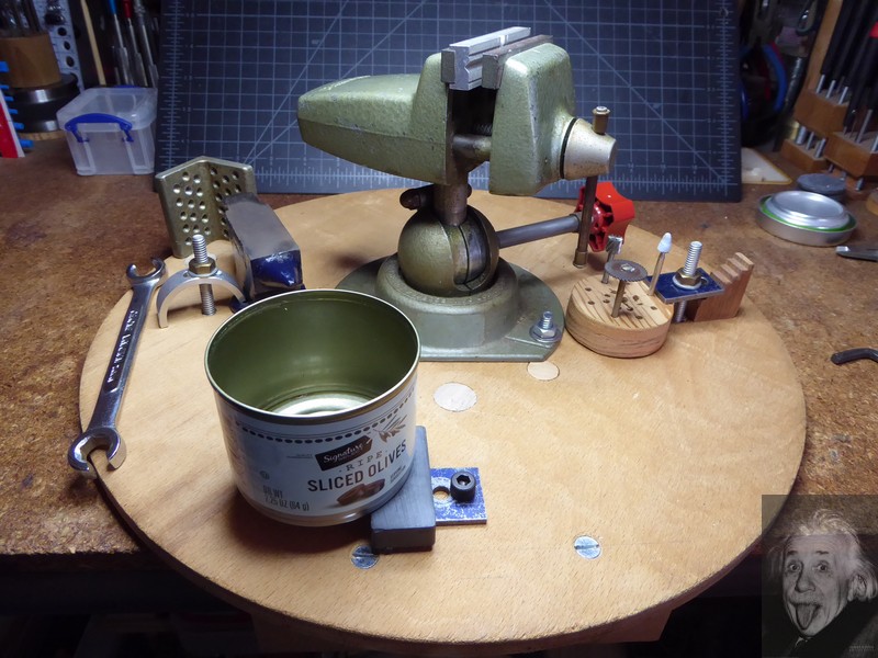

    I discussed attaching my Panavise to my bench hook. This offered any advantage the value of which I'm only now coming to fully appreciate, to wit...
    The bench edge clamp supplied with the base puts the Panavise too close to the edge of the bench. There is no support for one's forearms so it's difficult to hold the hands steadily enough to do fine work. By moving the Panavise back from the edge by use of the bench hook, the forearms are supported and steadier work is the result. In addition, the hook can be simply dropped in place when needed, whereas the supplied clamp requires manipulation; this becomes an important distinction when working on a small (or cluttered) bench when space for the next operation must be frequently cleared.
    Nice as it is, the Panavise needs to be detached to use the bench hook for more conventional purposes such as chiseling and sanding. The constant on/off cycle got to be irritating so I decided that the Panavise needed its very own bench hook.
    I happened to have a 3/8" plywood circle that was once part of a cable reel. It had a bunch of holes so I filled those with dowel slices and added a substantial hook (visible in second photo), and then installed the Panavise base with countersunk bolts from below. Then I installed four 1/4-20 T-nuts (the type for use in wood) around the vise to provide metal threads for bolting down various accessories (as shown in the first photo).
    At the 9 o'clock position a small anvil is clamped while at 3 o'clock a holder for various Foredom points is situated. At 6 o'clock a steel square is bolted so a magnet can be held. In turn, the magnet can hold a small recycled tin can. This is useful for paint thinner or just as a catchall for whatever. Not seen in the photos is a holder for a soldering iron and wiper sponge.
    The T-nuts provide another level of utility to what is already a very useful design.
    The take-away from all this is to possibly improve your productivity by mounting tools to bench hooks and fitting said hooks with the means for attaching accessories to the mounted tool.

    Love it. But for me, i may need the base circle to be able to turn.
    Well, for my use the ability to turn isn't important because the vise base can be rotated full circle in azimuth and locked while the hook remains fixed in place.
    A base that can rotate would not be useful for any work that required applying some force to the workpiece since that might make the workpiece turn away from you. [Imagine sawing or filing a part attached to a lazy susan.] If made to turn, some form of brake would be essential and that would complicate the construction and the rigidity of the hook.
    A better solution would be to make the base/hook stationary as mine is and add a workpiece holder that can be rotated and locked in position.

    Ok, i see what you mean. Im a paraplegic using a wheelchair so my reach is not so great. But moving the items makes better sense.
    I'm sorry to hear of your disability.
    My design purposely places the vise back from the front edge of the bench so that I can rest my forearms on the bench to steady them while doing fine work on stuff held in the vise.
    You may want to think about mounting a vise on the hook closer to the edge of the bench for easy access. In your design allow for easy re-placement of the vise if the first placement doesn't work as you wish.
    Perhaps you would be happier with a vise base that clamps directly to the edge of the table. Panavise sells such a device (I have one) but they're vastly overpriced...
    https://www.panavise.com/index.html?...eqskudatarq=19
    It wouldn't be difficult to fabricate the same sort of thing from wood and a C-clamp.
    Bonus hint: If you make a bench hook, think about adding utility to the design by extending the front edge out over the edge of the workbench. Cut a birdsmouth into it and you have a handy place to use a fret saw for intricate cutting. This may require clamping the hook to the bench. My recommendation for a clamp is this HF model...
