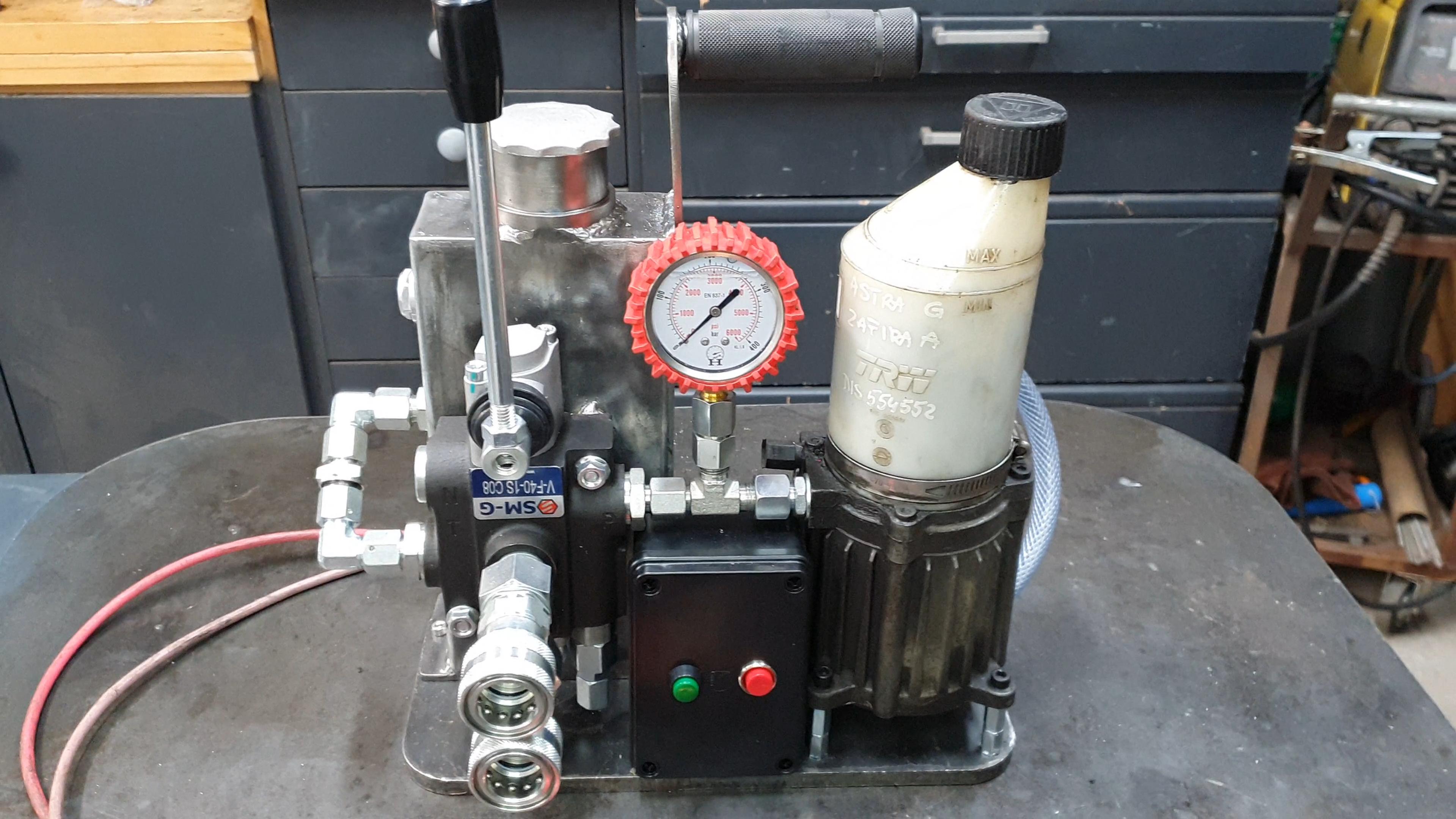

    This time I built a hydraulic unit that will power my future projects.

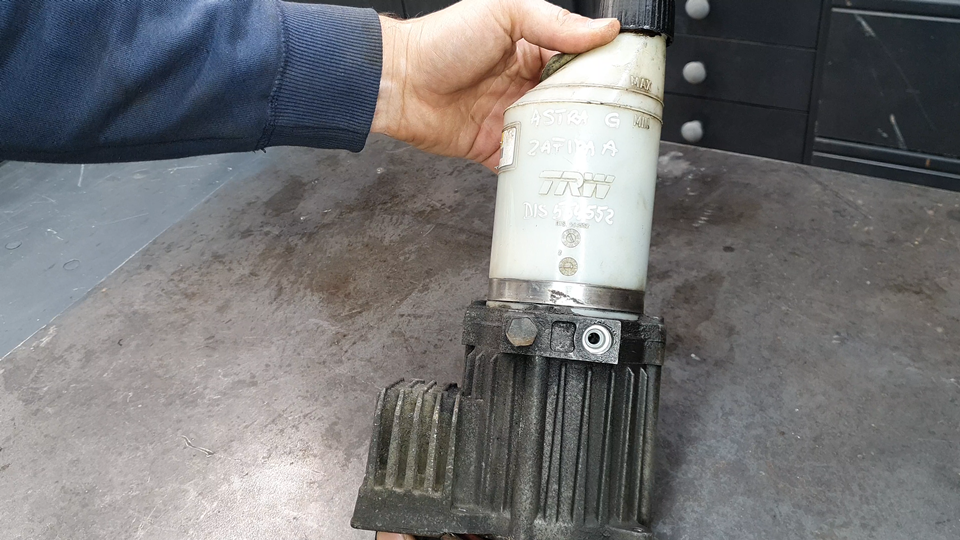

    The unit is powered by a power steering pump from an Opel Zafira, but the same pump is also found in the Astra.

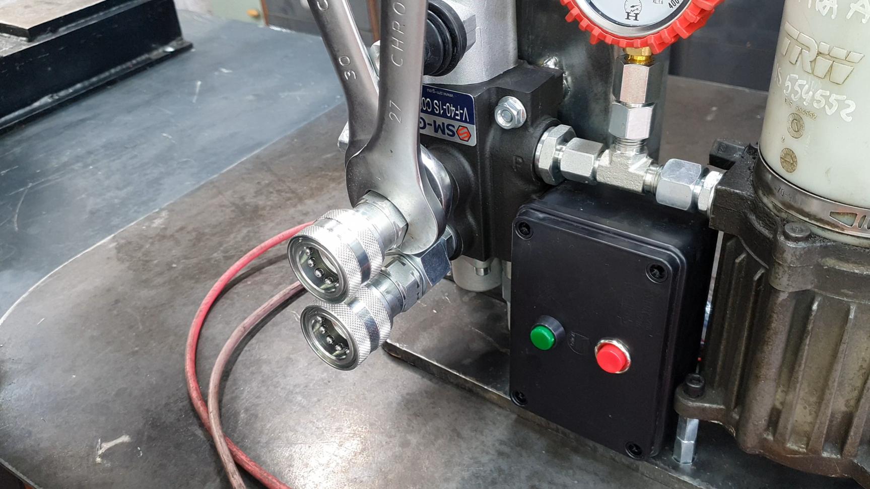

    I screwed EURO quick connectors directly into the distributor, which significantly improves the comfort of use.

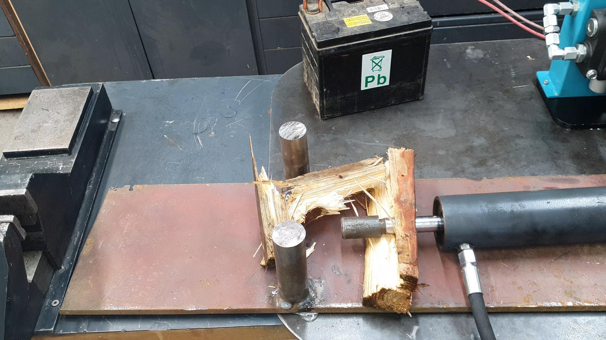

    The pressure that the manometer showed while bending the flat bar was 100 bar, but I think that this pump will be able to reach 150 bar.
