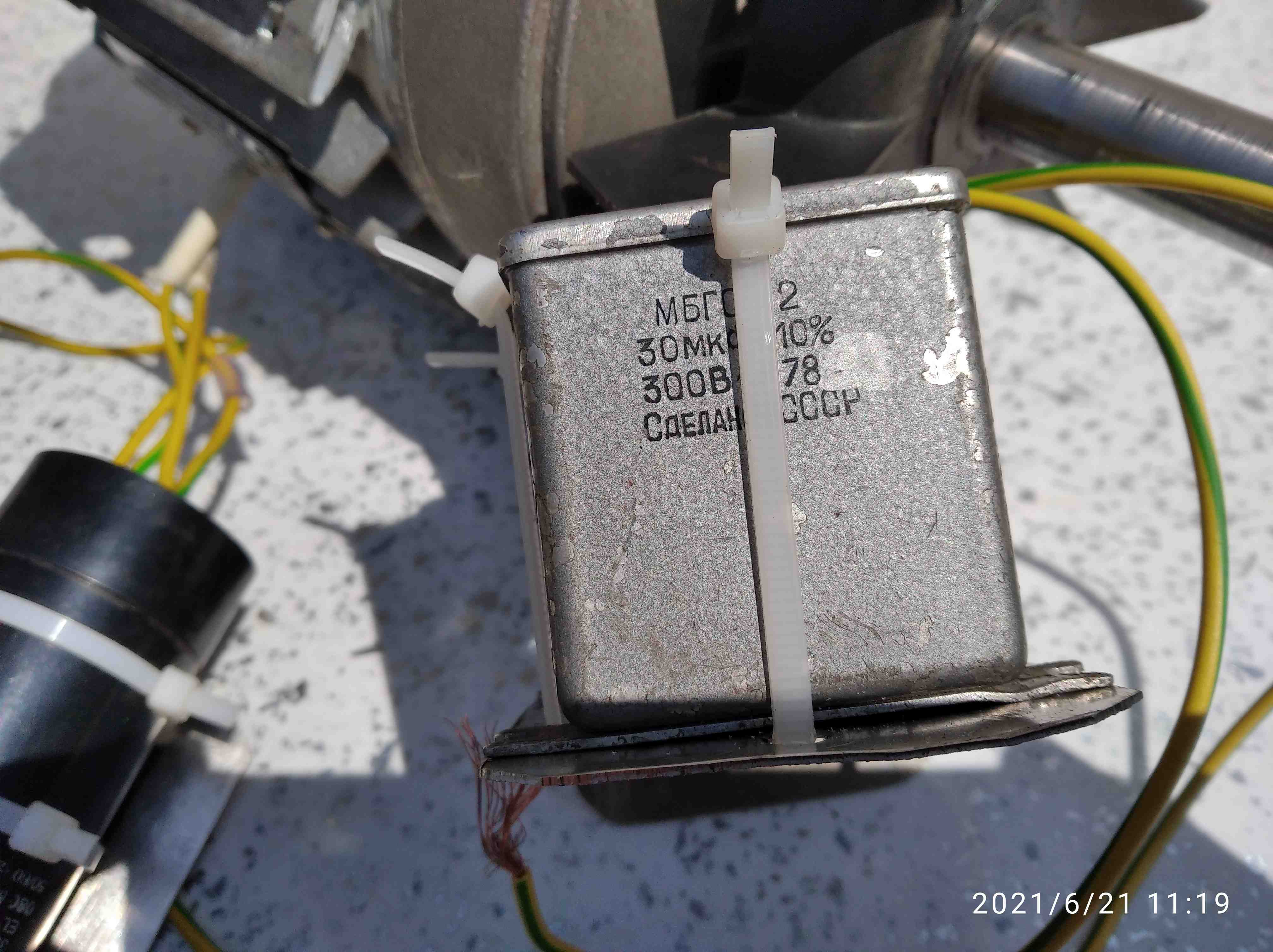

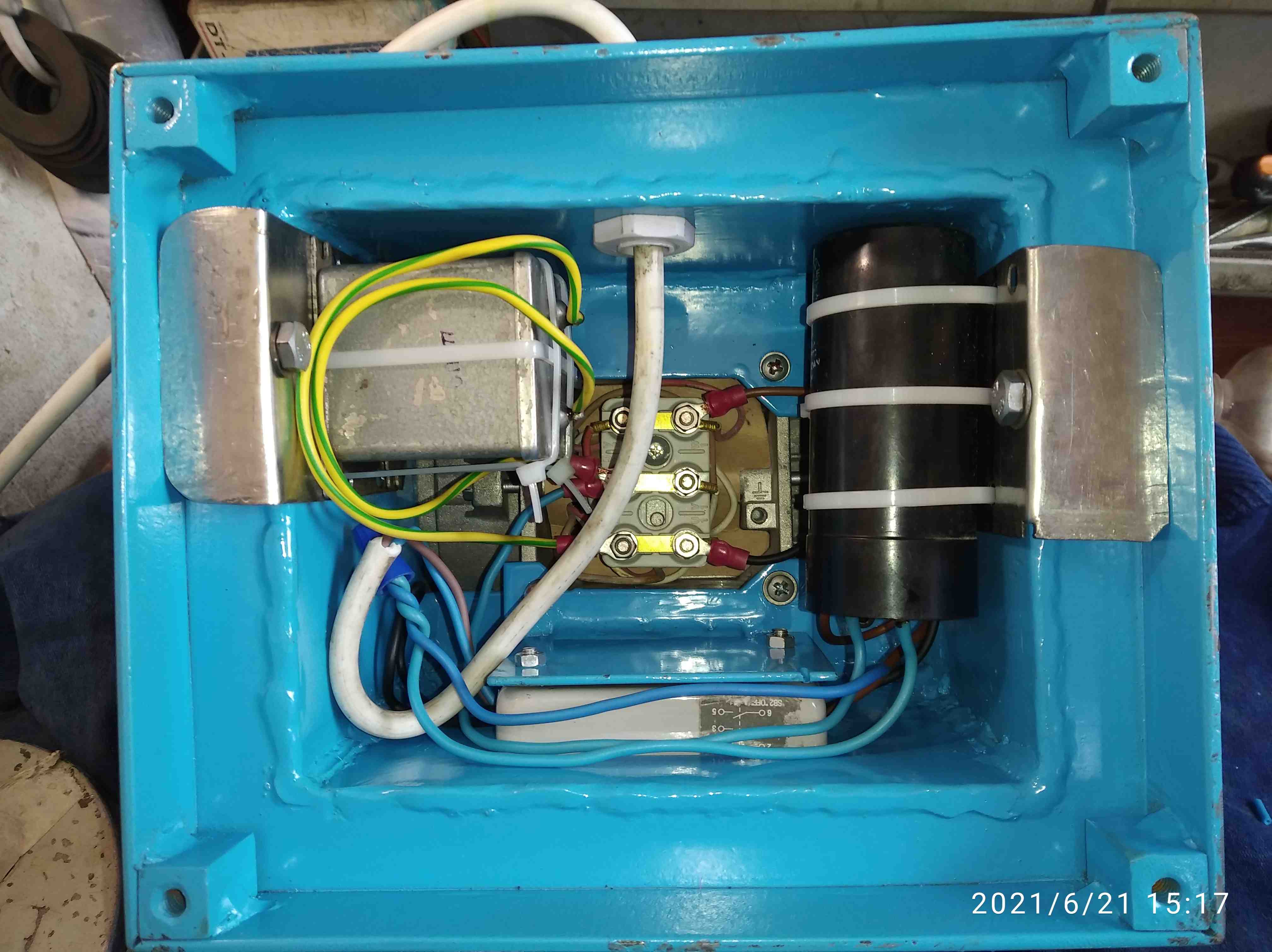

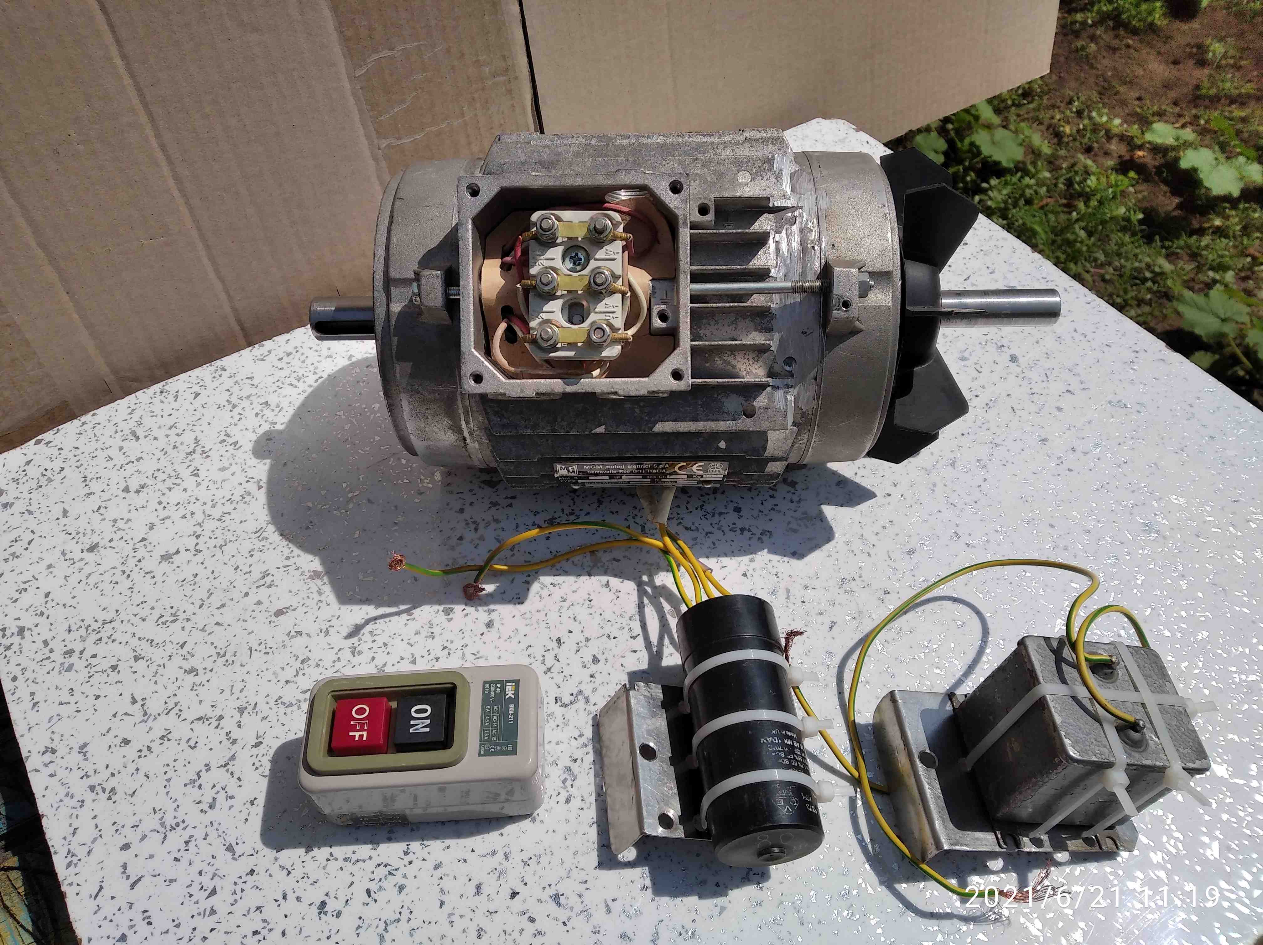

    electrical part of the machine.
    working condenser 30 microfarads 300 volts.
    start condenser 80 microfrads.

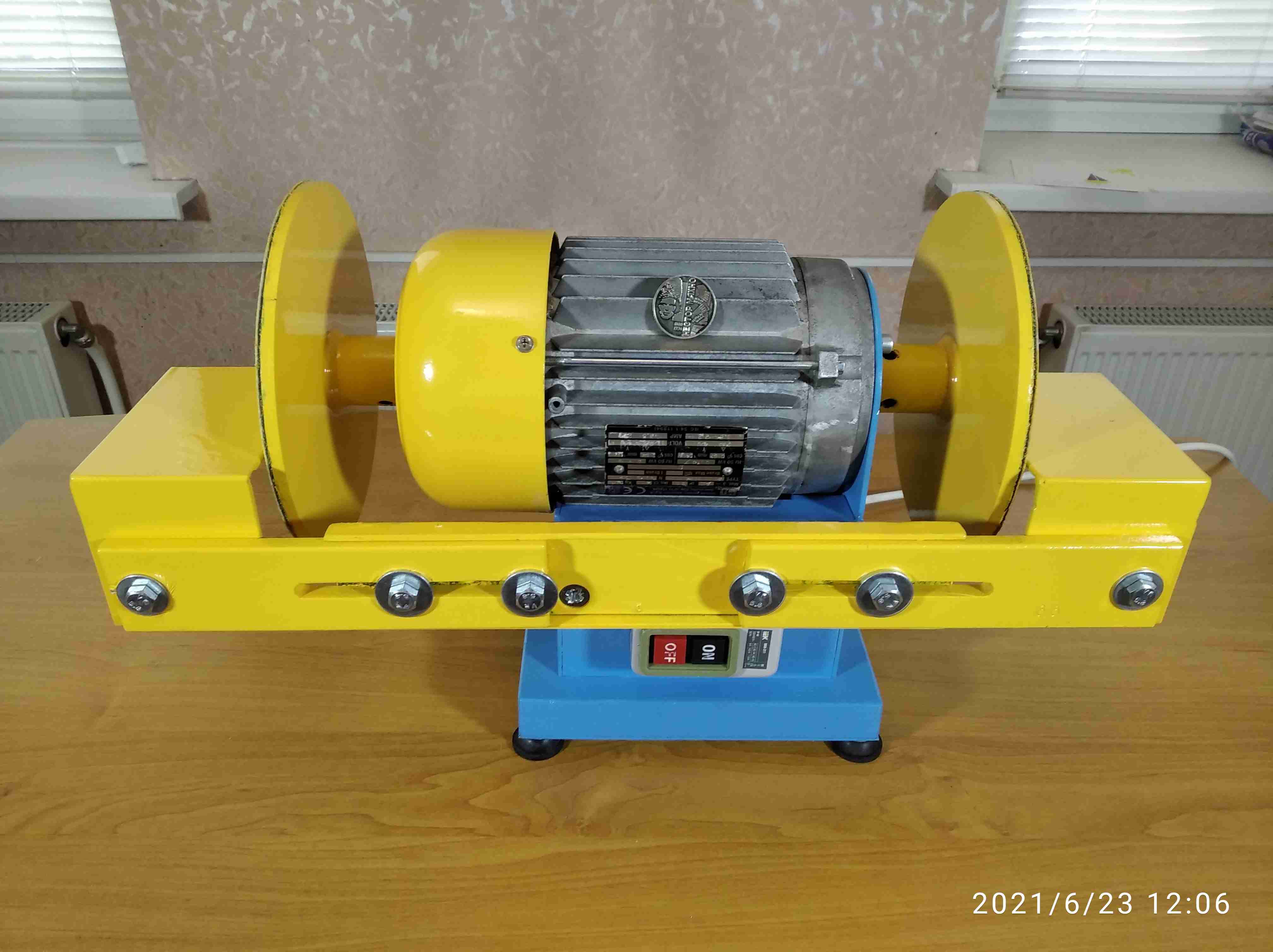

    Good day everyone. Today I will show you one of my new works.

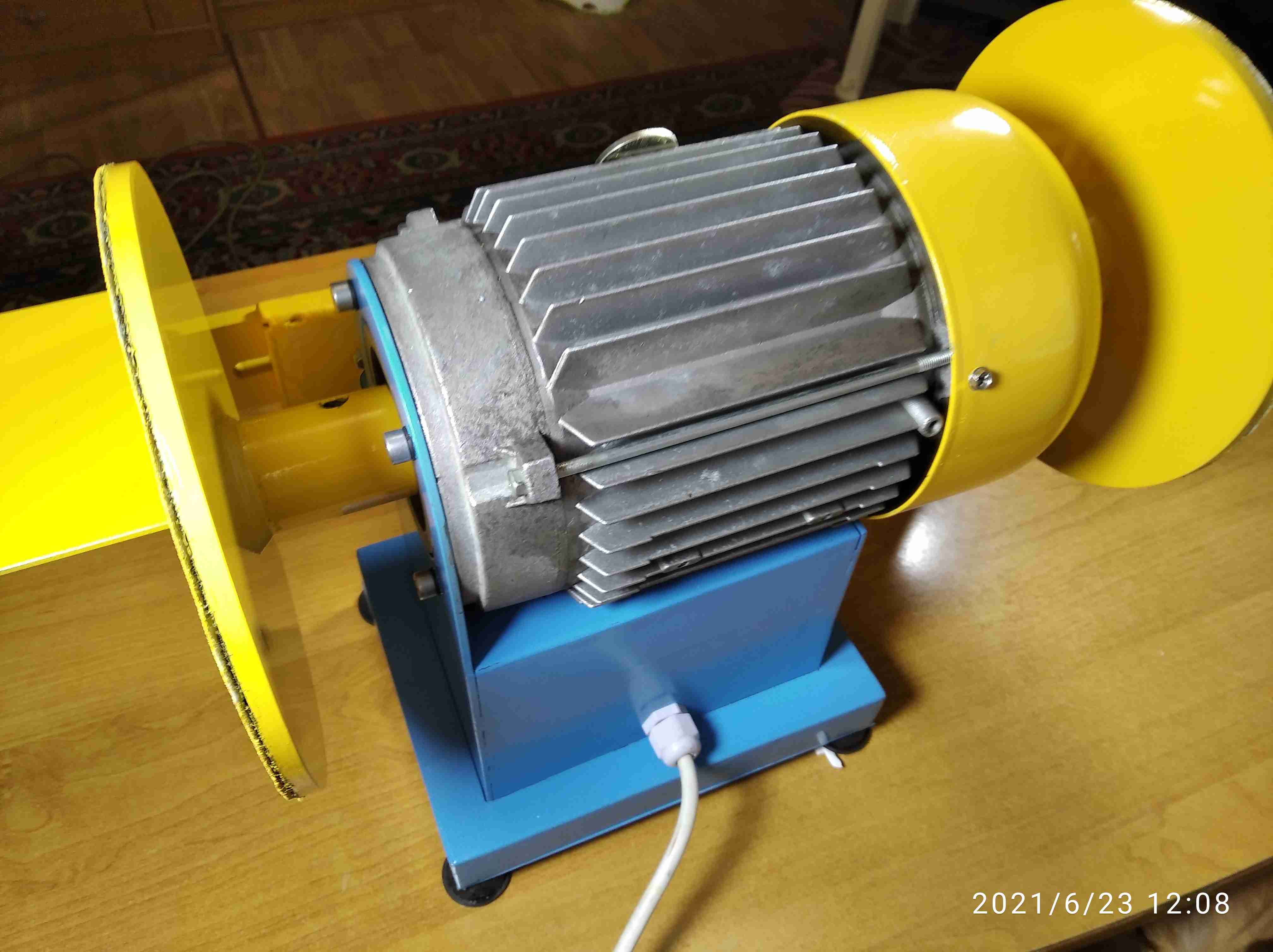

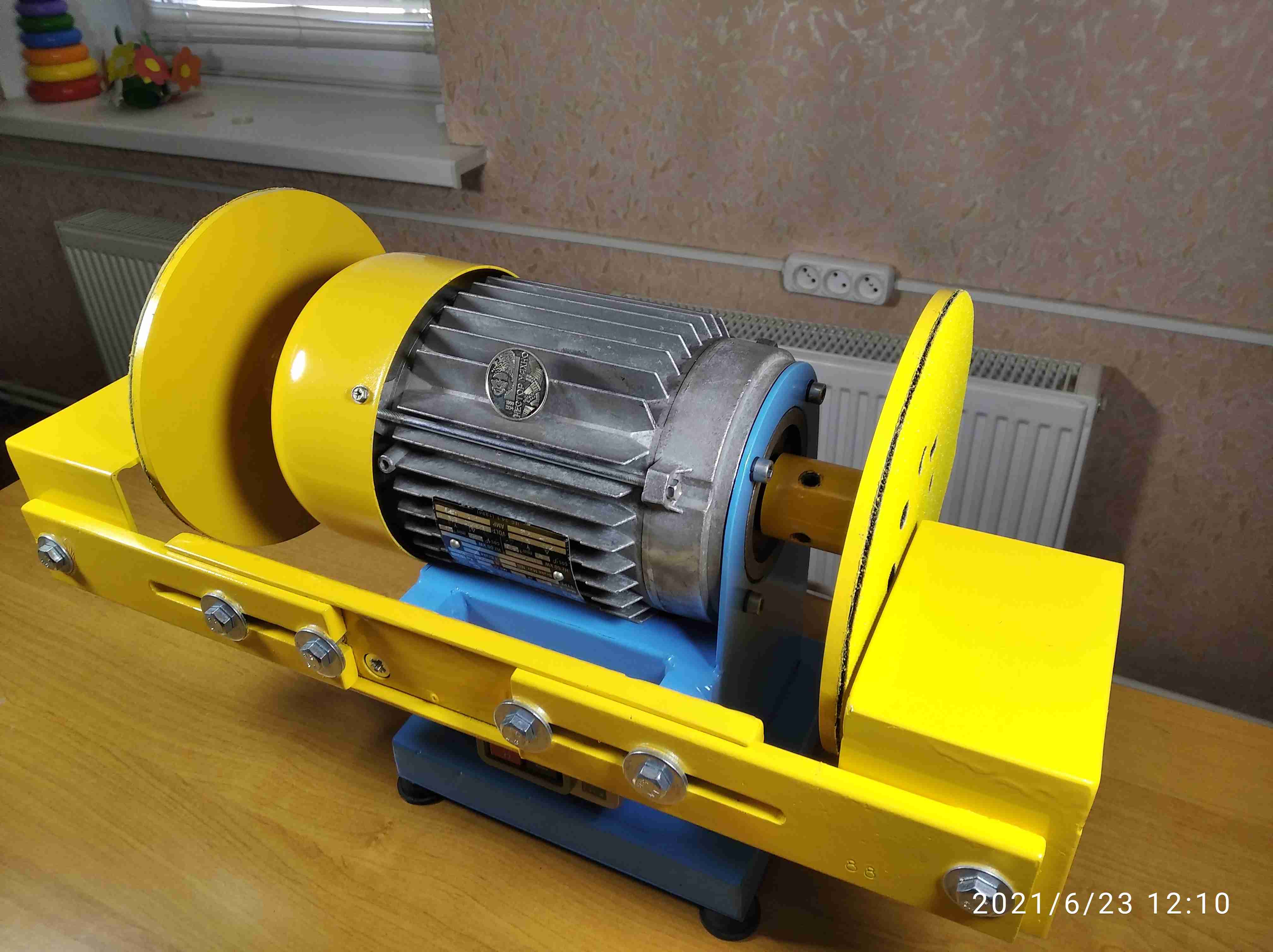

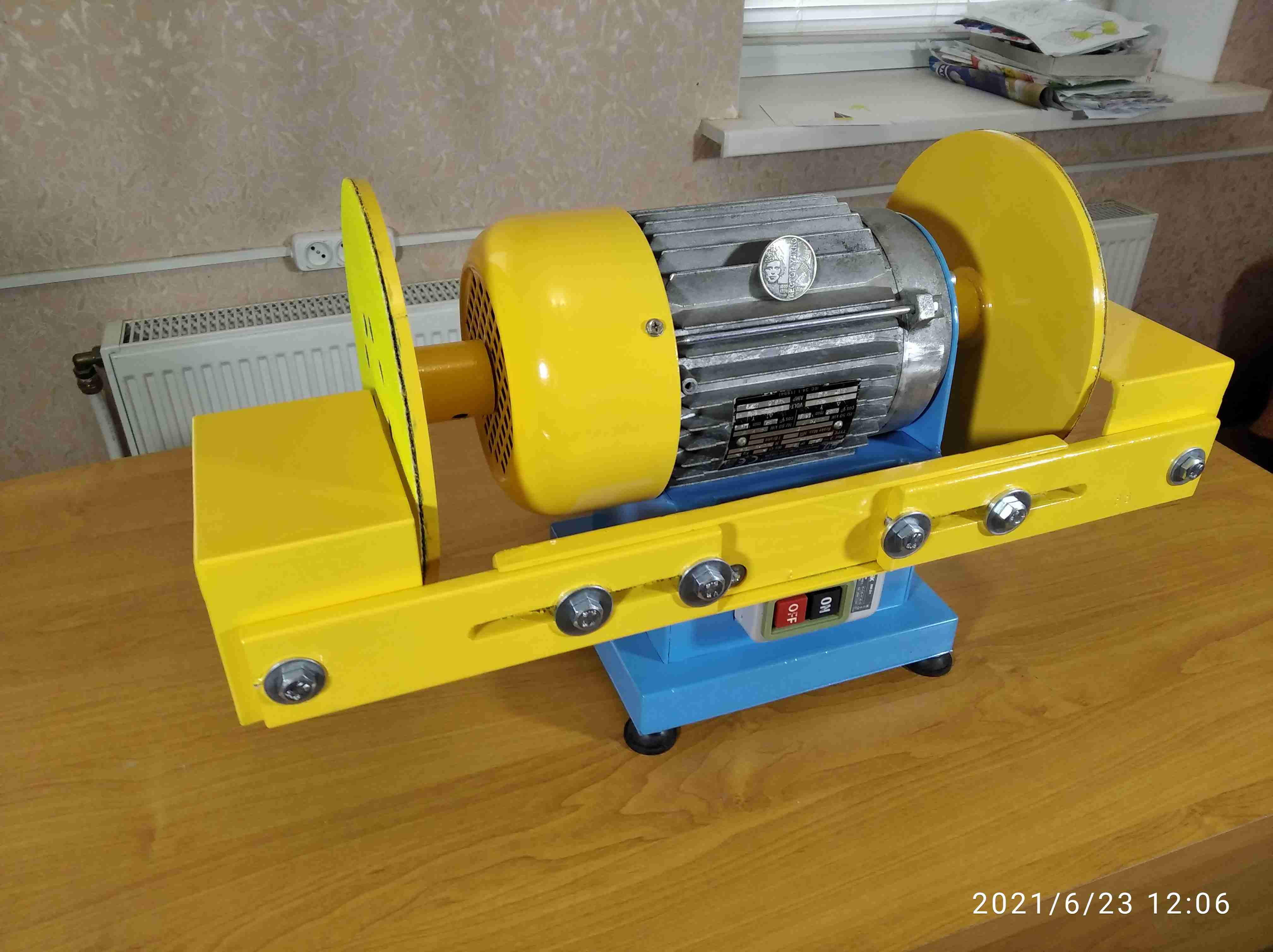

    photo in detail.
    Attached Thumbnails Attached Thumbnails I like to do bench grinders-_010.jpg   I like to do bench grinders-_043.jpg   I like to do bench grinders-_044.jpg   I like to do bench grinders-_014.jpg   I like to do bench grinders-_016.jpg
