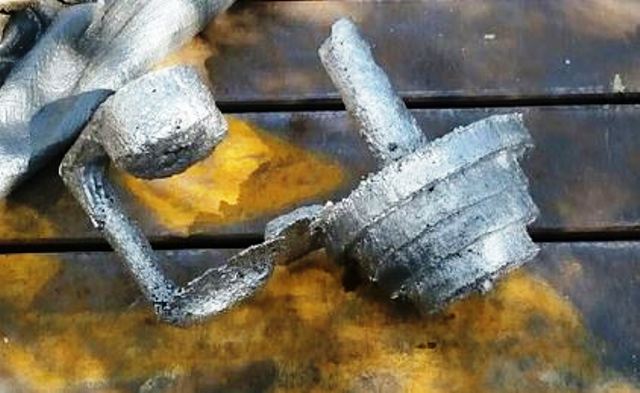

    Just poured a replacement pulley using the traditional greensand method with the previously mentioned features to improve the pour and I believe this is my best pour yet. No voids or inclusions that I've seen, no shrinkage defects and there's good metal underneath the dingle berries. The surfaces are much better than the lost foam attempts too.
