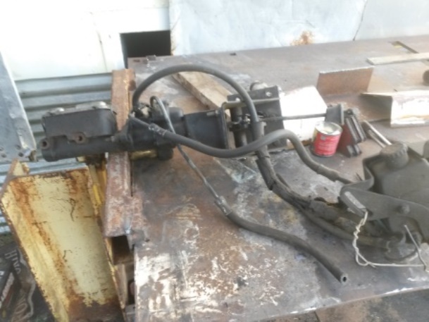

I happen to have a hydro boost off of a 2 ton Chevy step van.
Why not use that instead of buying for now I could buy a new hydro boost for around $275.00 but why spend money that I may not need to spend
The first thing I noticed that I would have to change the mount from a 90 degree to a straight but it required a 1 78" 6 inch deep square socket to get the mount nut off

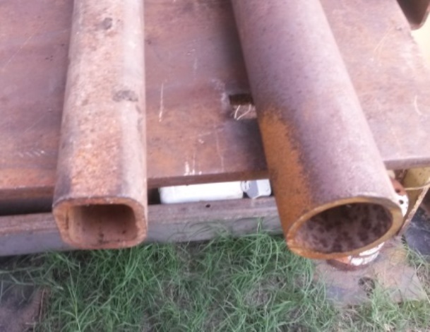

First I located a piece of 1/4" wall 2" sq tubing to make the die and a piece of 2 3/8" od Oilfield tubing because it ia made of better steel than 2" pipe
I ground the tubing down to size then plug welded the center for strength then cut it to about 1 /12" long for my sizing die

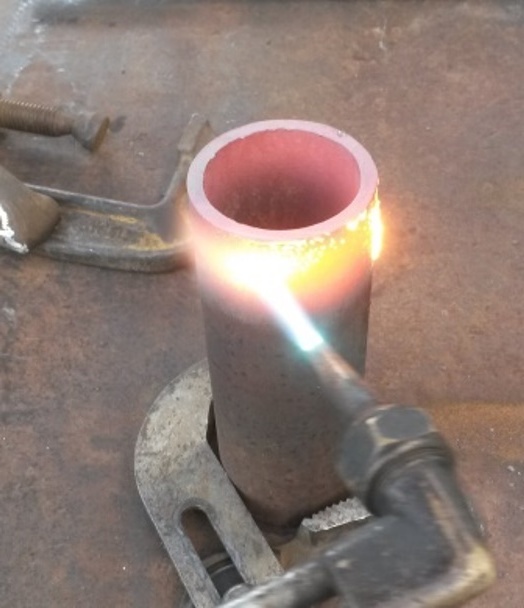

Then I heated the end of of the pipe and squared the end with the die

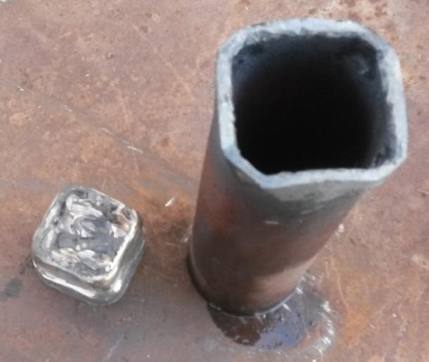

As you can see the 1 7/8" square sizing die and the socket worked great
I couldn't locate a sacrificial 1'2 or 3'4" drive socket to weld in the open end of the socket but my large channel lock pliers served well enough as the handle
