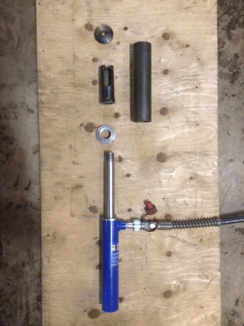

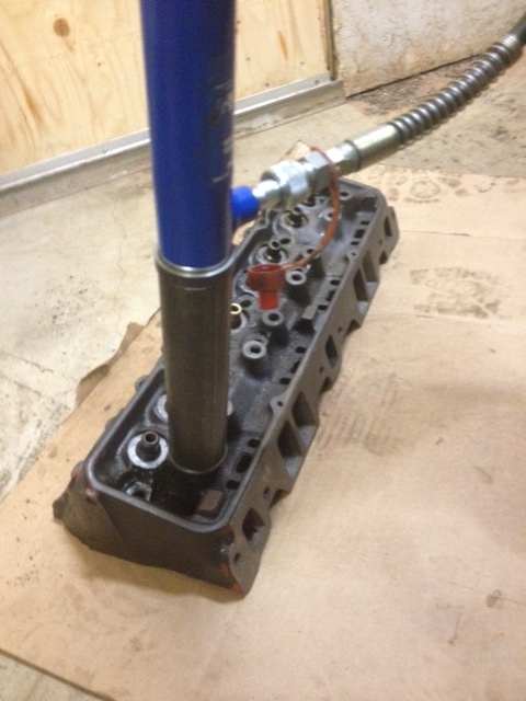

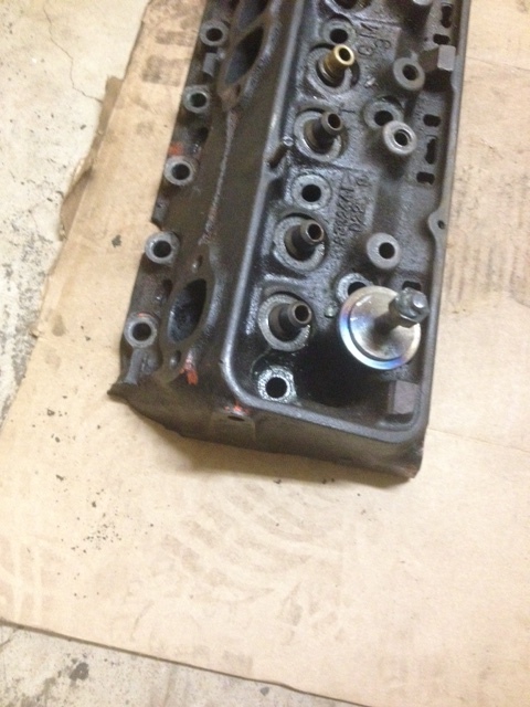

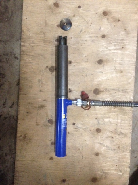

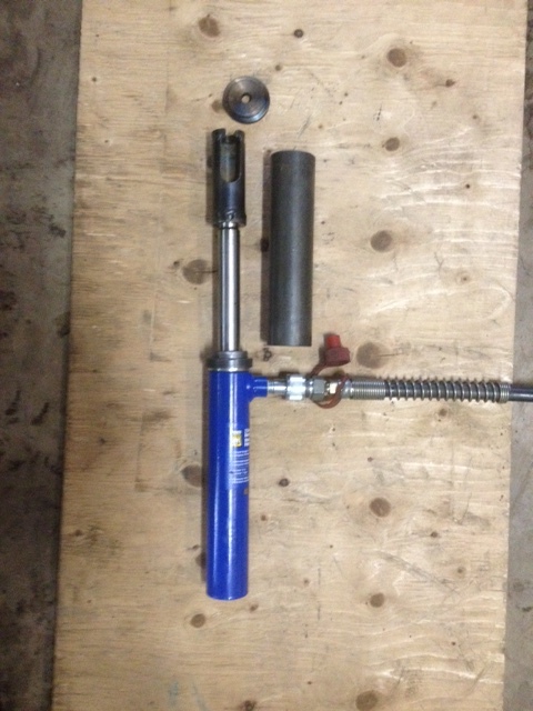

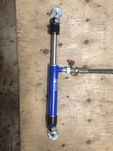

    Problem: Pulling pressed-in rocker studs from cylinder heads. The usual way to do it is put a spacer block over the stud and tighten a nut down on it until the stud pulls out. But if a stud needs to be replaced it's because the threads are stripped or it's broken off and there are no threads so the usually way doesn't work. To solve this problem I made a hydraulic stud puller utilizing a Porta-Power Pull-back Ram. Now I just need to put a nut on the stud and pull. If the stud is stripped or broken I just weld a nut on it.

    1. Two ways to do that: put Vise-Grips on and see if it turns. The other way I have found that is quicker is to hit them with a hammer - the press-in studs can be driven in a bit while the screw-in studs won't move (and they sound different when you hit them).
    2. The bottom of the part that attaches to the ram has a slot that is the size of the stud (smaller than the nut).
