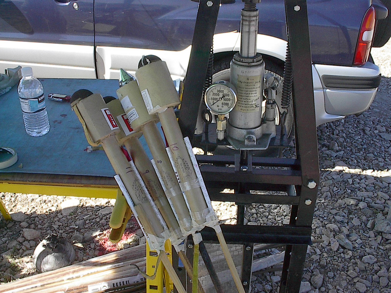

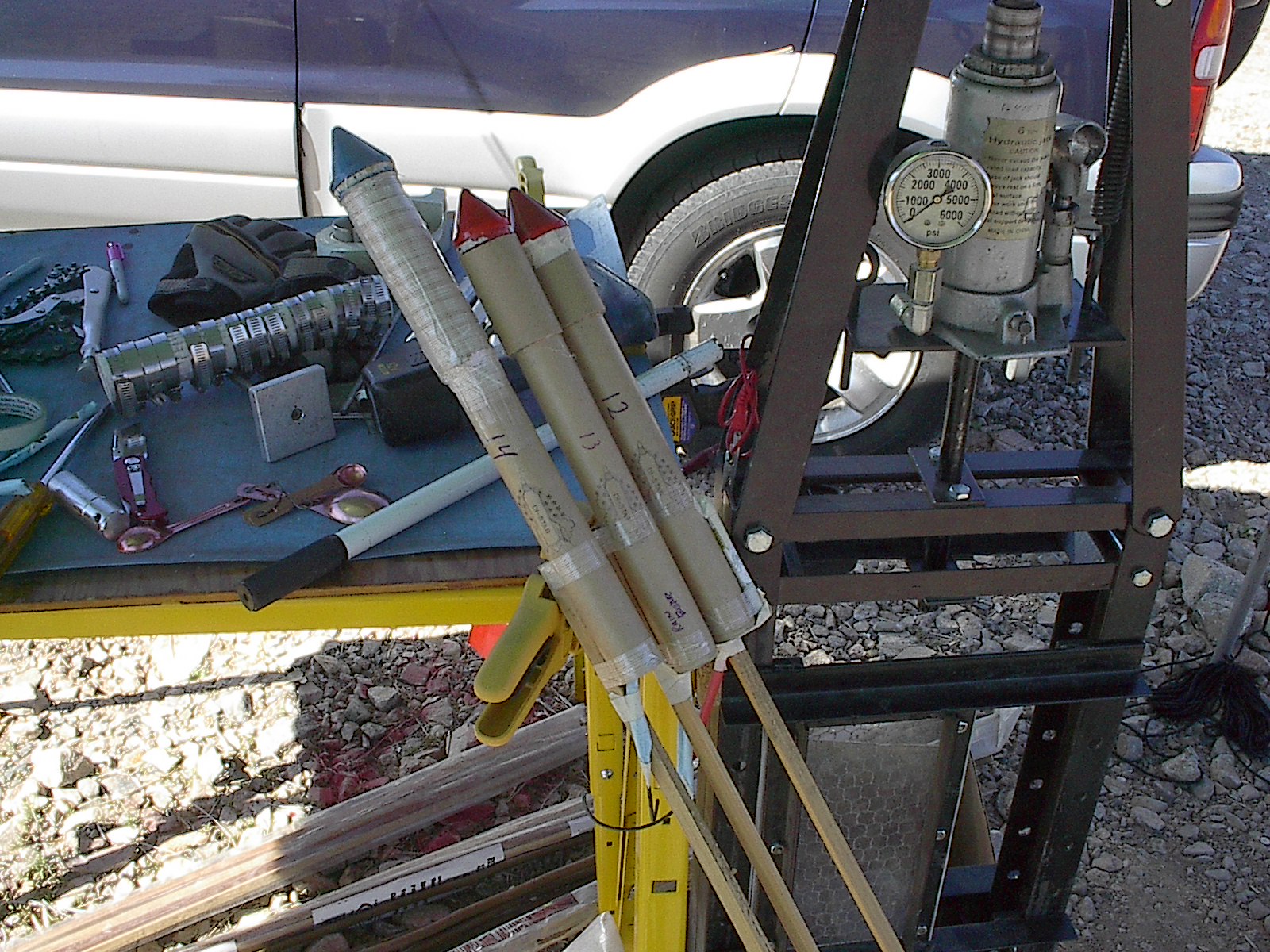

    I made this some time back for making my BP rockets, back when I had enough free time to be co-chair of manufacturing at fireworks conventions. Sorry, no photos during the construction.
    Anyway, I got the smallest jack that would give the pressure I needed in the fuel and then put a gauge on it. Be sure to use rated hydraulic fittings, you're dealing with pretty decent pressures. The reason for the smallest jack is it pumps the fastest. Some guys go for bigger jacks and spend all their time pumping.
    To get the jack apart, I used a strap wrench to unscrew the body and then drilled and tapped in from the side for the fitting. I drilled a small hole from there to the center of the jack and then drilled down from the top until the holes met. The drilling was done on my big mill/drill.
    While you have it apart, be SURE to measure the diameter of the cylinder, you'll need that to calibrate the gauge!
    Put it all back together and test it. Turns out I needed just under 3,000 psi on the gauge to press the black powder to 5000 psi.
    You'll notice a window on the press, that's two layers of polycarbonate with wire between in a steel frame. Black powder rarely explodes when being pressed, I wanted to make sure I'd have a story to tell if it ever did. Now, the guys pressing whistle rockets are another matter...
