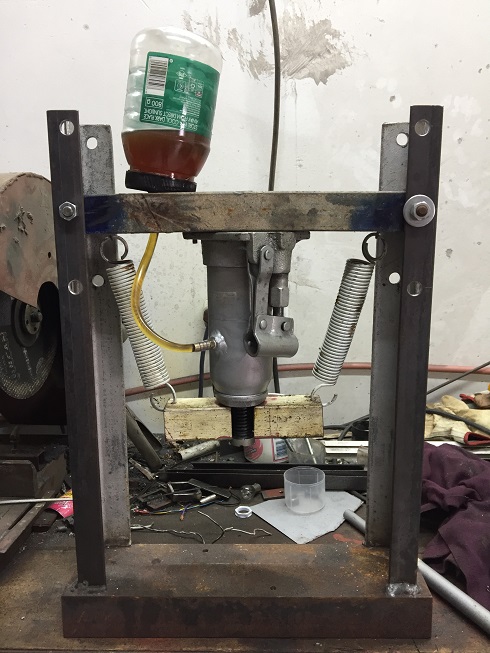

    Have been using the bottle jack in the conventional orientation for "Pressing" matters. (No pun intended), but always wanted to have it like a commercial press.
    Been reading a lot about converting a bottle jack to work upside down, but just all seemed like too much work and messy..
    So took from every post what made sense and combines it.

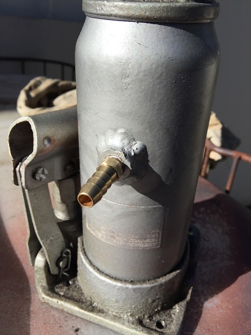

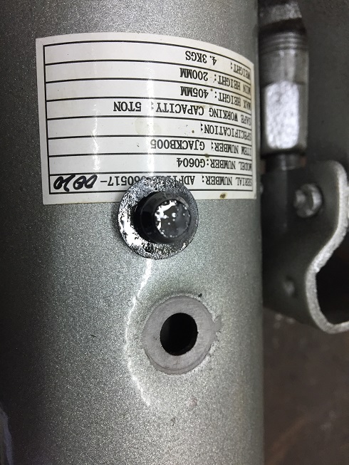

    Best option too create a reservoir tank filling point was to use the original jack filling hole. First problem my Chinese jack had no tread, just a rubber grommet.
    Hydraulic Press with bottle jack upside down - easy conversion-no-thread.jpg
    Hydraulic Press with bottle jack upside down - easy conversion-tail-swag.jpg
    So i found a M8 fine thread nut and welded it over the existing hole to allow a 8mm pipe connector to be screwed in. Took my time welding as all the oil was still inside the jack. I extended the jack fully to ensure as little as possible oil in the outer reservoir of the jack.

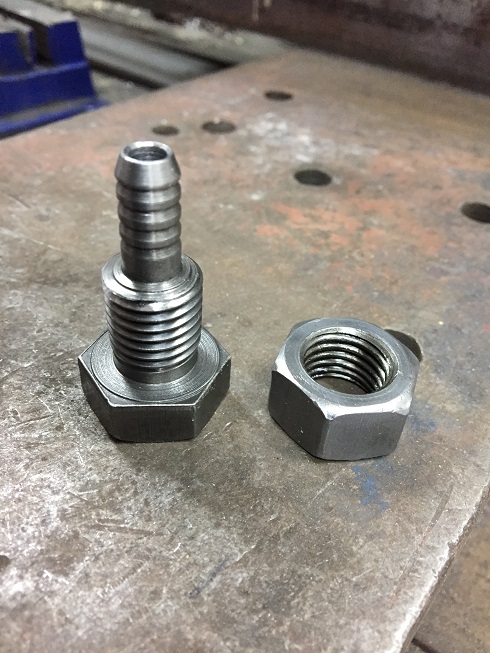

    Then machined an 14mm bolt to become the connector in my jam jar oil reservoir.
    Hydraulic Press with bottle jack upside down - easy conversion-jam-jar-connector.jpg
    Keeping the Jack on its side I primed it untill there was no more air in its system.
    the jack could then bu turned upside down and it works. No stripping, no mess and the jack can be converted back to normal easily.
    Now finally added the springs to pull back the ram. Job done, now for a coat of paint and some M12 Hi Tensile bolts as adjuster pins.
    Hydraulic Press with bottle jack upside down - easy conversion-hyd-press.jpg

    A question my "technical" WhatApp group also asked me when I posted my progress.
    I had the frame made and the jack the convectional way like you would use it every day, but found it almost impossible to single handed balance a socket, a bearing and the steering knuckle all on the ram of a bottle jack and then align this all while operating the jack.
    With the first threads I found where the guys stripped the jack and add longer pick up pipes and drill through the base and fit nipples I was going to rather keep on battling, but then I found this idea on YouTube and had nothing to loose as the jack can easily be converted to normal if it was not working.

    I tried to get a base moving up inside my press’s frame. You will see my uprights are angle iron welded to the base in such a way it forms a box for a base to go up, but it did not work. The conversion was so easy i just gave up on that idea

    Manufactured a nice SS reservoir tank using 50mm SS pipe with 2 drop outs (from the rod holders for my boat) welded in top and bottom. My jam jar leaked on the jam jar lid treads. Also modified the pressure release screw to be hand operated and not needing the jack handle to release pressure. Will post pics tomorrow
