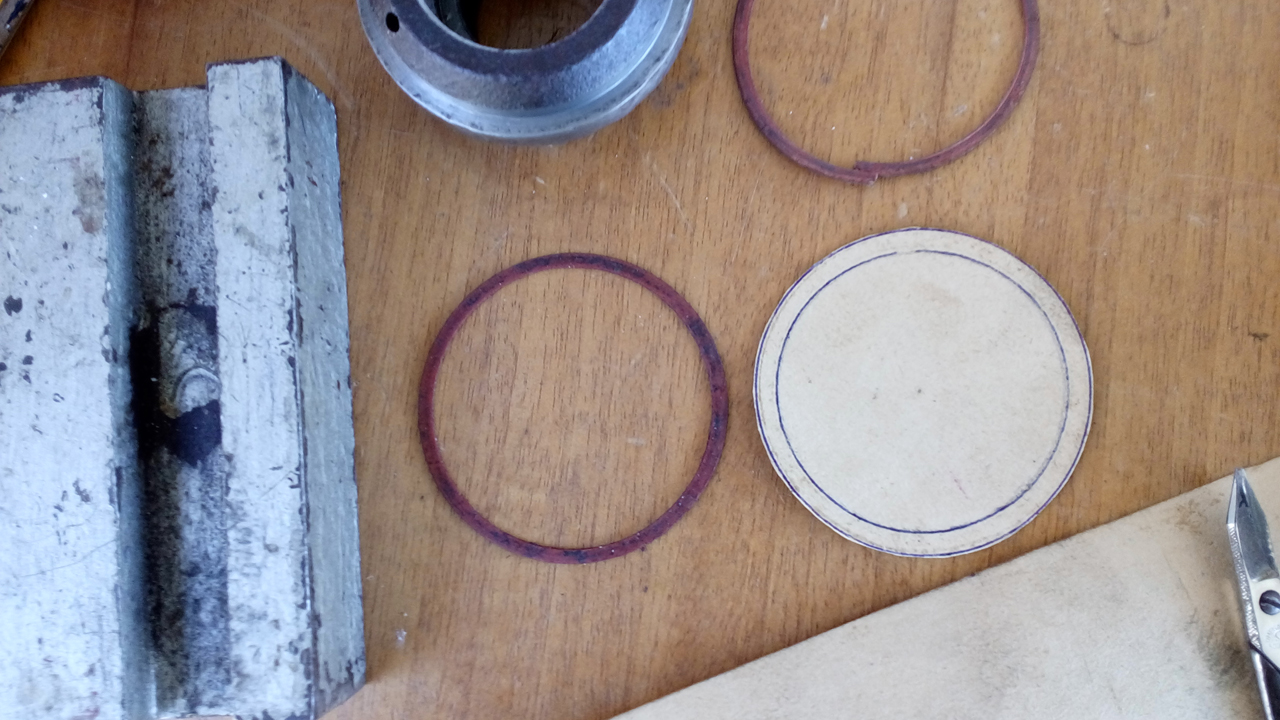

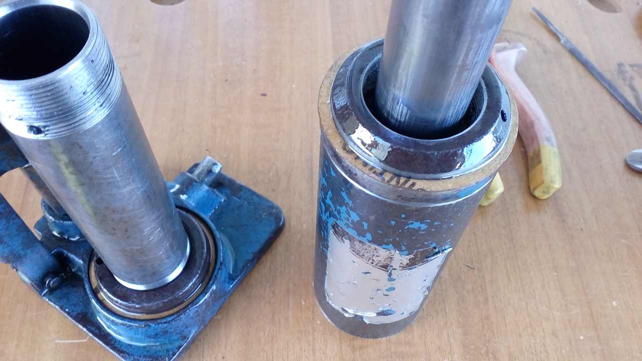

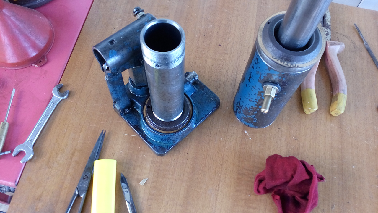

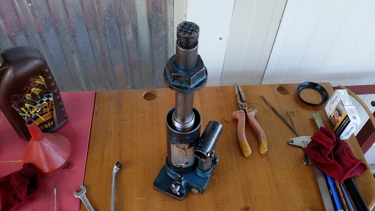

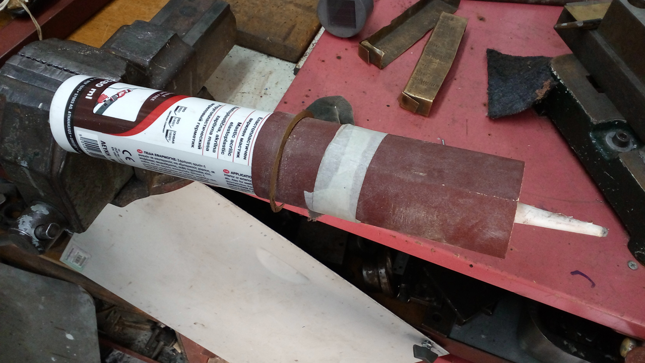

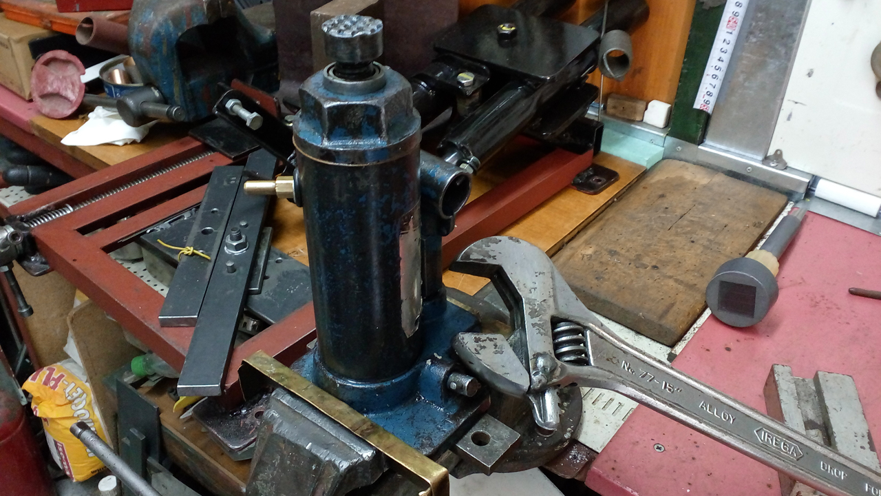

    One of my hydraulic jacks it had oil leaking, probably from a damaged gasket.
    So I decided to open it and try to repair it.

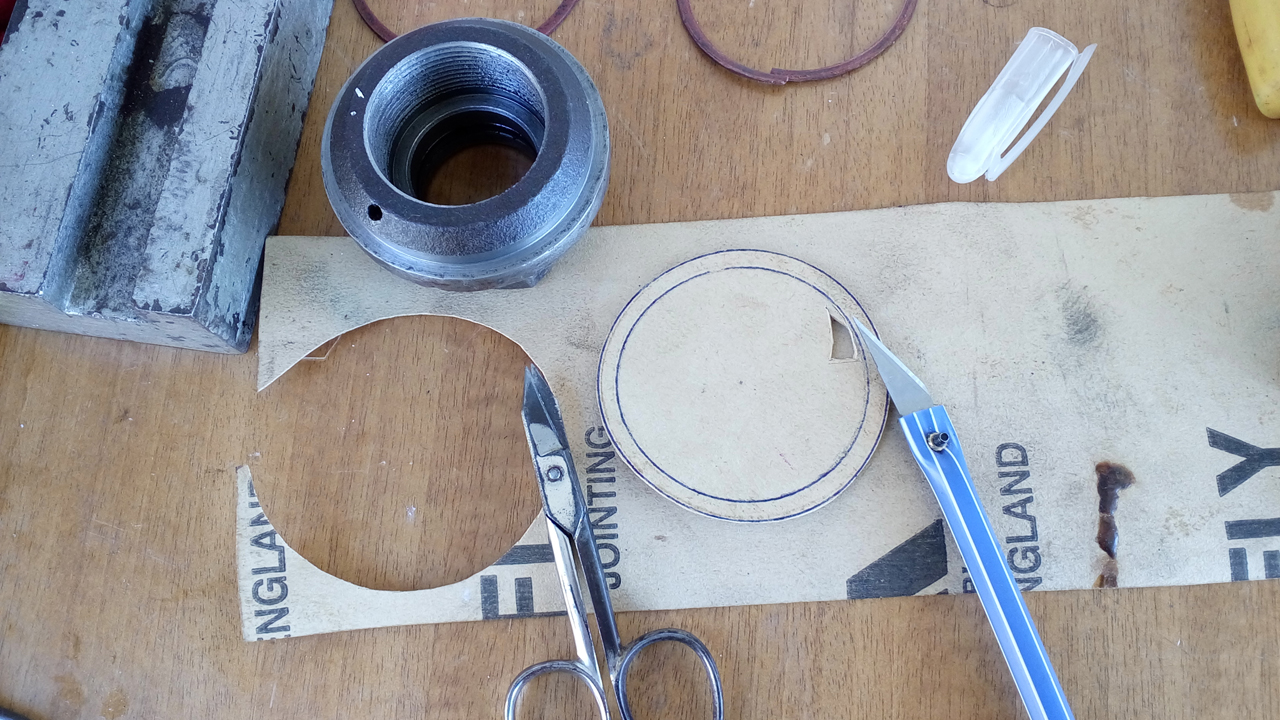

    As I had guessed one of the two gaskets it was broken.

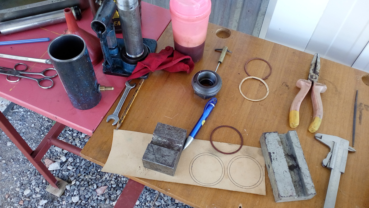

    After some phone calls in the market I couldn't found any gaskets at the desirable sizing so I decided to make them myself.
    I had a suitable piece of gasket paper (Oil Resistant Jointing at 1.2mm thick) somewhere, so I searched and find it.

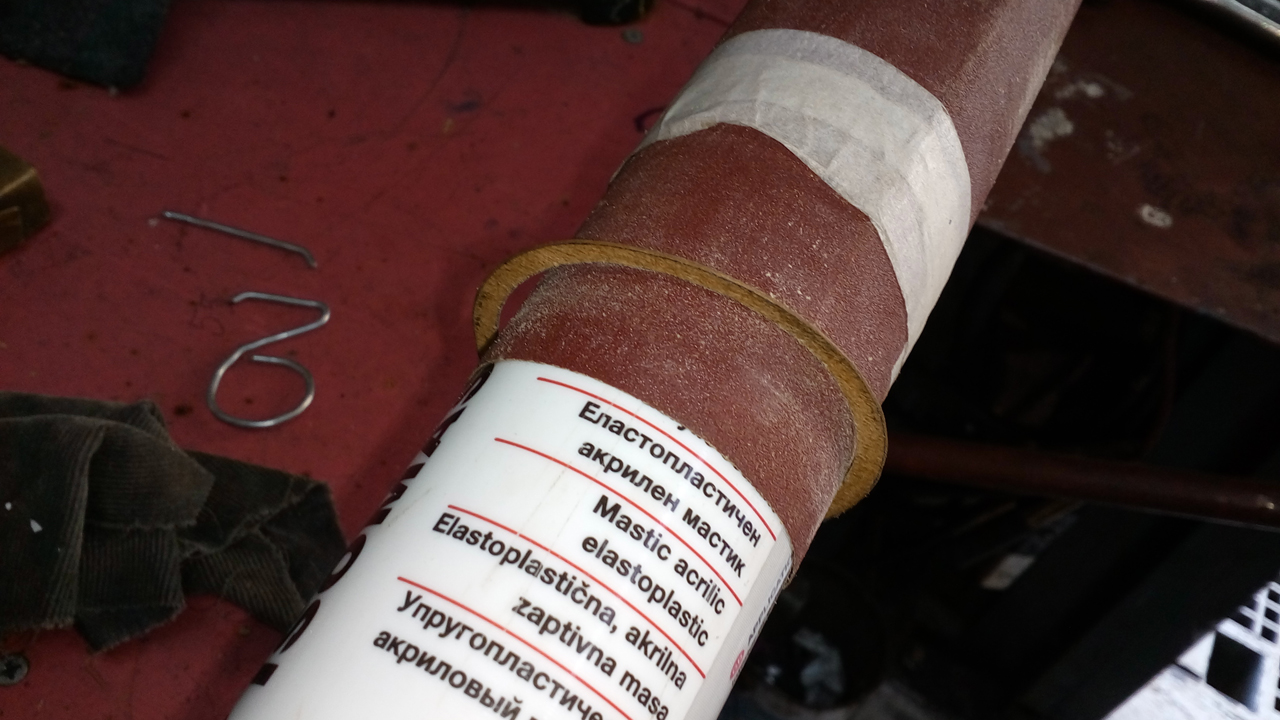

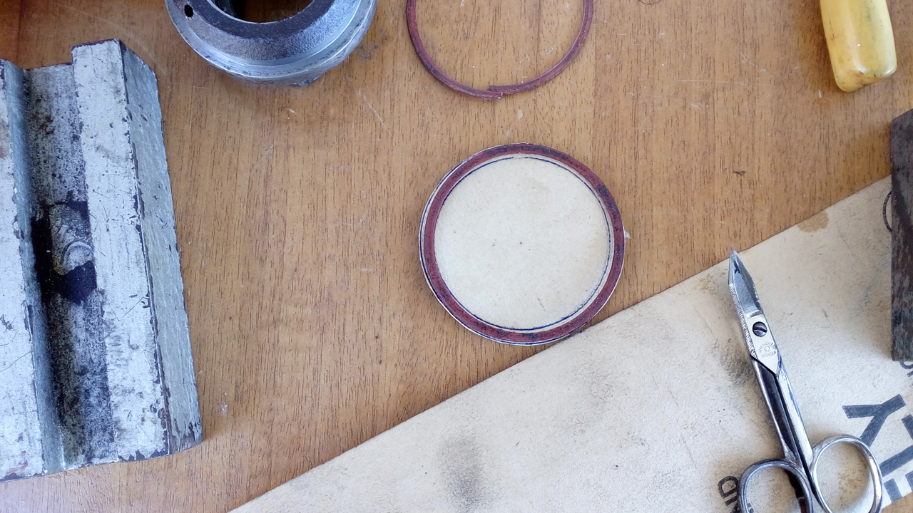

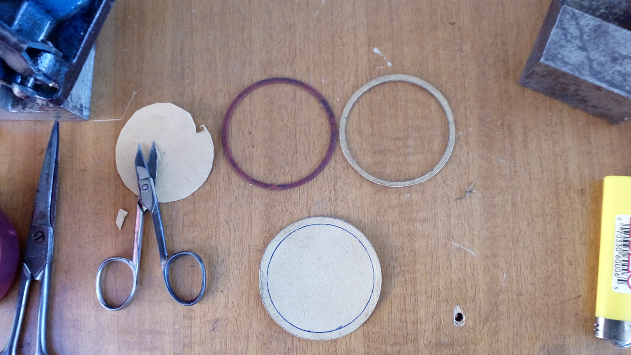

    I cut a strip and using one from the olds as a model I designed three gaskets.
    I used the first one as demo model to trying my scissors to find the most suitable for this cutting job.
    Hydraulic Jack Repair-ff-2.jpg Hydraulic Jack Repair-gasket-paper_no-firm.jpg The brand name (of gasket paper) has removed from photo.
