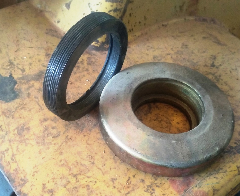

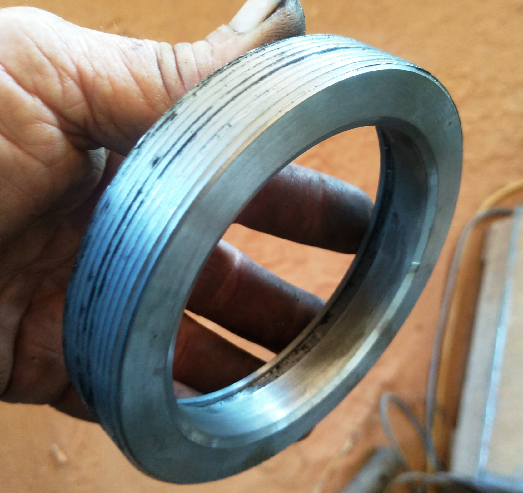

    The gland nut on 1 of the Siamese cylinders had some weak looking threads once I had it removed. I decided I should make a new one rather than try and clean up the threads on the old nut.
    I started out with a roller I had left over from a bygone era of manufacturing 2 post lifts

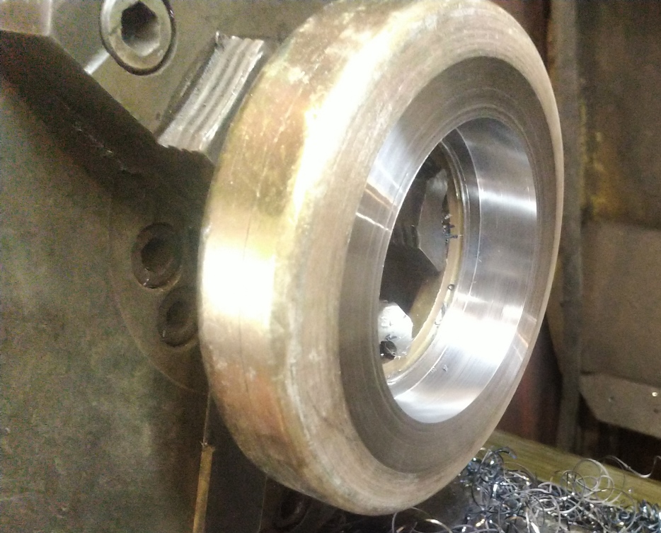

    I faced off 1 side

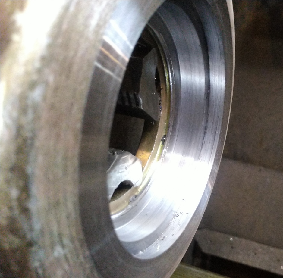

    then bored to size deep enough to make the nut
    Then added the wiper grove

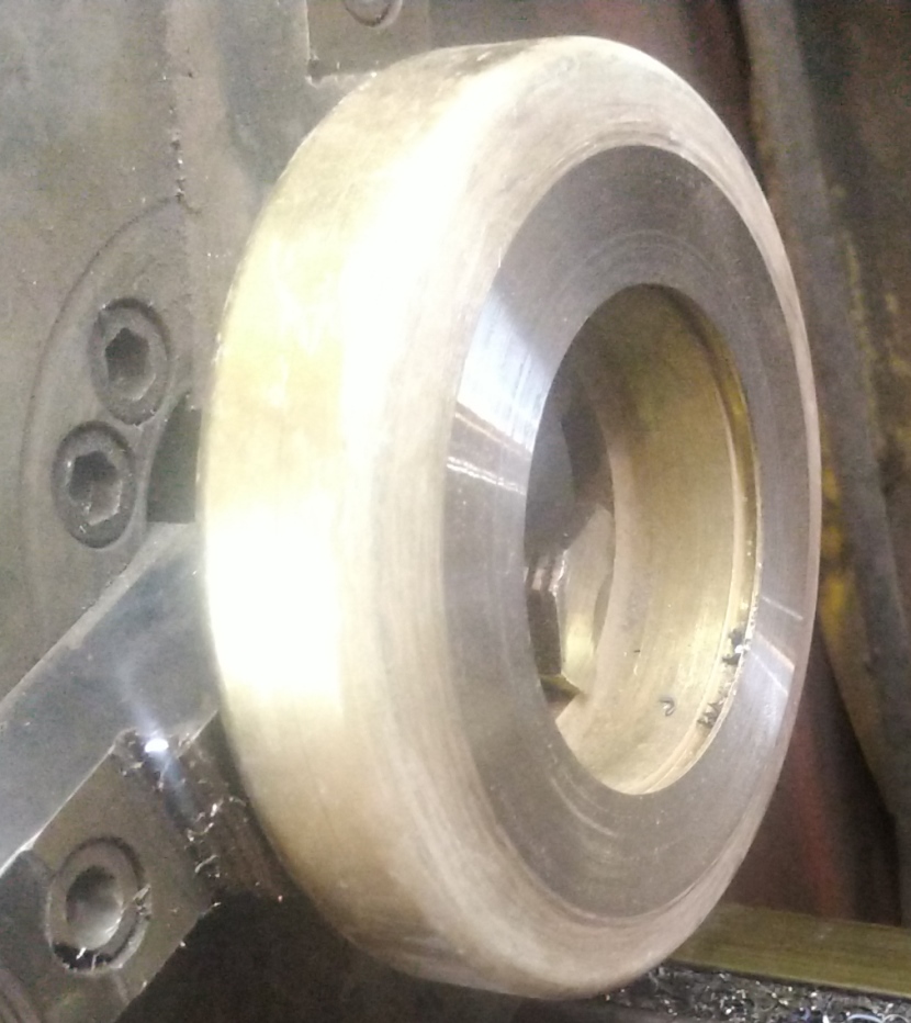

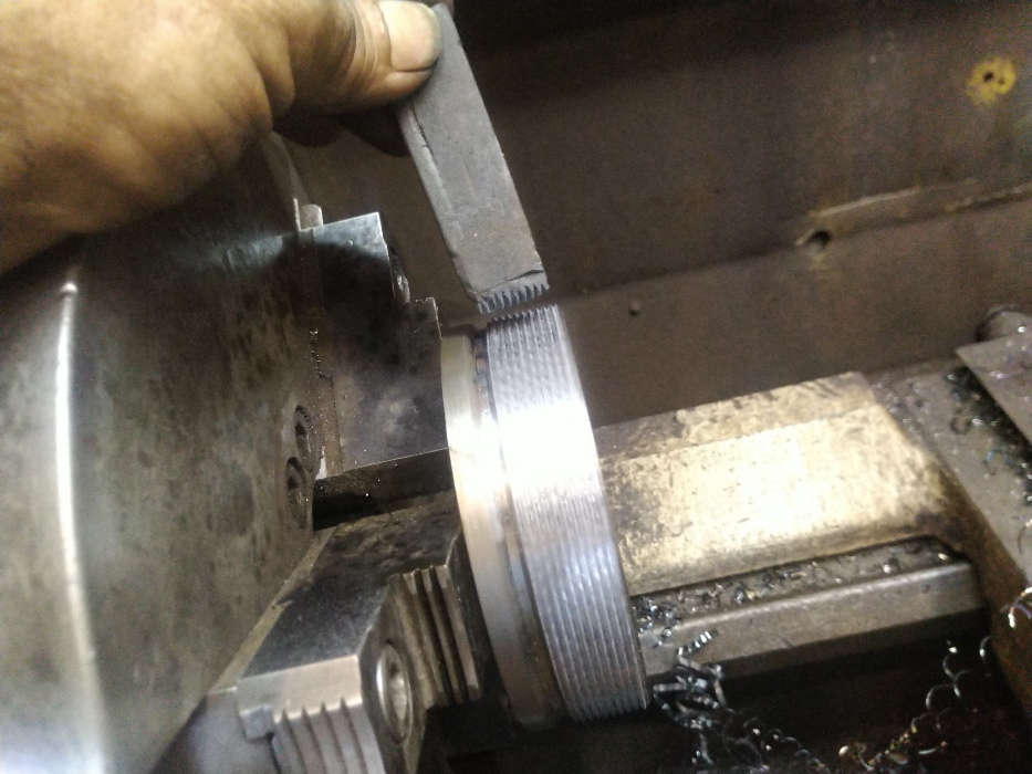

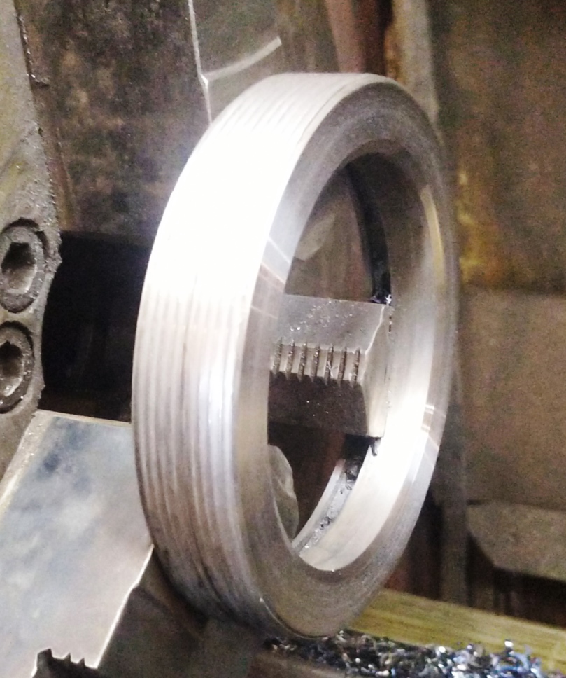

    Then turned the OD and treaded to 12TPI and used a stone to smooth the threads
    Its hard to see but I scribed a mark on the OD incase I needed to return the nut to the lathe and take off a little more of the thread depth

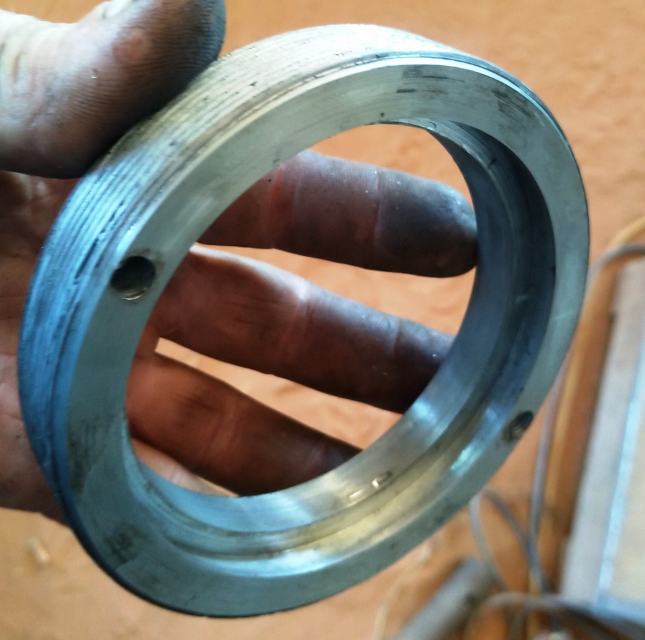

    Once satisfied the nut would mate up to the threads in the cylinder I chucked it from the opposite side and removed the excess thickness
    the finished nut
    Assembly

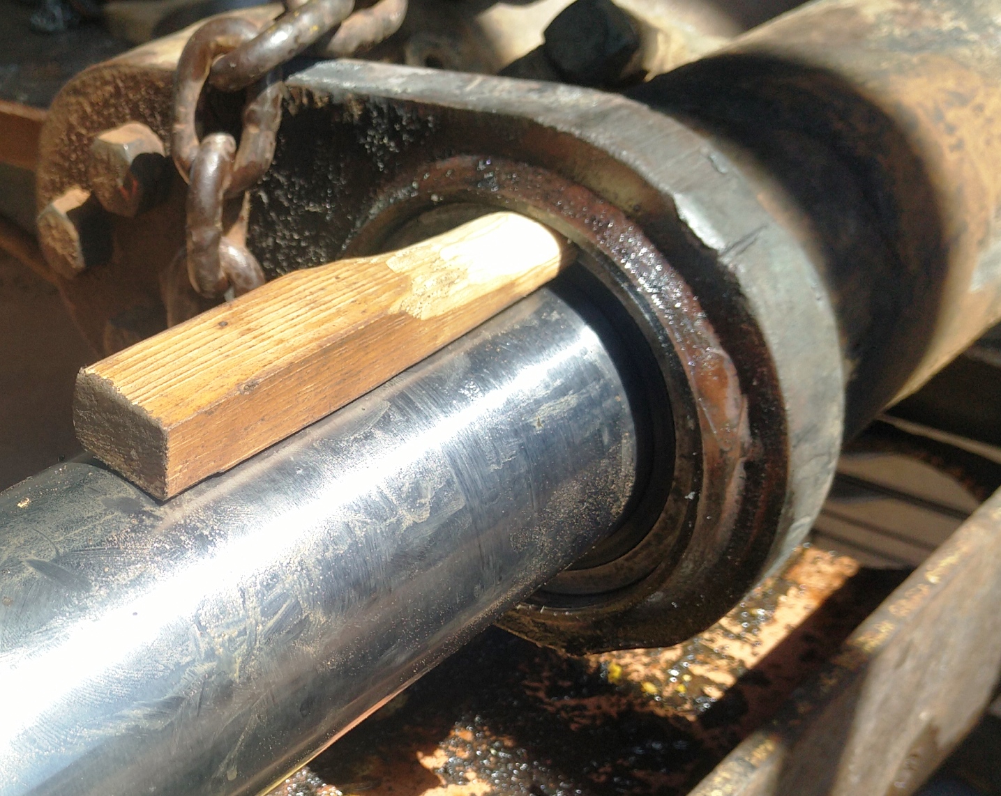

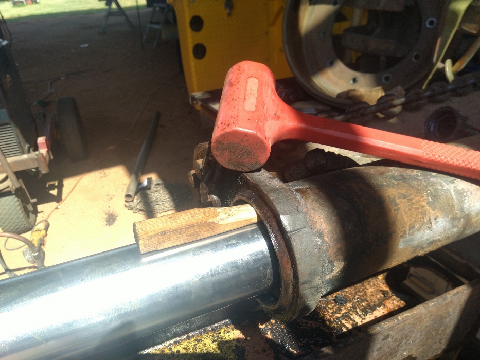

    Carving a piece of wood makes the best drift for tapping the gland in place. My brass and aluminum drifts were too large in diameter.
    I will put this in my tool box to use again
    Fully assembled
