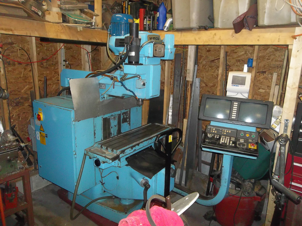

    I picked up this mill several years ago and documented my challenges on another forum. No need to re-hash that here but I'll answer any questions. Long story short there was some trial to get it working but after a few weeks things started failing one at a time. I intended to retrofit it immediately but got caught up in life stuff and pushed it to the corner of the shop. Now it's been dug back out and it either has to get retrofitted and be productive or it has to go somewhere else.
    I did another small retrofit on a small mill to see if I even had the ability and it worked out OK so that gave me some confidence to tackle this one. Link to that if you're interested.
    Retrofitting and old benchtop CNC mill - Town Labs 512
    Here's a picture of the Hurco.

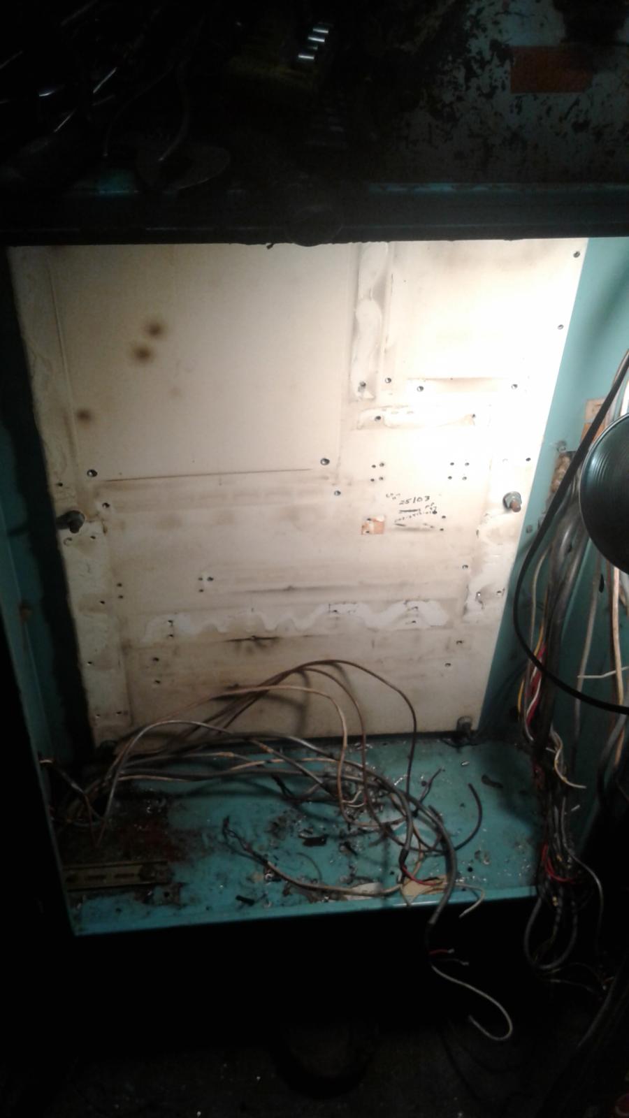

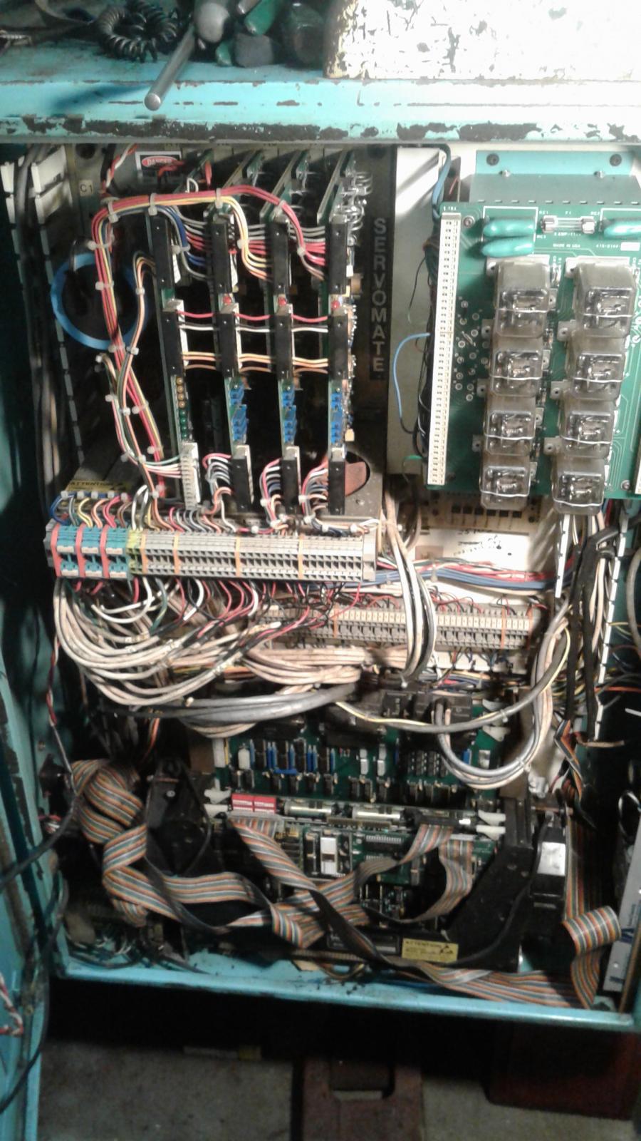

    I started in the control cabinet.
    Before
    After
    Yikes! No turning back now

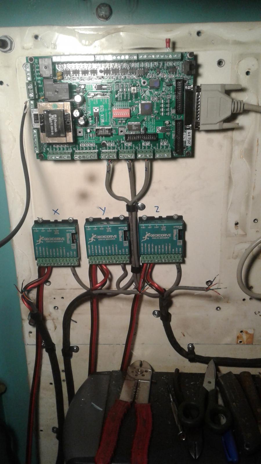

    Not a lot to show but a little progress has been made.
    PMDX and Geckos mounted.

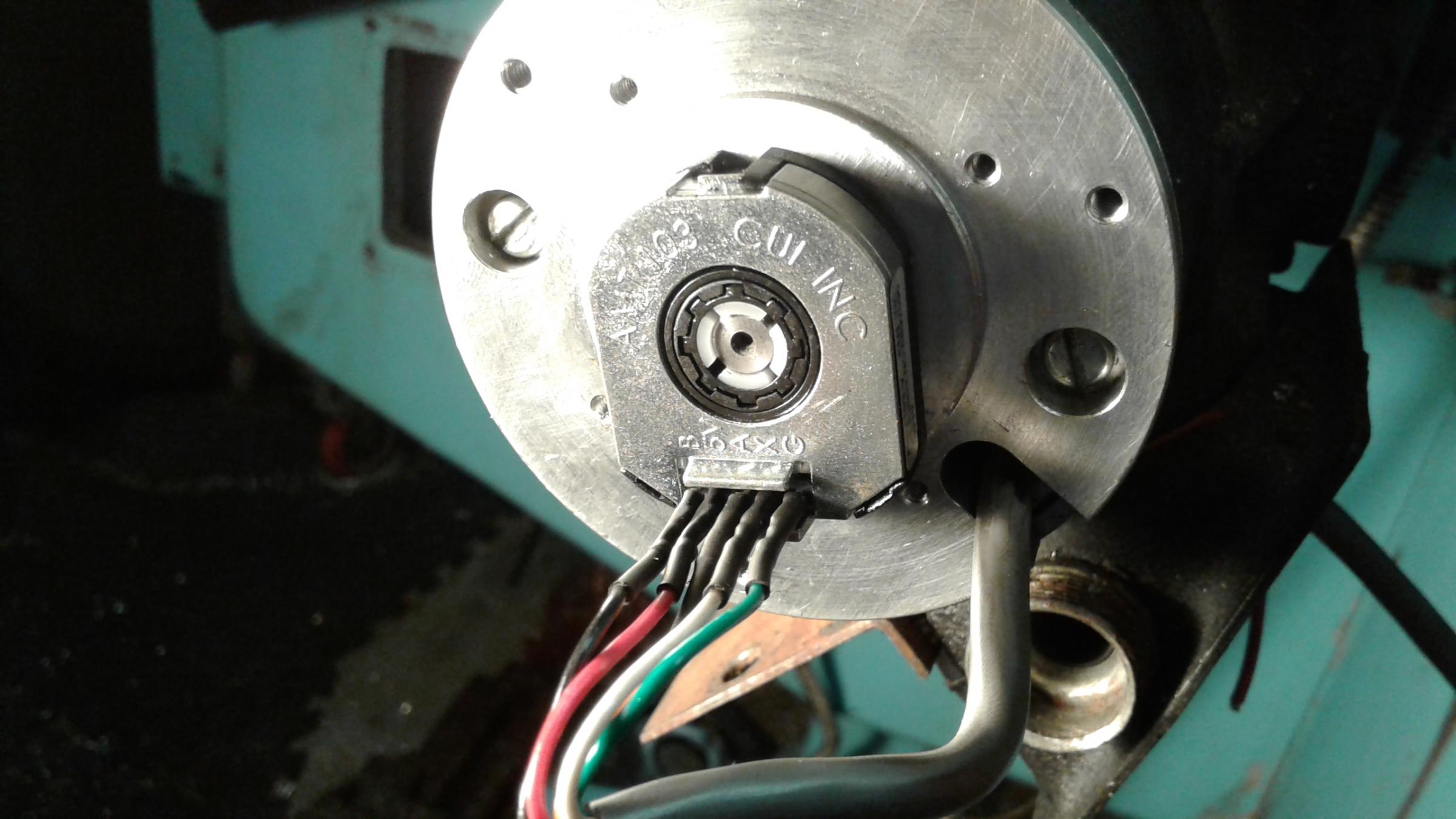

    Encoders mounted and wired.

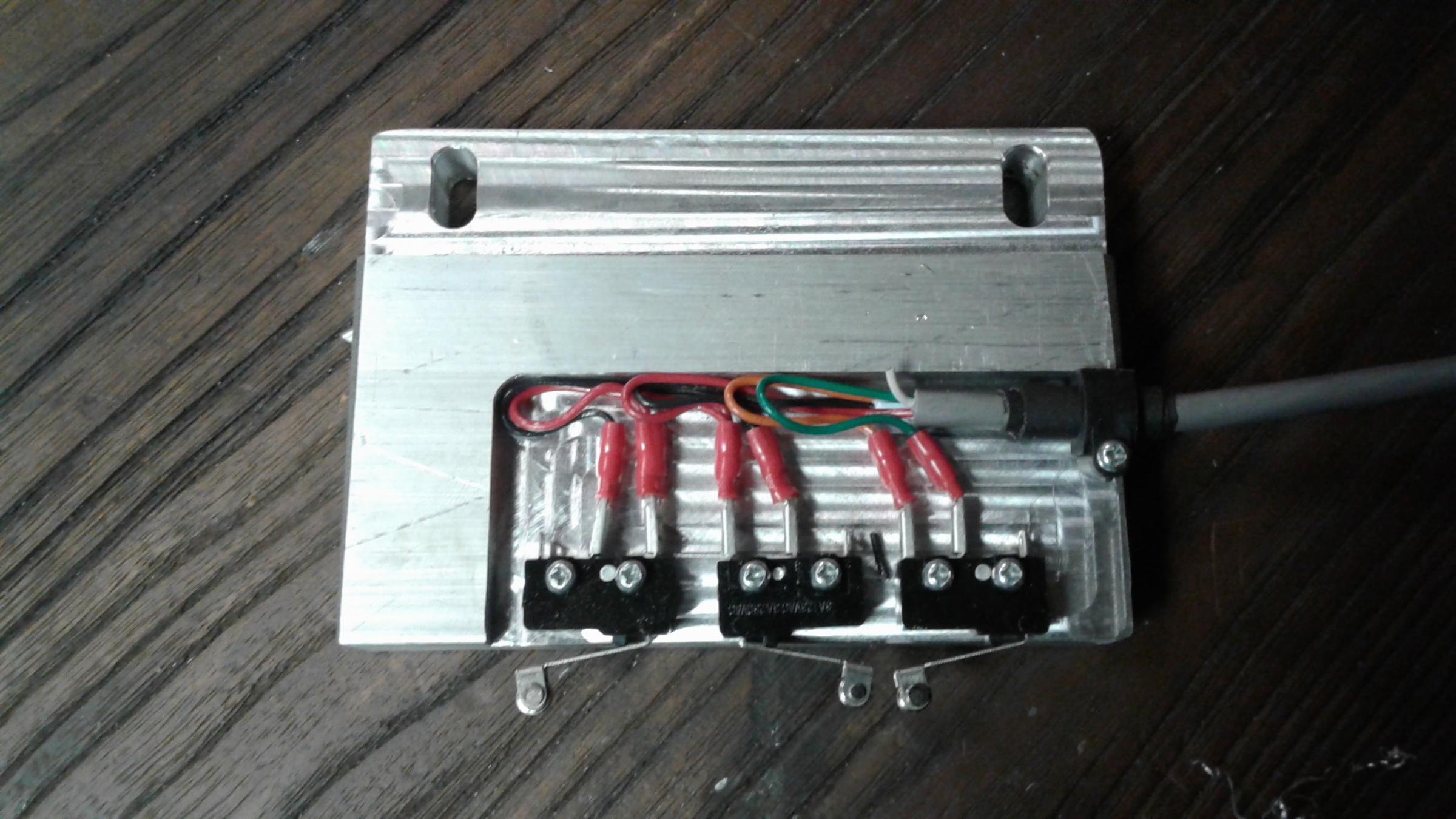

    Limit / home switch bracket made and wired.
