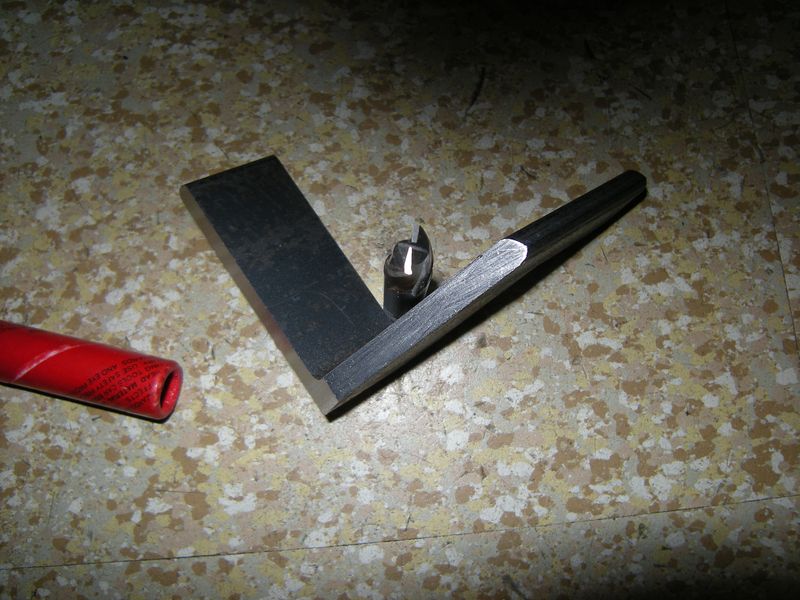

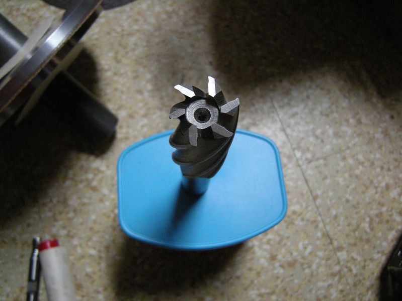

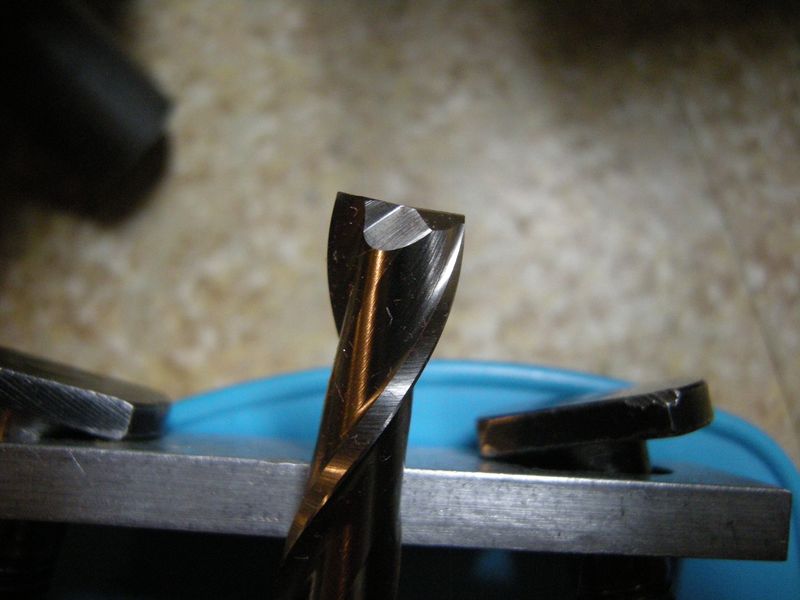

    A basic question as to why one should have as sharp cutting tools as is possible to produce, specifically end mills in this case.
    I pride myself on being able to do precision machine work in a home shop environment.
    With a new commercially produced brand name end mill with the equipment I have, I can produce work that is square, parallel, flat and straight to +- 0.0005" over 3-4 inches having an excellent surface finish but with an end mill that has been used and still relatively sharp, I can only manage 0.002" - 0.003" over the same distance with a less than fine surface finish as the end mill will no longer make those very fine finishing cuts due to the slight dulling of the cutting edge which causes the cutter to start to ride over the surface of the work rather than cleanly shearing it.
    Back to the topic at hand. What is end relief on an end mill? See the attached photo of an almost new 6 flute larger non center cutting end mill which has the end relief built in at the time of manufacture by the manufacturer. The end relief is the circular depression seen in the center of the end mill. It is the reason this type of end mill is called a non center cutting end mill as the cutting lips on the end mill do not extend all of the way to the center of the cutter. 99 % of the work I (we) do can use this type of end mill as it will mill a perfectly flat and straight surface. Center relief also makes it easier to sharpen the cutting lips on a surface grinder with the standard commercially available end mill sharpening fixtures and a straight grinding wheel when the cutter gets dull. But a some point, if we continue to sharpen the end of of the end mill, this center relief will disappear - then what?
    What a non center cutting end mill cannot do is plunge end mill unless we first driil a hole which is larger than the circular end relief built into the cutter (use this type of end mill to spot face for example or to counterbore. Actually, a dedicated and piloted spot facing or counterboring tool will do the job much better than an end mill but often the budget does not allow for this).
    Center cutting end mills have the cutting lips which extend all of the way to the center of the end mill and have no end relief. See the photo of a brand name nearly new two flute center cutting end mill. When new, they will plunge mill effectively. However, they are much more difficult to sharpen as one has to grind each cutting lip exactly to the center of the cutter and to be effective the cutting lips at the center have to meet as a fine line (for a two flute cutter) or as a point (with three or more flutes). Next to impossible to do in a home shop without having a dedicated tool and cutter grinder in good condition and having a ton of accessories.
    Next, we will delve into the cutting tooth geometry on an end mill which is really important.

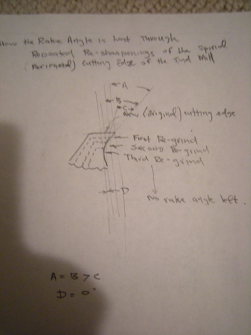

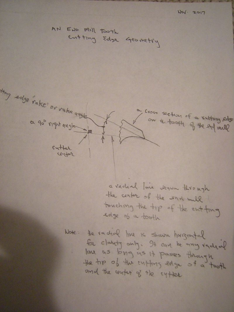

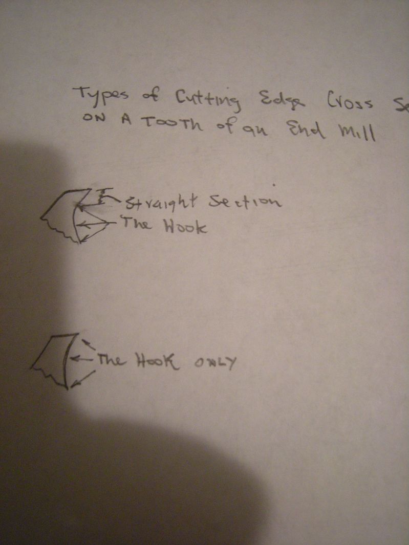

    To continue, take a new two flute end mill and examine a cutting tooth on the end of the end mill specifically the cutting edge corner of the end mill with an eye loupe under good lighting. You will notice that the outermost part of the cutting edge is likely straight followed closely by a shallow scallop or hollow ground section. This scallop or hollow ground section is called "the hook" and forms part of the cutting edge "rake".
    Rake is very important in an end mill. Now, take a look at my non professional photos of my non professional sketches (I did directly scan my sketches but the scan format was not recognized so I had to take some not so good photos of the sketches made).
    What is rake? See the first sketch (for some reason they came out reversed - the last photo is the first). It is a blown up sketch of a cross section of the cutting edge of a tooth of the end mill. Rake is the angle the tip of the cutting edge makes with a radial (imaginary) line drawn through the center of the end mill. Radial means radiating out from the center like the spokes on a bicycle tire. As sketched, the rake is positive as found on HSS end mills.
    See the second sketch. There are generally two types of cutting edge cross sections which can be found on positive rake HSS end mills. Type "A" is a composite (found on the vast majority of HSS end mills) in that it has a straight section followed by the hook. Type "B" is a true hook cutting edge. Why the difference and what are the advantages and disadvantages of each type of cutting edge profile?
    The type "A" cutting edge profile allows for the resharpening of an end mill without compromising the rake angle until repeated sharpening of the cutting edge "uses up" the straight section of the cutting edge and we move into the hook section. See the third sketch for what happens after repeated re-sharpenings of a Type "A" cutting edge end mill and how the rake sooner or later becomes compromised.
    The type "B" or a true hook cutting edge profile gives a free cutting and a fine surface finish but it is prone to dulling or edge breakdown as, due to its shape, the tip of the cutting edge is weaker as there is less metal backing up the cutting edge. Think of a bird of prey, both its curved beak and talons are a more extreme example of the efficiency of a hook cutting edge for slicing and slashing. Metal (steel) is much more difficult to slice than flesh so we have to modify the hook cutting edge on an end mill somewhat but the principle is the same - a hook is a very efficient cutting edge/profile.
    End mill manufacturers have to take many conflicting factors into account such as the cost and ease of manufacture, the life of the cutter, the ease of sharpening, the use (and abuse) to which the cutter will be put, the type of metal (or the many types of metal it will encounter) etc. etc. The type "A"cutting edge profile represents a practical compromise especially when the many different types of the more common materials such as are found in a home workshop need to be worked. A HSS end mill is certainly not the cutter of choice when very difficult or more exotic materials come into the picture.
    Even with all of the above, we have just barely scratched the surface. Stay tuned.
    If something is not clear, just ask. If I don't know, I will say so and somebody else can jump in.

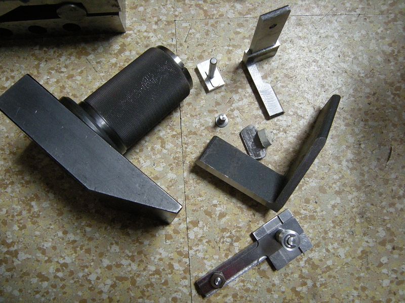

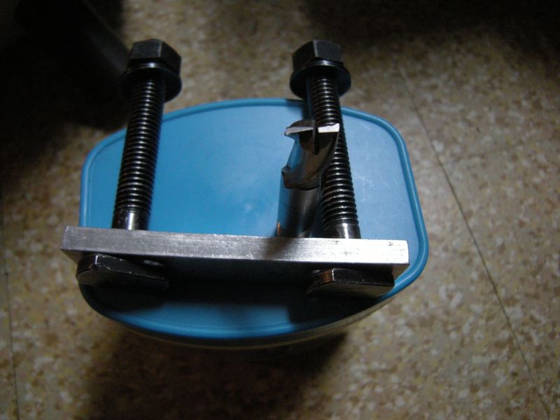

    As this site is all about homemade tools, I guess I should show some photos of the progress being made on the Washburn retractable guide mount. I am living on coffee and nerves as this project is starting to feel like a pyrrhic victory.
    Back to my tome.
    So what can be considered a minimum size an end mill can be reground to (on its diameter) before it really can't be sharpened any further?
    I am very fortunate to have a copy of the DoAll "End Milling Handbook" which includes a table showing this. For the sizes we normally encounter, they give the following: 1/8" (0.110"), 1/4" (0.210"), 3/8" (0.320"), 1/2"(0.425"), 5/8" (0.530"), 3/4" (0.635"), 1" (0.850") and for many other sizes as well. This is for a composite Type "A" cutting edge end mill tooth profile - all credit going to DoAll.
    There are literally boxes full of used end mills here which will outlast me as one can make bulk purchases of used end mils at very reasonable prices (less than $1 per piece) if one is prepared to hunt on places like Kijiji, Craigslist, ebay, etc. and be patient until the right deal comes along. So now with the above information and a micrometer, one can easily check the useful life left in any particular endmill. In industry, since time is money, and since the advent of carbide and the more exotic coated inserts, no one these days is taking the time (or keeps the equipment) to re-sharpen a HSS end mill so local machine shops are good places to look and make a deal as well since used HSS end mills are just thrown away.
    On my end mill grinding fixture, which is the well known American make, they quote the same relief angles as stated by Dale Derry for his offshore brand namely 5 degrees primary end relief, 30 degrees secondary end relief and 2 degrees center relief. I do have the instructions which come with this unit but they are very basic. They also make a fixture for 10 flute shell end mill cutters which is virtually identical to the one made for regular end mills.
    As Dale states, the relief angles built into all of these fixtures are very generic and don't always represent the ideal clearance angles for the range of end mill sizes which we use (typically 1/8" to 3/4"). For example, the commercial T&C grinding shop where I used to take all of my cutters for sharpening before they closed down, said to use 15 degree secondary end relief for the general type of work I do instead of 30 degrees as it leaves more metal behind the cutting edge which makes it stronger and I never encountered a problem having end mills with this smaller secondary relief.
    Having said that, the DoALL End Mill Handbook quotes vastly different relief angles (with the general rule being, the smaller the diameter of the cutting tool, the greater is the relief - it is exactly the same for drills, single point lathe tools cutting small diameter work, etc.). To quote some examples from the DoALL Handbook:

    HSM May/June 1988 - The Surface grinder (Part4)-347-setup-grind-lip-gauge-piece.jpgHSM May/June 1988 - The Surface grinder (Part4)-348-will-clear-.jpgHSM May/June 1988 - The Surface grinder (Part4)-349-after-grinding.jpgHSM May/June 1988 - The Surface grinder (Part4)-350-getting-closer.jpg

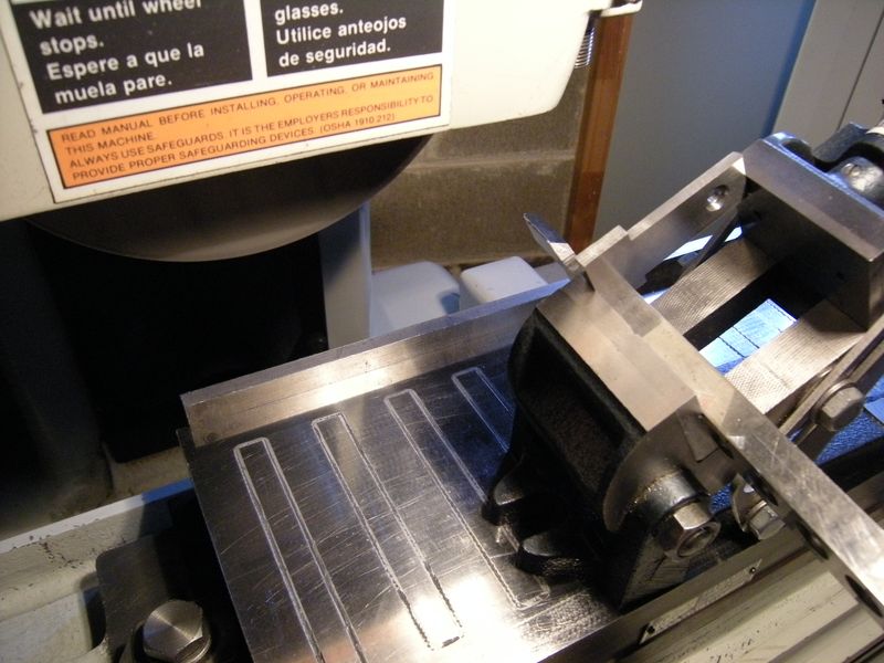

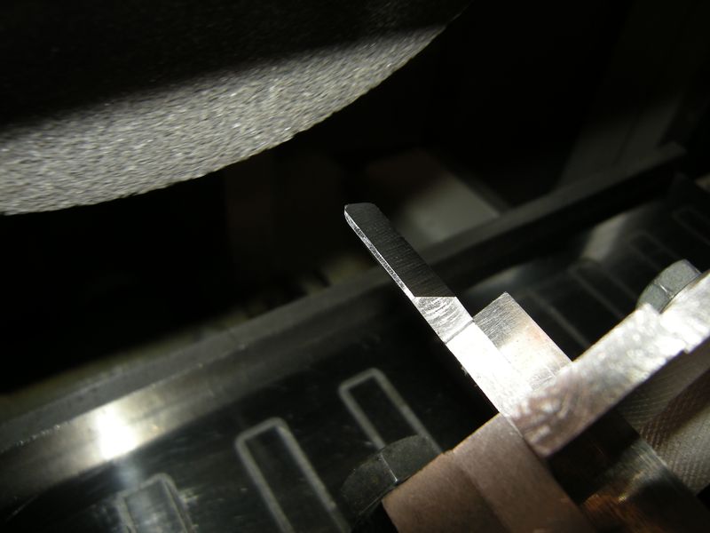

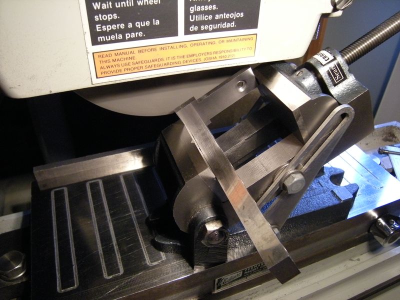

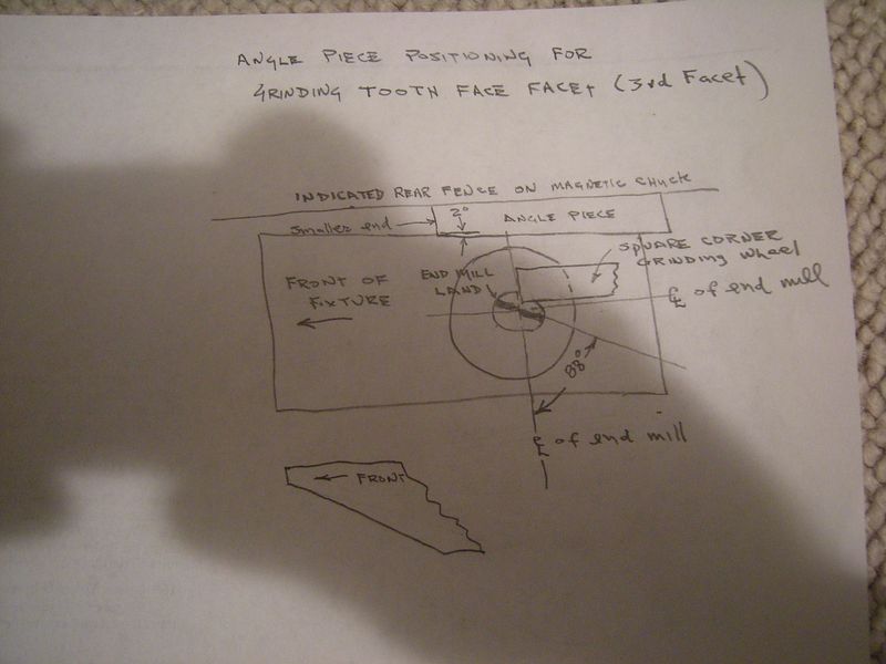

    Moving right along.

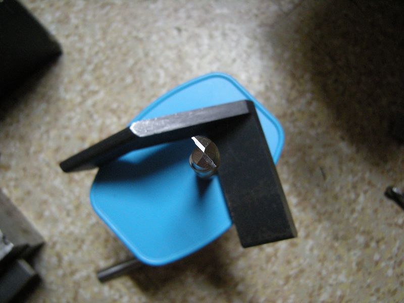

    Take a look at the included photo of the like new two flute center cutting end mill from a different angle which clearly shows the tooth face facet or what I call the third facet. You can see that the facet makes a square a corner cut from the center of the end mill but the grinding just misses the cutting edge of the tooth where it is scalloped and beyond to the cutting edge corner of the end mill.
    So why the third facet? Maybe the answer is obvious to all of you but just so that no stone is left unturned, one needs the third facet in this type of end mill as one has to remove all of the metal in front of the end mill teeth cutting edges so they are left clear to cut. At some point then, when sharpening the end of a two lipped end mill, one will also have to grind back the third facet in addition to the primary and secondary clearance facets on the cutting edges themselves.
    With a 90 degree corner on a straight wheel, the end mill cannot be indexed 90 degrees after grinding the primary and secondary clearance facets or it will also grind the opposite tooth cutting edge so it has to be indexed at something less than 90 degrees. I also use 88 degrees as the preferred angle to grind the third facet as per Dale's video but here is the problem. All of these end mill sharpening fixtures index 24 divisions and 24 divisions only (every 15 degrees) so one cannot have the desired 3rd facet indexing without resorting to some additional tricks. I also use a 2 degree angle piece but in my case I do not angle the end mill itself - I angle the entire fixture. I do it this way because the fixture which I have seems to need three hands to hold, position and then tighten the draw in cap which locks the 5C collet down into the body of the fixture. Included is another hand sketch showing all of the above.
    In order to work properly, the fixture must index positively. I found on mime that some indexing positions were definitely very "mushy" until it was discovered that the draw in in cap which draws the 5C collet down into the body of the fixture was running slightly eccentric on the collet threads and binding against body of the fixture. Slightly turning down the OD of the cap relieved the problem. It may not have been the fault of the fixture as the threads on the collet could have been mis-manufactured but I had the same problem with all of the collets. Just something to be aware of, the fixture has to index both freely and positively as one has to count the number of "clicks" as one is indexing and even then it is very easy to go one click too much or one click too few because you are doing it dozens of times.
    Solving the above problems still leaves the problem of determining where the exact center of the end mill is and that is where my modified method comes in.
    I noticed that Dale was using what looked to be a diamond wheel in his video. A straight diamond wheel comes with a square corner as manufactured and one does not have to true a diamond wheel as it should run dead true on the SG spindle as manufactured. Still, a resinoid diamond wheel needs to be dressed from time to time, an operation which was new to me until recently. (I don't know about plated or other types of diamond wheels).
    Magnification will also help locate center. I use magnification also but there is magnification and then there is true optics. My friend sharpens all of his end mills by hand and they cut but he has a vey fancy binocular microscope having a large depth of field, built in illumination, a variety of engraved line (?) reticules and a million and one other desirable features (I don't know optics so I can't say what the most desirable features are). Only problem is, you would pass out at the cost.
    HSM May/June 1988 - The Surface grinder (Part4)-353-sketch-setup-grinding-tooth-face-facet-third-facet-square-corner-str.jpg
    HSM May/June 1988 - The Surface grinder (Part4)-339-third-facet-new-two-flute-center-cutting-end-mill.jpg

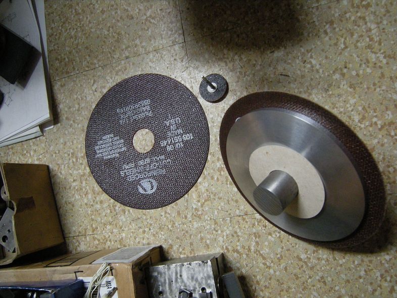

    If finding the exact center on a two flute end mill on the surface grinder is that difficult, is it possible to do without the center at all? Yes I believe it is. I call it the gashing operation.
    The gashing operation in its simplest form on a two flute end mill is the creation of a narrow transverse slot which removes all of the center material. See the attached photos of an end mill which has been gashed this way. Gashing an end mill allows one to advance the grinding wheel up to to and past center of the end mill without touching or harming the opposite tooth lip or cutting edge. The gashing operation itself is done with a narrow cutoff wheel.
    For the smallest end mills less than 1/4" diameter, I employ the little Dremel type cut off wheel shown in the photo. For end mills 1/4"-3/4" diameter, I use the reinforced commercially available 7" dia. cutoff wheels which are only 0.035" thick. For the larger wheels, I custom made the large diameter relieved aluminum washers which go on each side of the wheel so that only about 1/2" depth of the wheel is exposed.
    To make the gash, the cutoff wheel is positioned so that one edge of the cutoff wheel is positioned approximately over the center of the end mill by eye or by using a graduated scale with a stop as an aid and then the cutoff wheel is fed down in 0.005" depth increments while making a traverse pass with the table of the surface grinder. Use coolant with this operation. Only go as deep (0.020"-0.040") as is necessary to relieve the center of the end mill as you do not want to weaken the cutting end by making a deep cut. The end mill holding fixture is advanced three clicks so that the end mill flutes are set at a 45 degree angle to the cutoff wheel or one can go straight across with the end mill flutes set at 90 degrees.
    One still has to take care when grinding the primary land and secondary clearance angles on the end mill as the slots produced are very narrow.
    I just learned that two flute end mills are produced commercially to be center cutting so one must be aware that gashing an end mill this way makes it non center cutting.
    How does the above work? The proof of the pudding is in the eating as the expression goes. I will conclude next time showing an actual milling operation with this type of end mill and what the results are.
