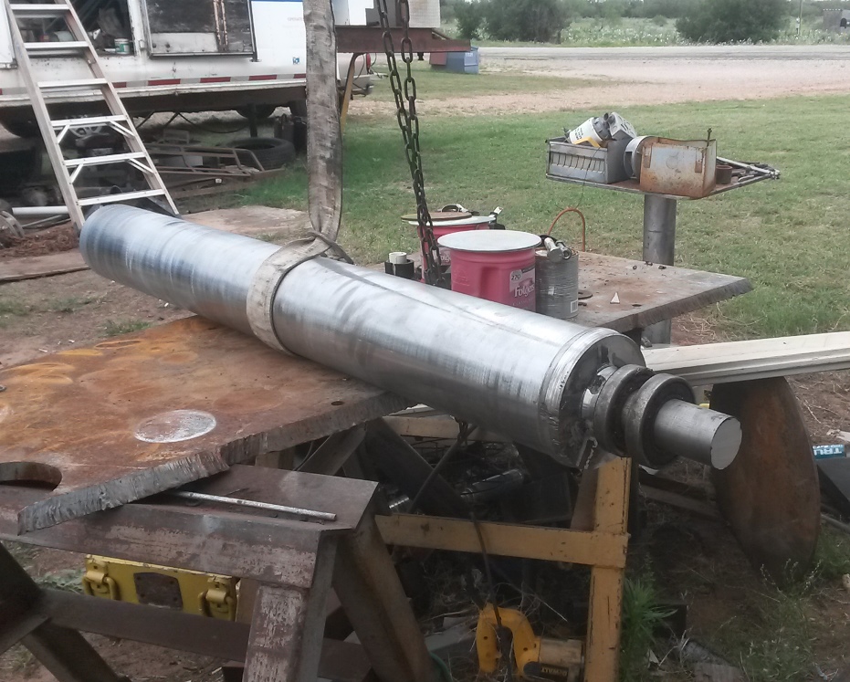

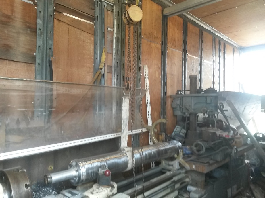

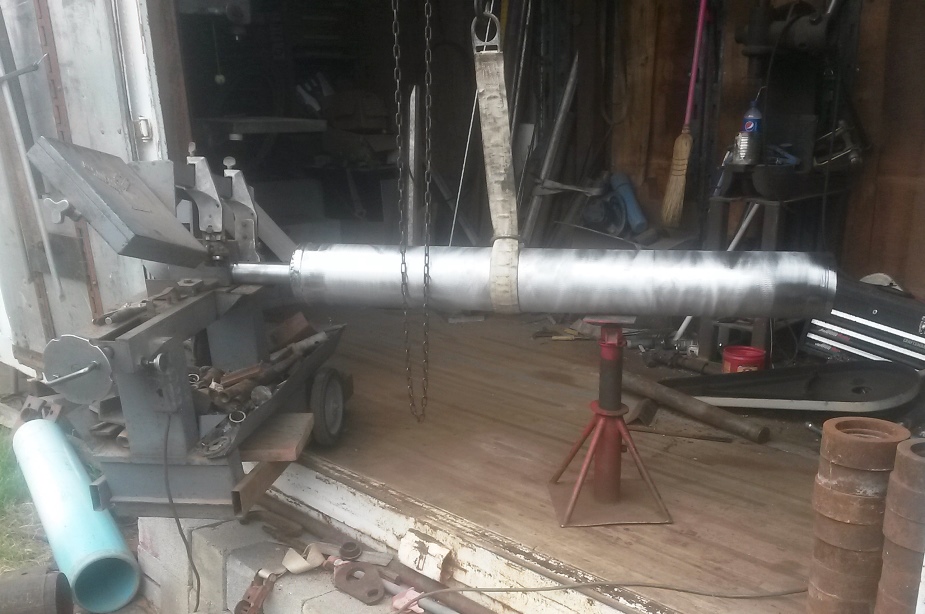

    In my van trailer shop I have most machines arranged #1 for the amount of space available #2 to enable me to utilize my jib cranes for lifting heavy or bulky objects.
    I can swing the crane out the door and hoist up something then swing it inside to the band saw or the lathe or the mill or even the drill press or the arbor press.
    My lathe is positioned in such a manor that I can open the door behind it for cross flow ventilation but more importantly I can go around to the outside and park a wheel barrow at the door and transfer the sometimes massive amount of chips from the lathe to the wheel barrow.
    the band saw as most know is mounted so that it swings from inside to outside the trailer allowing me to cut long materials or as in the case just recently to cut the stub off of the part I am working on from the blade side of the saw since due to its shape I could not chuck it in the vice the other way.
