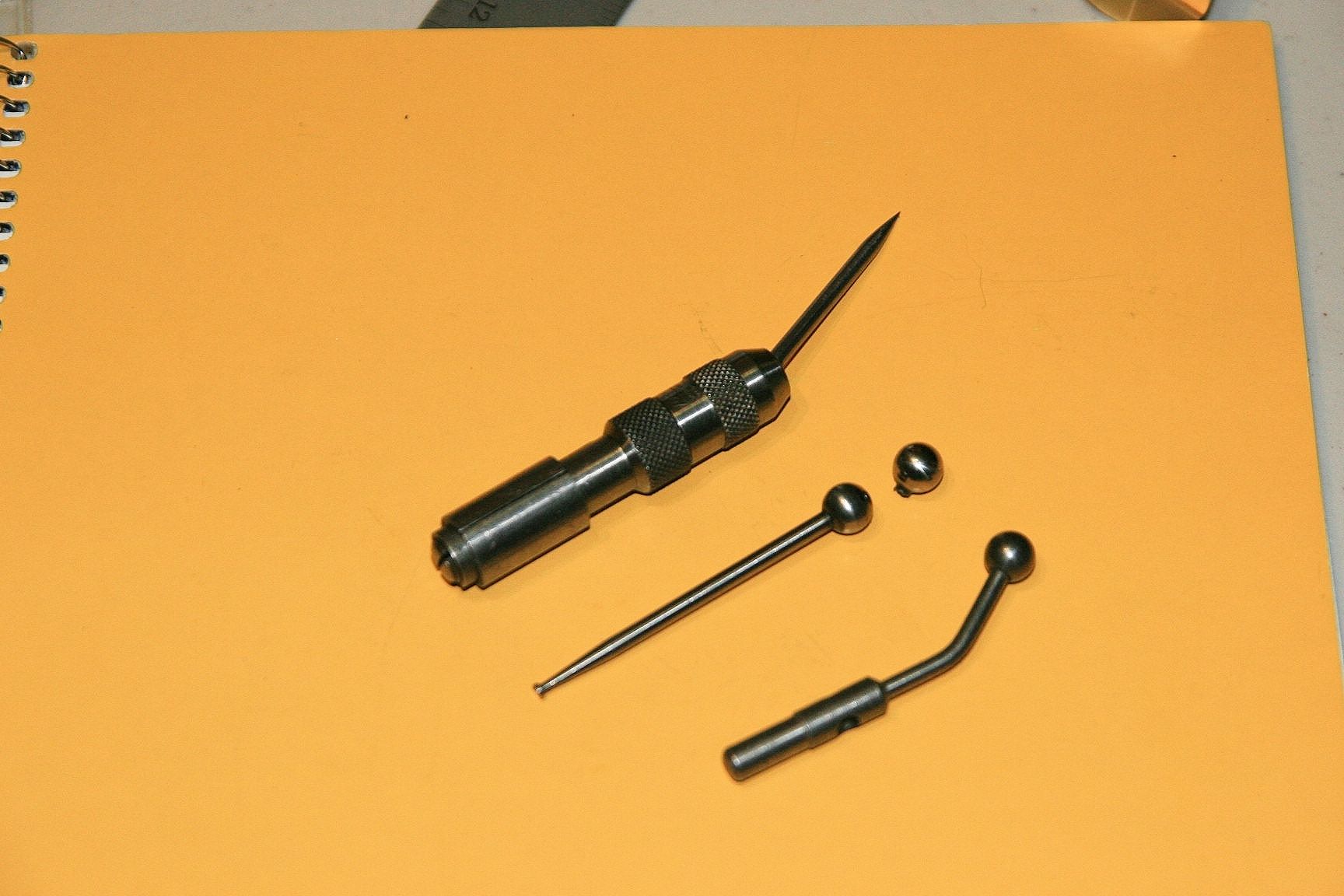

    How timely.. I had this tool in Dad's tool box and thought he called it a Wiggler and I knew it had something to do with finding center.
    I had always used the common edge finders that you find today with the cylinder on the working end. Now I have a tool designed to find a line!
    A few days ago while working on my clamps I actually used it to indicate an edge. Not sure if that was proper use but it worked.
    First find one edge by getting the needle centered with the fingers. I had the depth just deep enough to have the taper on the point touch the edge of the part. Touch the edge of the part by moving the mill table and zero the DTI. Moved it to the other edge without changing the height and found that edge. Divided by 2 and found the center. Worked great.
    Thanks for the demo Homeengineer.
    Now if I only knew how to use the stems with the ball on both ends.
    Here is a picture.
    Note the sleeve on the housing. The housing is cracked and it was repaired with the sleeve.
    Cheers, JR

    In the photo the bottom bent piece is a mount for your DTI clock to attach to, the two diameters are standard fitting diameter for the clamps. The middle one is an edge finder for getting in to small places, you need to run the spindle between 600/700rpm and as you bring it into contact with the edge of the work piece it will straighten until running true then as you just go over centre it will flick off. The spindle at this point is half the edge finder away from centre/edge of work piece. Move half the diameter of the finder (small diameter) and you have now set a datum for that edge. I am away this weekend but I will do you a video on using edge finders to clarify this explanation when I get back.
    The Home Engineer

    Excellent info thank you homeengineer. Now I have a new (old) tool to use.
    Have a great weekend.
