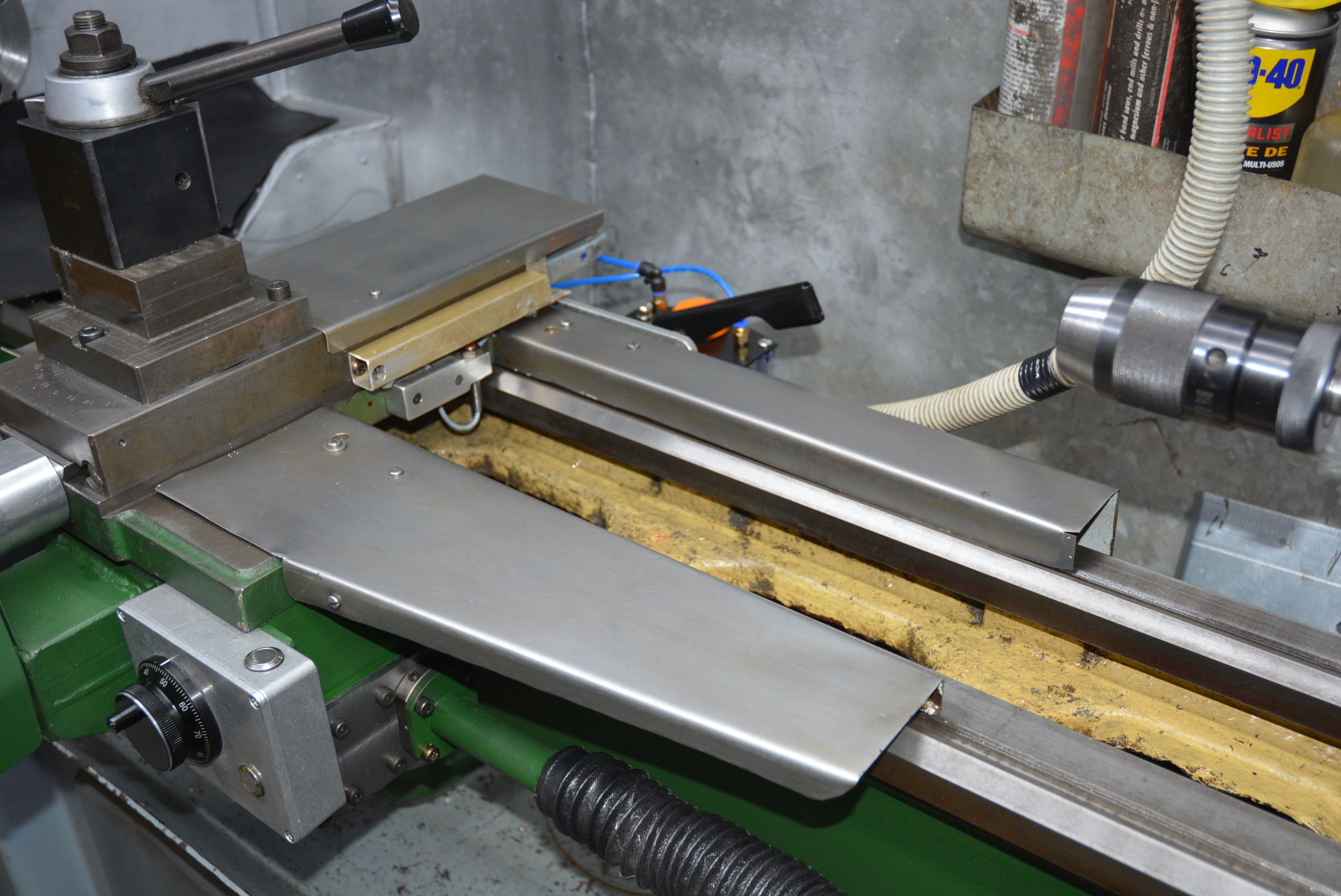

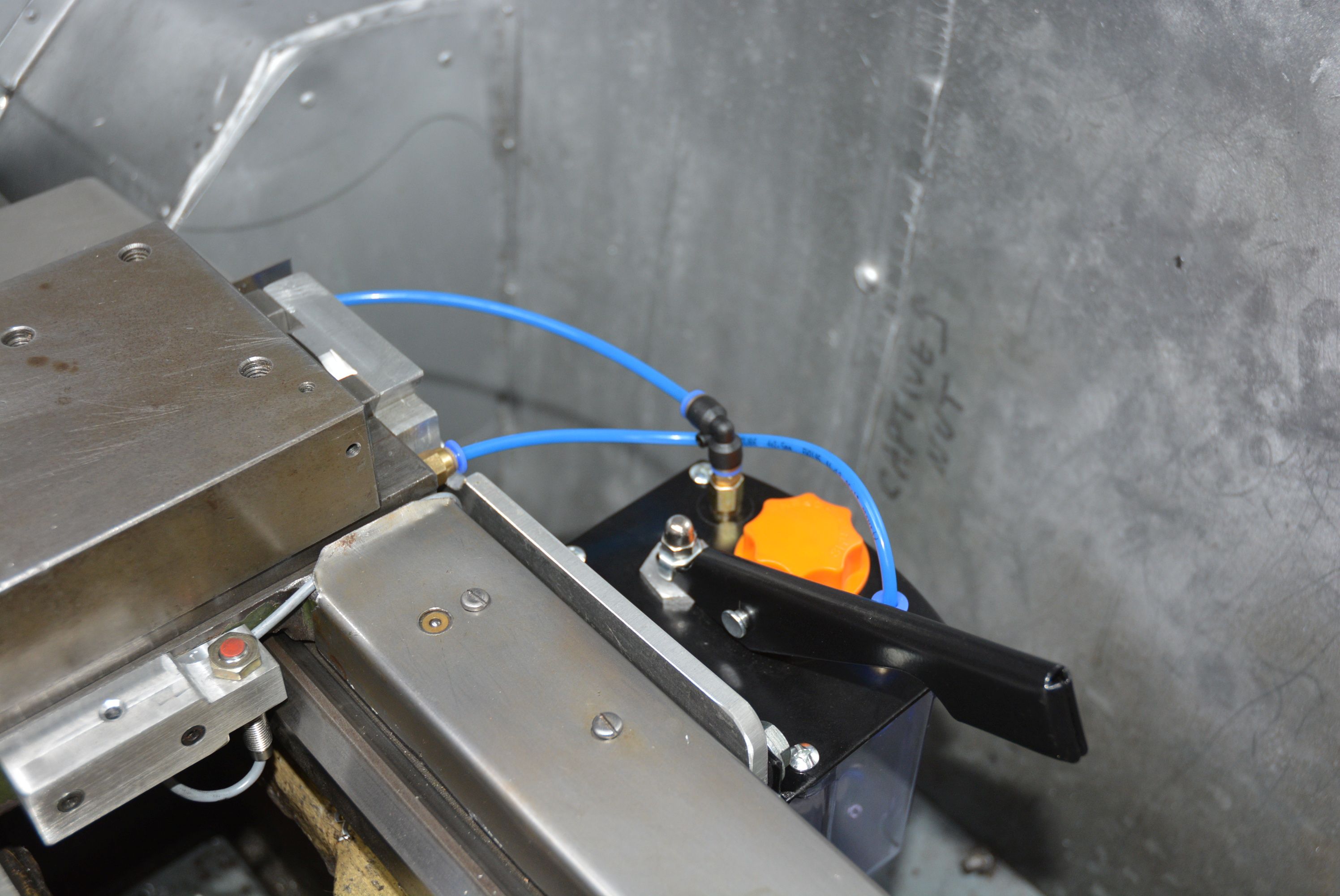

    I use those sensors on my lathe conversion.
    Here is a photo showing the X-axis sensor in place
    How To Use Inductive Proximity Sensors-ballscrew_113.jpg Click for full size.
    Here is the setup with the trigger bar in place, the gold coloured piece.
    For both X and Z axis I use one sensor on each axis with two triggers. Sometimes two sensors are used with one trigger. It depends what you want to do with the information. In my case I just wanted limit switches.
