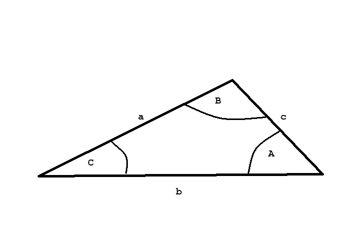

    Trigonometry is all about triangles - and not just right triangles. This discussion will show you how to solve plane triangles of any type.
    Any triangle has six items of information - three sides (a,b,c) and the angles opposite those sides (A,B,C). In order to solve a triangle you need to know three of those items AND AT LEAST ONE OF THEM MUST BE A SIDE. (Here "solve" means find all the unknown items.)

    There are five possible combinations for the three known items. [The triples in brackets show an example.]
    SAS - Two adjacent sides and the angle between them are known [a,C,b]
    SSA - Two sides and the angle opposite one of the sides is known [a,b,A]
    ASA - A side and the two angles to which it connects are known [B,a,C]
    AAS - Two angles and the side opposite one of the angles is known [A,B,a]
    SSS - All three sides are known [a,b,c]
    The technique for solving each of these possible combinations is shown; including an example using the knowns indicated in the bracketed triples above.
    SAS [a,C,b]
    Use the law of cosines to find the unknown side: c^2 = a^2 + b^2 - 2ab * cos (C)
    Use the law of sines to find one of the unknown angles: A = arcsin [a * sin(C) / c]
    Find the third angle: B = 180 - A - C
    SSA [a,b,A]
    Use the law of sines to find one of the unknown angles: B = arcsin [b * sin(A) / a]
    Find the third angle: C = 180 - A - B
    ASA [B,a,C]
    Find the third angle: A = 180 - B - C
    Use the law of sines to find the unknown sides: b = a * sin(B) / sin (A) and c = a * sin(C) / sin (A)
    AAS [A,B,a]
    SSS - [a,b,c]
    Use the law of cosines to find one of the angles: A = arccos[(b^2 + c^2 - a^2) / (2bc)]
    Use the law of sines to find one of the unknown angles: B = arcsin [b * sin(A) / a] [could also use law of cosines]
    After you've solved your triangle, check your work. The angles should add to 180 degrees and the sides should satisfy the law of sines.
