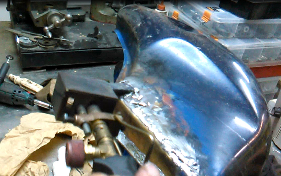

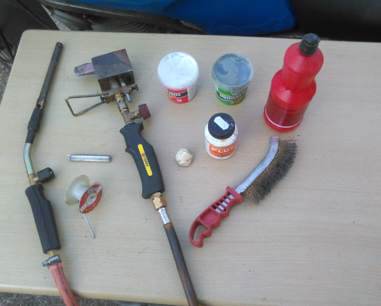

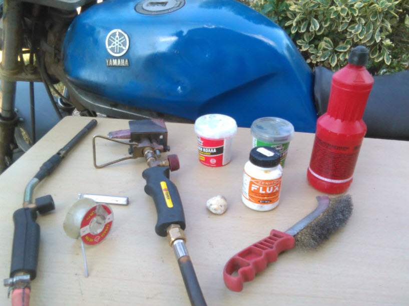

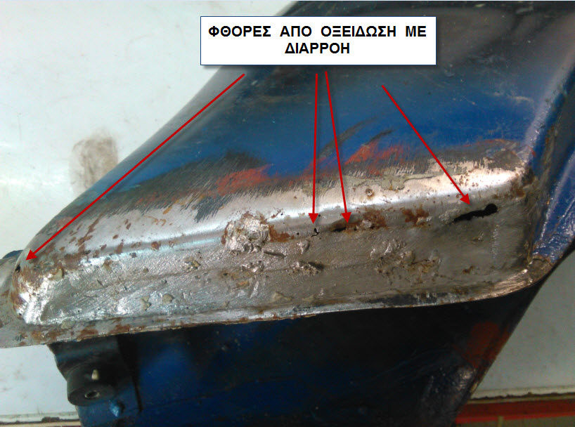

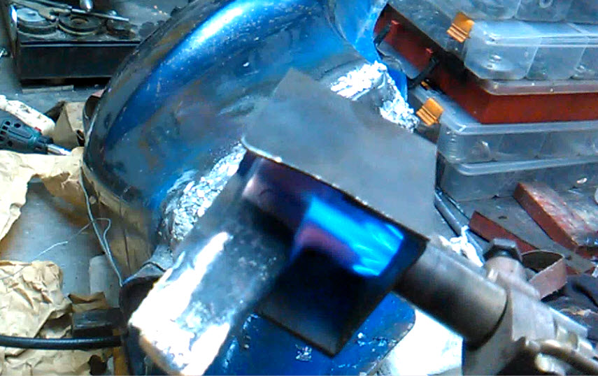

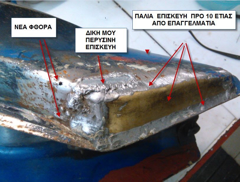

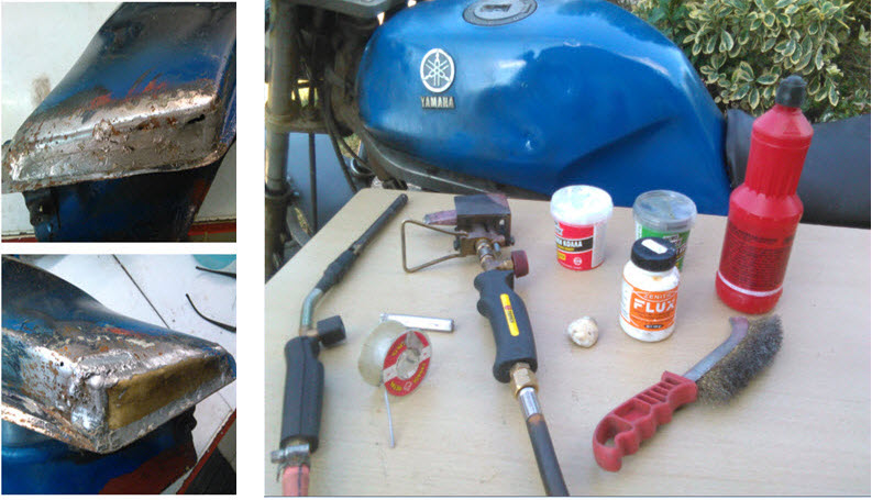

    Here you can learn how to repair an old fuel tank of your bike . If you follow the correct steps it is no so much dangerous. Of course if you can find a new one or a second hand in the market it' s better and more safe to buy it.
    YOU CAN WATCH THE REPAIR STEP BY STEP HERE:
    Attached Thumbnails Attached Thumbnails HOW TO REPAIR  YOUR  BIKE 'S OLD  FUEL  TANK-1.jpg   HOW TO REPAIR  YOUR  BIKE 'S OLD  FUEL  TANK-2.jpg   HOW TO REPAIR  YOUR  BIKE 'S OLD  FUEL  TANK-3.jpg   HOW TO REPAIR  YOUR  BIKE 'S OLD  FUEL  TANK-4.jpg   HOW TO REPAIR  YOUR  BIKE 'S OLD  FUEL  TANK-5.jpg
